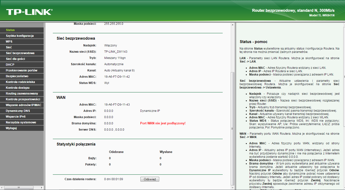

    suser222 wrote:
    The cable from the PoE adapter is to be plugged into the WAN socket on the router. To display the router's www panel, simply enter its IP address into the browser, if the computer gets an address, e.g. 192.168.1.100, then enter the gateway address (192.168.1.1).
    Yes, but I know how to get to the tplink configuration page.
    The main problem is that it can't detect my connected WAN port:
    TP LINK TL-WR841N: How to Connect Wi-Fi Router to Home Network with PoE and Twisted Pair Cables?
    I also tried:
    1. Change the address to another, e.g. 10.0.0.200
    2. Clone the MAC address
    jimasek wrote:
    Or you configure TP-Link as AP - link
    3. I tried to configure it as AccessPoint, switching ports to LAN and set it up correctly but still the same (from the link you provided).
    Now I have restored to factory settings again, I'm combining and I don't know how to bite it further. Any ideas yet?

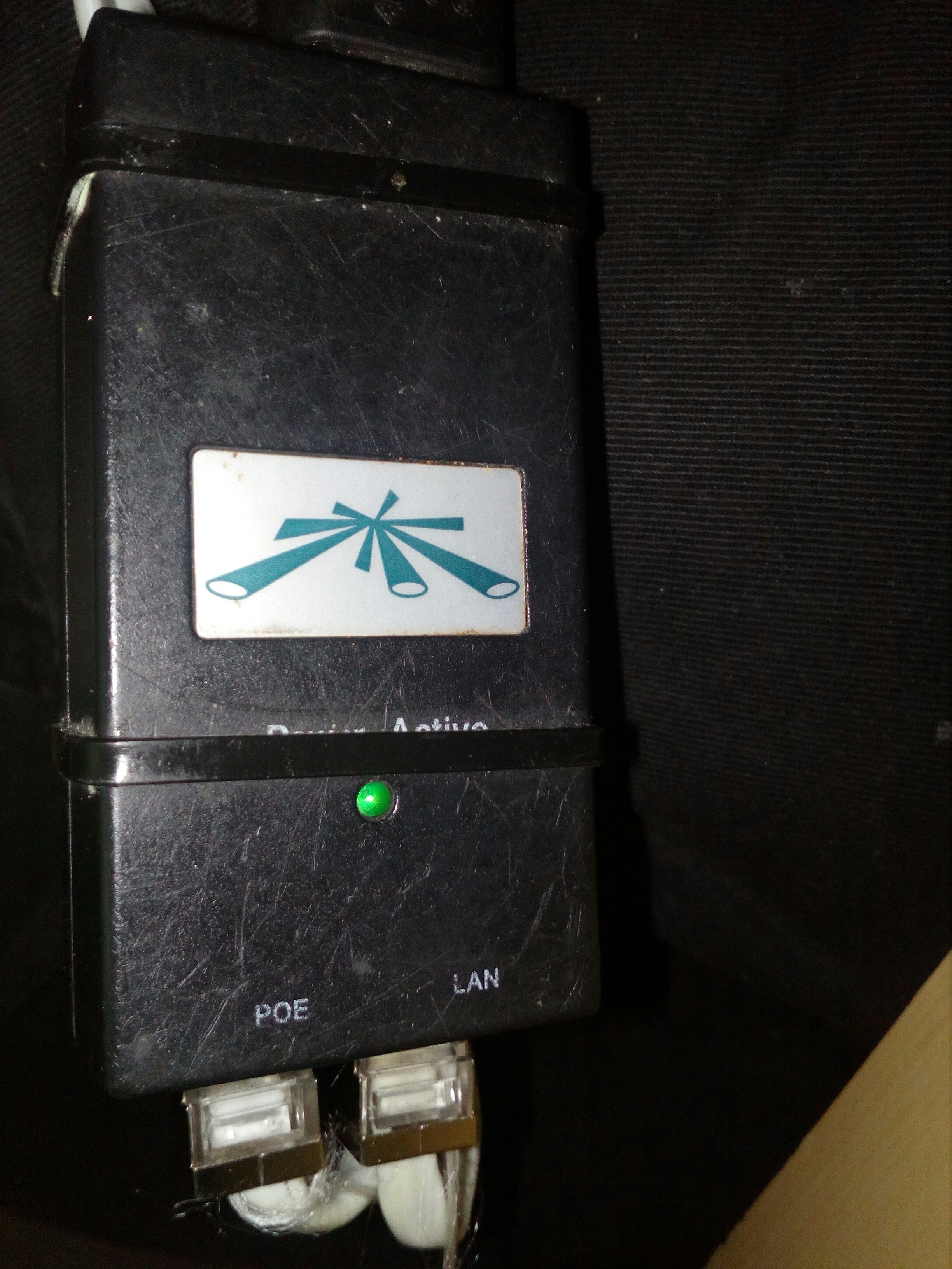

    Due to the erosion of the previously written thought, I did not notice that a few words remained from it. But that's not the point. Maybe again:
    The attachment contains a photo of the power supply. I leave the POE cable unchanged, plug the LAN adapter cable into the LAN1 port on the router as you write. The port indicator light is OFF. Why is this happening?

  • #16 16228015
    jimasek
    Posts: 35287
    Help: 3783
    Rate: 2681
    This LAN patchcord does not look original.
  • #17 16228055
    dawid4157
    Posts: 45
    It is not original, it is a paid cable. The same standard was maintained. After taking a photo, I plugged in 3 new cables to this port and it was different each time. So the cables are ok.
  • #18 16228061
    jimasek
    Posts: 35287
    Help: 3783
    Rate: 2681
    Show pictures of plugins on both sides. I would like to see the plugins from the pin page.
