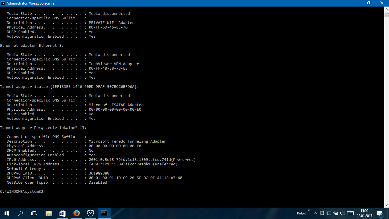

    MODECOM MC-WR11 equipment
    I am connected to the router with a laptop via twisted pair
    Added after 16 [minutes]:
    bogiebog wrote:
    IP in the computer on the car? show ipconfig / all
    I think so
    • MODECOM MC-WR11 Router Access Issue: Login Screen Not Displaying - Alternatives to Reset? Zrzut ekranu (26).png (95.15 KB) You must be logged in to download this attachment.
    • MODECOM MC-WR11 Router Access Issue: Login Screen Not Displaying - Alternatives to Reset? Zrzut ekranu (25).png (99.66 KB) You must be logged in to download this attachment.

  • #8 16234756
    kowalski6941
    Posts: 6
    I do not know if it is possible, but maybe my supplier has blocked access to this panel (nwm is there such a panel with such an option). I would like to do without a reset because I have never configured myself (but somehow I would have managed), and most importantly, I do not want to reset because as far as I know, my provider has a password that must be entered at some point in the configuration, and I do not know it and I don't know if they would give them to me if I applied, or if I would not have to call their "specialist" for it ...

  • #14 16237687
    kowalski6941
    Posts: 6
    Well, it turned out that the address of this router is 192.168.0.2 and that it is configured as a bridge, not as a gateway, which surprised me a bit, but it is important that I already have access (I asked them for help and they answered me). I am only interested in one thing, how then you can get this IP number yourself if I had to find it myself .....
