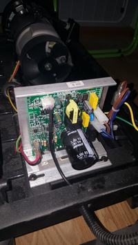

  • #5 16248389
    Gosc101
    Rate: 12
    Unfortunately, I don't know anything about it.
    This is what the engine looks like FitGym Treadmill: Error E7 Appears after 20-30 Minutes, Security Key Connected FitGym Treadmill: Error E7 Appears after 20-30 Minutes, Security Key Connected
  • #6 16248438
    bestler
    Posts: 5277
    Help: 254
    Rate: 895
    How can you be sure it's a key error? What is showing or showing before if you haven't inserted the key? Maybe his mechanism inside was broken?
