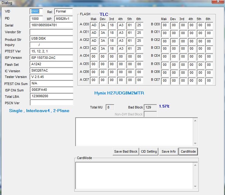

    Medion 64 GB flash drive.
    Entering Properties it shows 0 GB. Formatting with Windows (Vista): The system was unable to complete the formatting.
    Capacity unknown.
    Some windows blink after plugging in a USB flash drive.
    I have tried many programs:
    Rufus
    HP_USB
    TestDisk
    and others
    It seems to me that this is a controller matter, but I don't know how the program is operated: SMI MPT?
    I would ask for such a blatant instruction :roll:

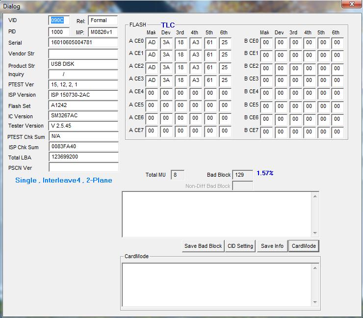

    Screenshot after entering the pendrive number 1 - the Dialog window has appeared:
    Pendrive Medion - controller - Pendrive Medion 64 GB: 0 GB and does not format

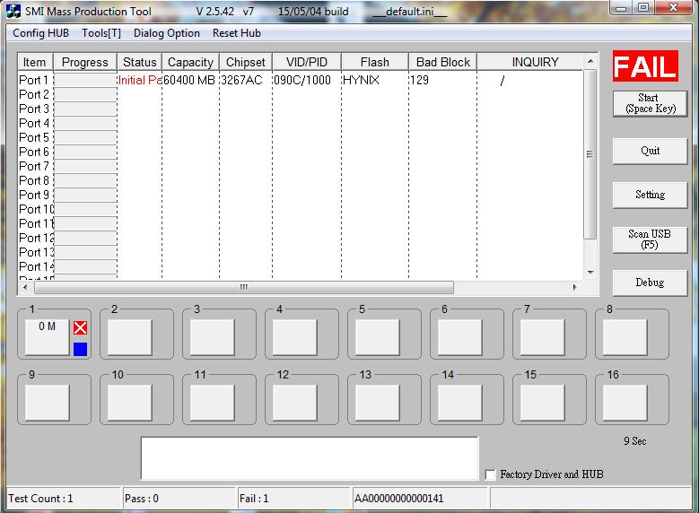

    Drop after entering Start:

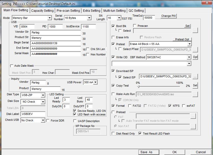

    Screenshot after entering Setting - after entering password 320:
    Here, for example, I found that UFD_3267AC cannot be selected with Select USP; the closest is UFD_3267AB

    Please provide some more information from Flash Drive Information Extractor before using the software from the attachment.

    Maybe he'll tell you what .BIN to use for this memory, already writing an email to him.

    Maybe I am wrong, but I would choose it "at first glance" -> SM3267ACISP-ISPHYTLC.BIN :idea:
    "I'm looking" for a tool -> ... v2.5.48 v9 P0414v1 :?:

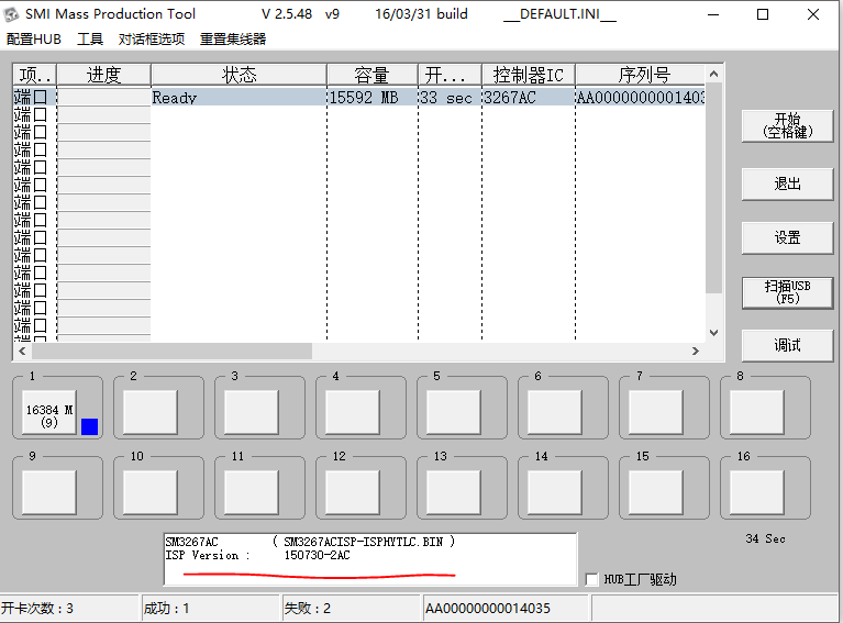

    That's how I am sm32Xtest repack p0414v1 , but the tool contained therein is in Chinese and all of this software was downloaded from an unreliable source :|

    pidar - you are great :shocked!: The revision / numbers appear to match :!:
    I don't know myself that much, but I think I could try :?:
    Just what should I do now :?: If it is possible, I would ask you to take it "by the hand" :oops: [/ b]

    No philosophy (despite the Chinese :D ), just run (see your first post).
    l maybe it will be possible to upload from the machine (without setting) "N0626V1" (FW).
    You have the link to download the file on pw.
    For "combiners" (self-proclaimed flash drive repairers), unfortunately, this tool will not be so readily available. :|
    Description of Conduct:
    1. Cleaning the registry with pendrives removed.
    2. Connecting only this flash drive and working with sm32Xtest_V48-9_CN .
    3. Current reading (FW).

    Despite the effort, I managed - thanks pidar - achieve a partial success ...
    I did:
    2. Connecting the pen drive to the sm32Xtest (...)
    It's already green OK, but I don't know what to do next?
    I didn't know what to enter everywhere:
    Maybe, for example, this is the lack of an ISO image? I don't know how to do it here? Maybe some suggestions?
    Data from the window Dialogue :

    Pidar - I confirm once again - you are GREAT :please:
    This time everything went smoothly :P

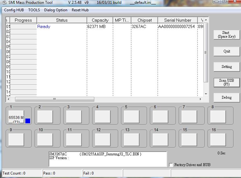

    I did as standard Scan USB :

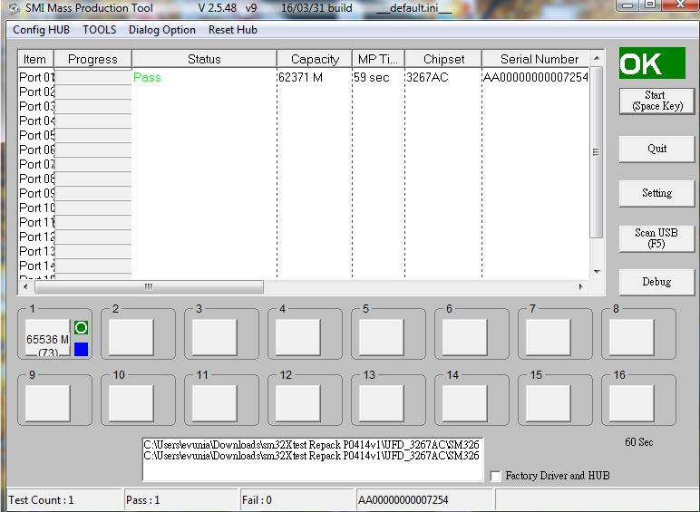

    Later Start . Here is a photo during testing:
    It can sometimes crash here. It is worth to delete it then Program and unpack it again.
    Looks like Program assigns a new pendrive number himself.
    Final effect:
    All in the end Program must be closed, because the pendrive cannot be uninstalled - it communicates that it is still in use.
    Then - just in case - I treated the flash drive Rufus and then formatted normally.
    It works for today and I think that if there was a problem with it, I know how to deal with it :ok:

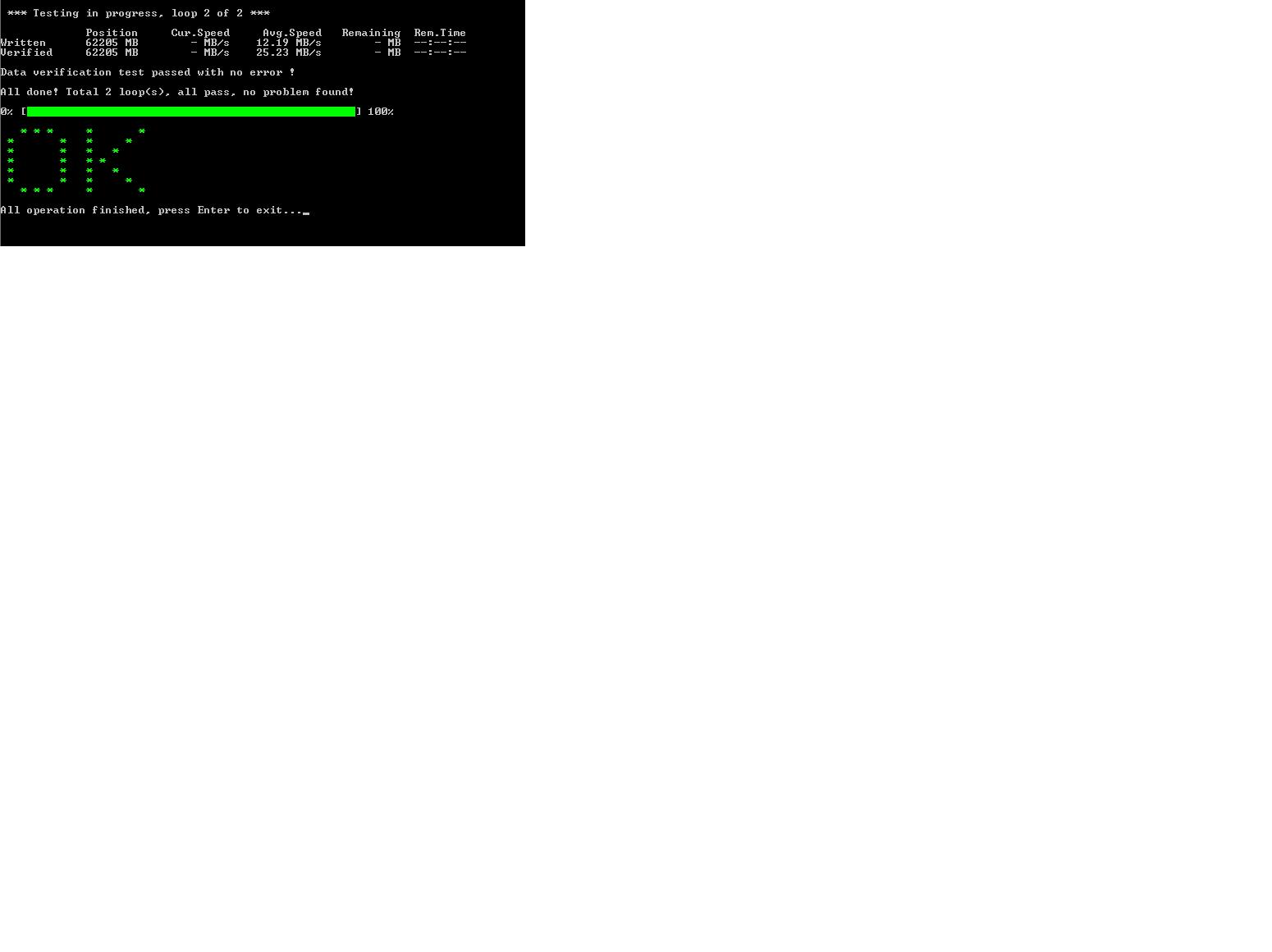

    Ufd Read Write TESTing tool v1.8
    As you can see complete success :roll:

    Chip F / W: ISP 150730-2AC
    MP: M0826V1
    MPTOOL Ver .: 2.05.45
    VID: 090C
    PID: 1000
    And this is how it is currently:
    MP: P0414V1
    MPTOOL Ver .: 2.05.48
    VID: 090C
    PID: 3267
    Thank you for the tests (that's what I donated points for), you can now close the topic.
