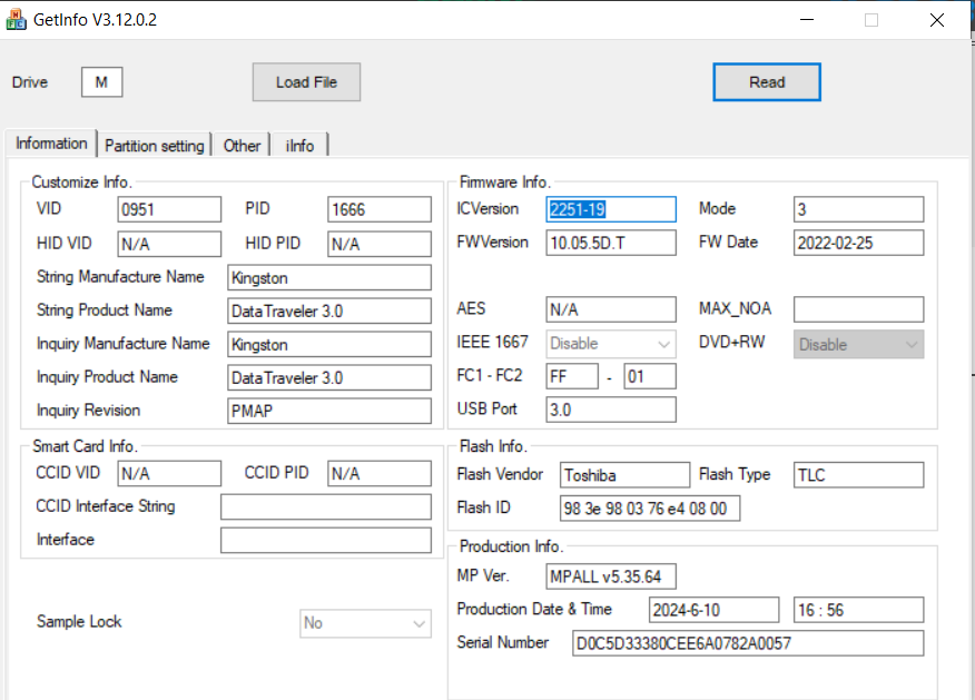

How can I recover a Ventoy-corrupted USB flash drive with a Phison PS2251-19 controller that is no longer visible as a normal disk and shows MBR 0?
If the pendrive is visible in Windows Disk Management, format it there first. If not, post screenshots from Phison GetInfo so the controller can be identified correctly [#20562892][#20564541] For PS2251-19, one reply points to ST-TOOL V3.81.12_2021.06.18_TW, which explicitly supports PS2251-19 [#21123396] Another reply says the Formatter Silicon Power v3.7.0.0 (PS2251) tool worked for a Kingston 13FE:5500 / Phison PS2251-19 drive [#21842778]

  • Error 1222 during AutoMP suggests possible hardware lock
    #12 21885468
    bakralshorbagy
    I have a very similar case but with a Kingston PS2251-19 (PS2319) stick using KIOXIA 983E980376E4 TLC 16K and F/W 10.05.5D 2022.2.25.
    My device is shown as RAW in Windows Disk Management and cannot be formatted in any way.
    In STTool 697 MOD with embedded MPALL v5.13.0C I see the stick (blue), but when I press AutoMP it reaches about 1% and then shows error 1222 (red status).
    Device data:
    VID: 0951
    PID: 1666
    Flash ID: 983E980376E4 - KIOXIA TLC 16K
    F/W: 10.05.5D 2022.2.25
    Right now I cannot paste a full ChipGenius or MPALL log (no PC access), but I can send it later if needed.
    Do you think my stick is still repairable with leaked 2022-2024 MP-packages, or is error 1222 a sign of hardware lock/final damage?
    Thank you!
