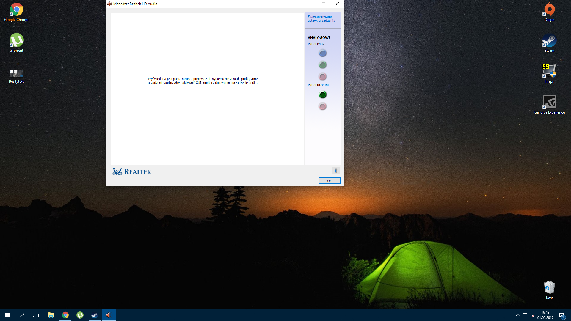

    Hello, I have the ASROCK H110M-HDV card, I have the latest realtek hd drivers installed. When I connect the headphones to the front panel, the computer detects them, but the headphones can not be selected in the device selection. But how to connect them to the back panel it works normally. Has anyone already met with this problem? How to deal with him? Thanks for the answers :) .
    (I upload a screenshot from the realtek software in the folder)

    Everything is normal. "Speakers" is generally the name of the analogue sound outputs.

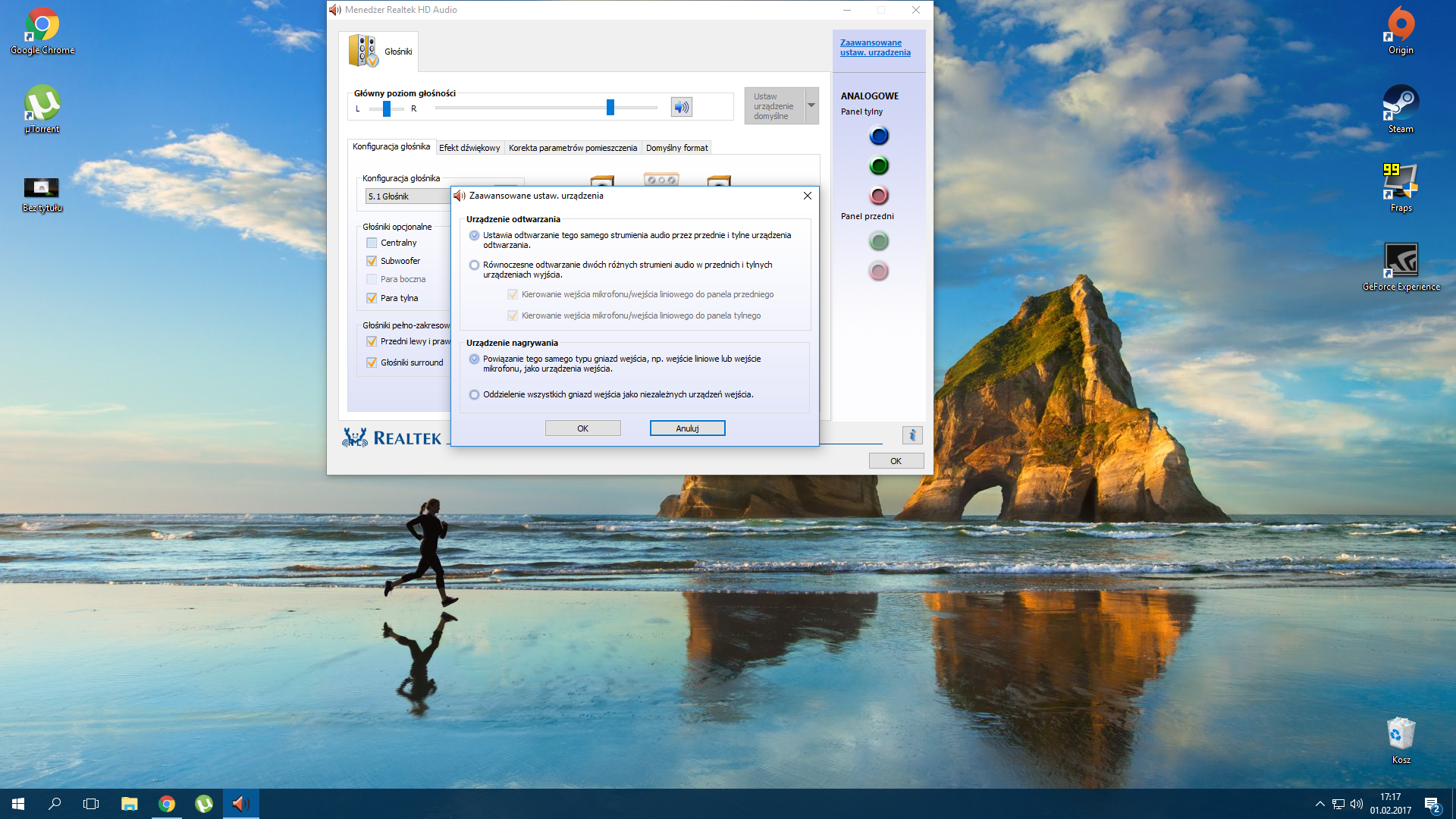

  • Realtek settings enable separate front and rear audio outputs
    #4 16244085
    sylweksylwina
    Posts: 13216
    Help: 1882
    Rate: 2355
    When you disconnect the headphones, the sound will switch to the speakers. You can check the options in the realteka panel under "advanced device settings" visible on the screen. There should be an option to send sound both to the front and back separately. But I do not know why you need to switch manually when it happens automatically? How do you connect headphones to the front output, there is no sound?

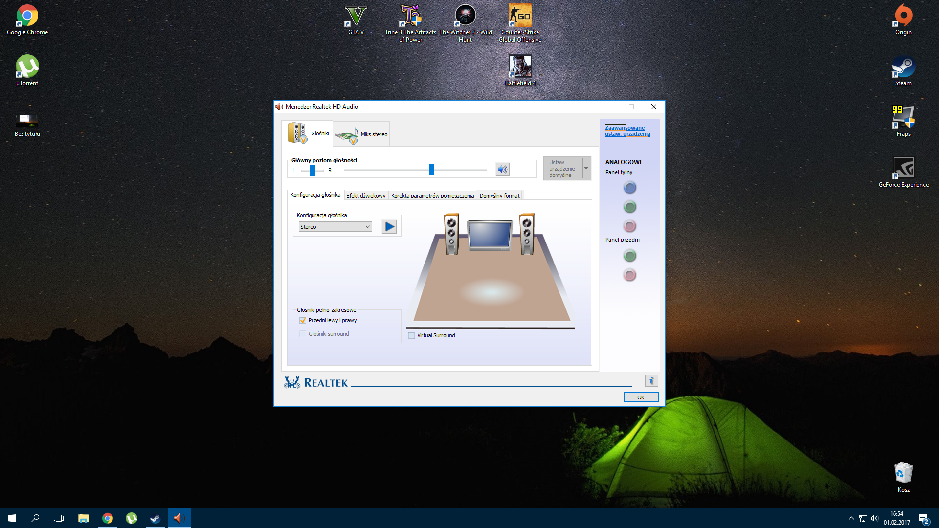

    Posts: 13
    I have the latest drivers.
    here adds a screen without realteka drivers are detected. only no 5.1 speakers and only stereo is available Does not detect headphones - The computer can not see the headphones connected i

    No headphones are working? How do you connect headphones with installed drivers, ask what device is connected? How do you click the left / right speakers then you hear a test sound?

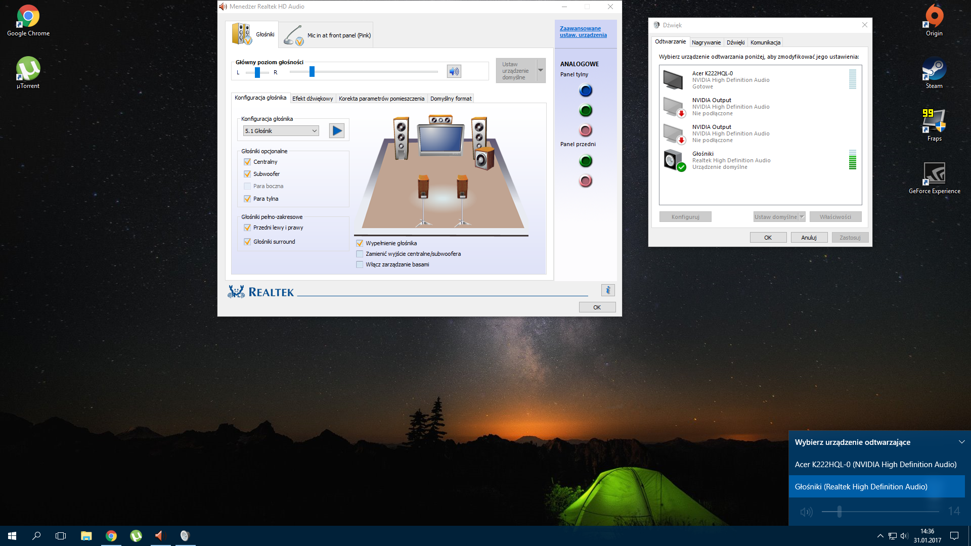

    michaltobi
    Posts: 13
    I do not hear; / I unplug the speakers and connect the listeners in front of me and this is how it looks: Does not detect headphones - The computer can not see the headphones connected i

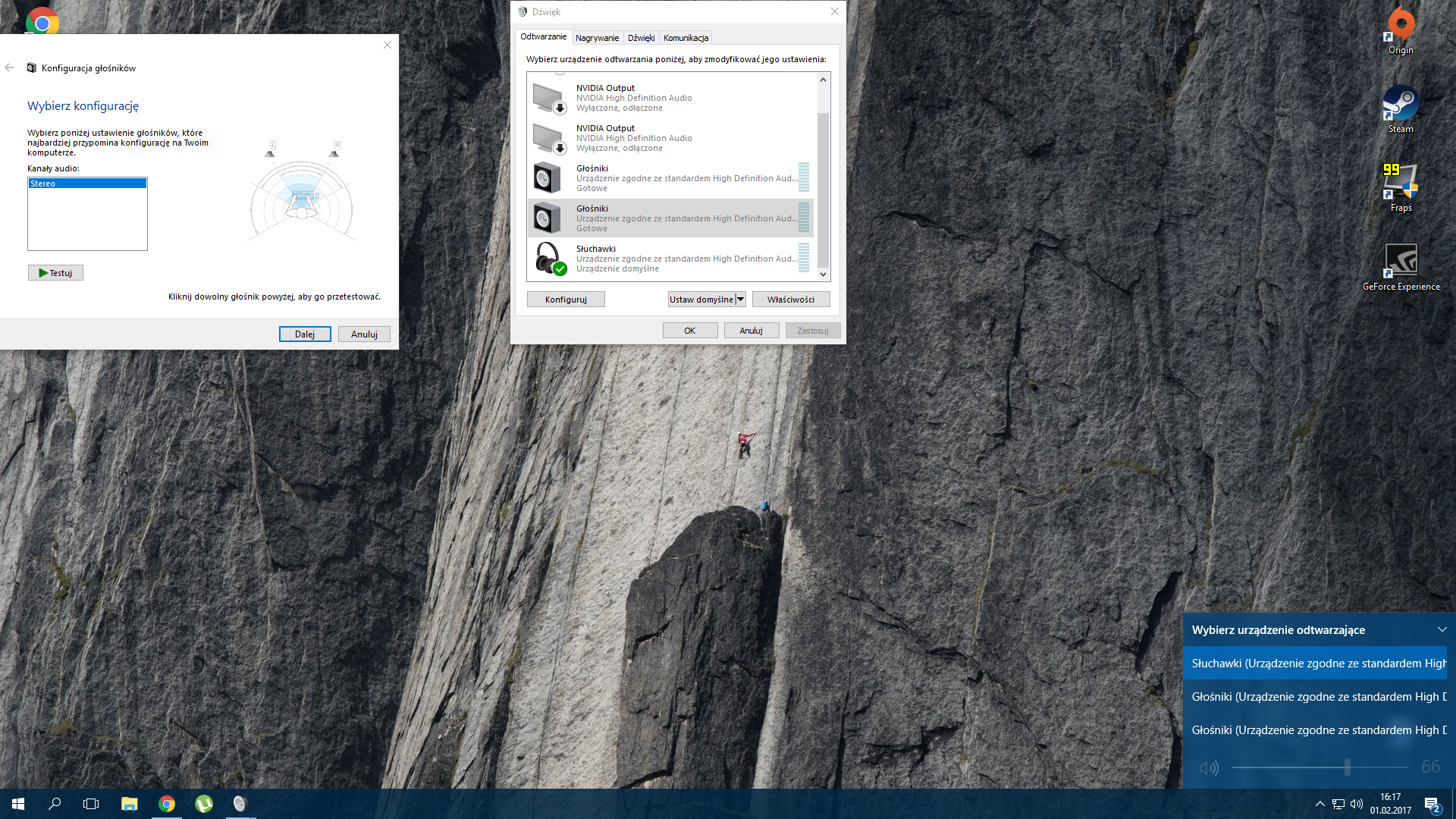

    Added after 5 [minutes]:
    And what's the most ridiculous thing I've removed all devices and look at this: Does not detect headphones - The computer can not see the headphones connected i

    Now you can see that something is wrong. What do you have selected in the advanced options (upper right corner of the window)? You can still remove these drivers and download them from the motherboard manufacturer.

    michaltobi
    Posts: 13

    Help: 1882
    Rate: 2355
    Install drivers from the Asrock website in that case.

    michaltobi
    Posts: 13
    And everything is playing :) . I installed the drivers from the ASROCKA website :D Thank you all for your help :)
