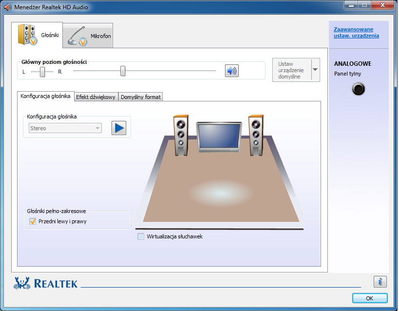

    Hello, as in the topic, the laptop does not detect the headphones. Win system 7. Only thing when I plug them in is "Relatek HD Audio Manager" displays "Socket has been connected".

    Enter the Realtek manager whose icon is probably next to the clock in the tray and show what you have set.

    I don't know if that's the point.

    I don't know if there should be a front panel.
  • #7 17739720
    sosarek
    Posts: 83875
    Help: 9320
    Rate: 15532
    No, it shouldn't be - now click Advanced Settings and show what you have there.

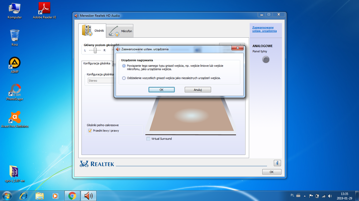

    Advanced settings in attachment.

  • #9 17739752
    sosarek
    Posts: 83875
    Help: 9320
    Rate: 15532
    Check the second option, plug in the headphones and show if anything has changed.

    Still the same.

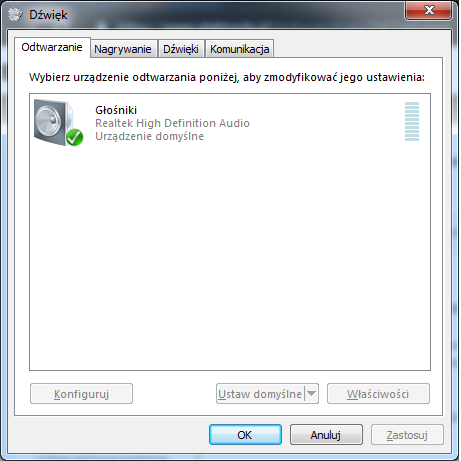

    Rate: 13
    Only speakers
    • Laptop Fails to Detect Headphones: Win 7, Realtek HD Audio Manager & Connection Issues Bez tytułu.png (48.38 KB) You must be logged in to download this attachment.

    so it is possible that it is the fault of the drivers?
    Added after 50 [minutes]:
    If so, this is the computer model: HP - 15-r104nw
