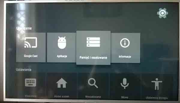

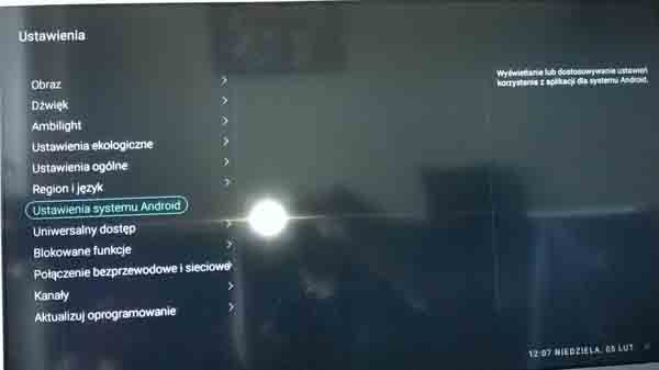

  • #3 16254306
    ramiko74
    Unfortunately, I can't find this track on my TV: 'Settings' -> 'Storage' and go to 'NAND FLASH'
    Philips 40PFH 6550 TV, Android version 5.1.1
    Below screen TV settings:
    Kodi 17.0 na Philips PFH 6550 - Błąd "Waiting for external storage"
    Android settings look like this:
    So where should I look for this path: 'Settings' -> 'Storage' and go to 'NAND FLASH'?
