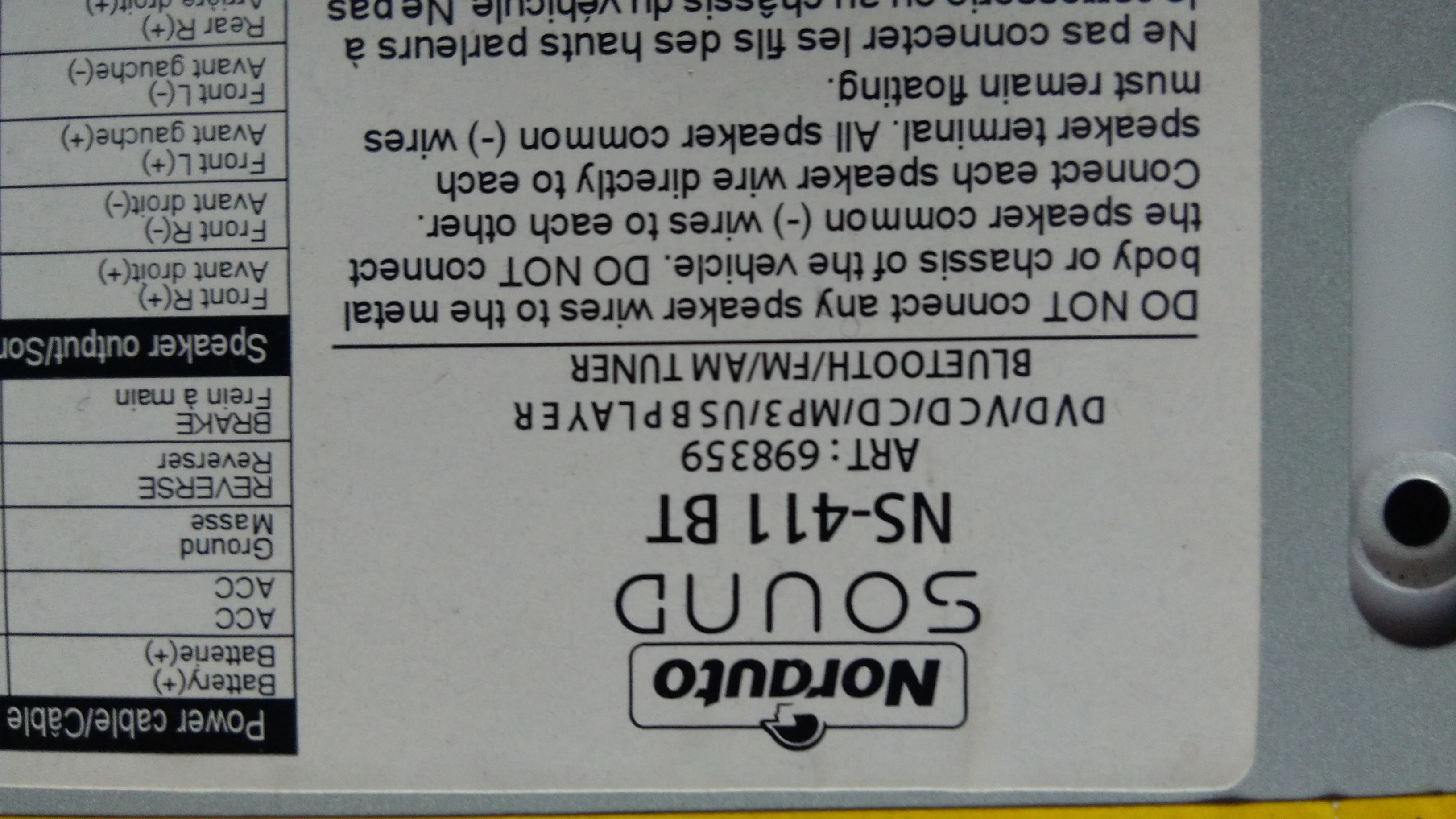

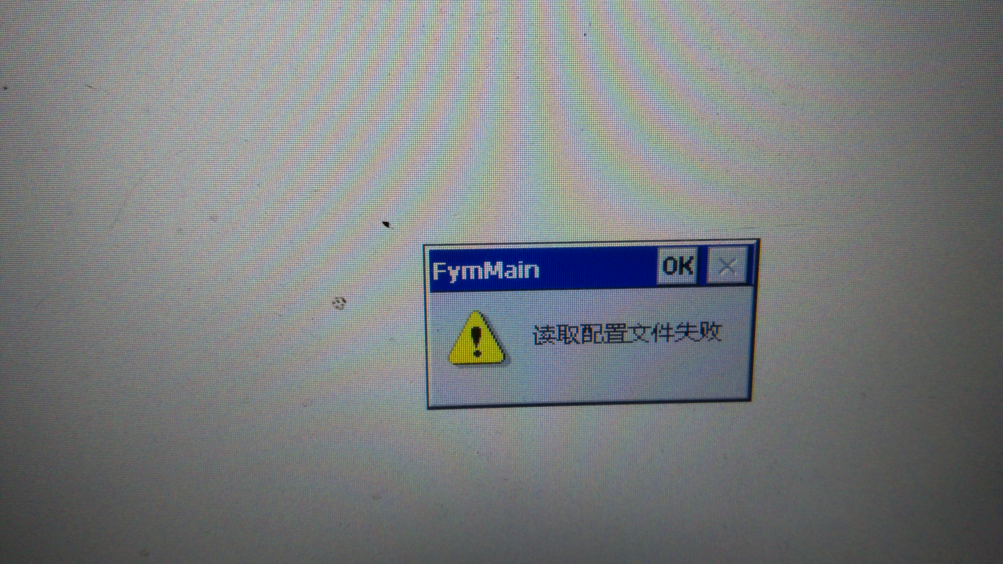

    I found the Norauto NS-411 BT car radio.
    Unfortunately, after starting and passing the touchscreen calibration, it shows the Fymmain error and below Chinese stamps.
    I know Norauto replaced them under warranty, but unfortunately I have no proof of purchase from him.
    Everything runs on Windows CE 6.0, it looks like a typical Chinese. Is it possible to update, fix, upload something alternative?
    Thanks!

    Hello, I have the same problem ... For a few days on. Photo maybe someone knows something

    I was able to reinstall in Norauto Piaseczno, a very nice gentleman will download the software from the website and uploaded it. The first time the radio was still under warranty, but you assured that there would be no problems after it. Unfortunately, it is blocked again, I will go there at the earliest opportunity,

    Apparently, in every Norauto branch, you can report soft, it is sent to the reporting branch, the uploading is inserting a pendrive and turning on the radio for a few minutes of update and it works, unfortunately after 3 months it blocked again ...

    Unfortunately, this is not a flash drive, but a ribbon that is attached inside the device, at the back of the display.
    The update is actually 10 minutes.

    Update on the Norauto website, uploading a new software. 10-15 minutes, free.
