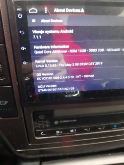

Hard Reset Process for Navivox 7 Android 7.1.1 Radio from China: Seeking Guidance
majkii2 275115 68
How can I hard reset a Navivox 7 Android 7.1.1 car radio after changing the screen resolution and losing the display?
Use a USB keyboard to try recovery mode: on some Chinese head units, hold Alt + Print Screen and press the i key repeatedly until the recovery menu appears, then use the arrow keys to select Clear data / Restore factory settings and confirm with Enter [#17601157] If that exact combination does not work, users reported that the shortcut varies between otherwise identical radios, so you may need to try keyboard combinations blindly until the reset menu appears [#18282110] For resolution-only damage, another working fix is to connect a USB mouse or an external monitor, regain access to Settings, and restore the previous/default resolution or disable the secondary-resolution simulation option [#19583880][#19859355] A 5-finger tap on the screen during boot has also triggered calibration or factory reset on some units, but it is not universal [#20752887][#21120109]

    Hello, I have a radio from china on the ondroid 7.1.1 navivox 7 I found something in the settings and changed my resolution and do not do anything on the display I wanted to make a hard reset but can not find a description anywhere for this model sea would help me?

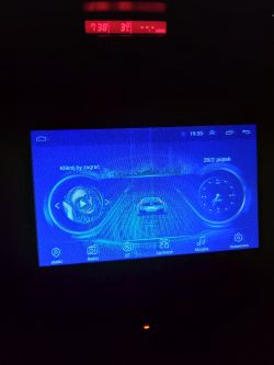

    josephx
    Rate: 22
    Hello. I also have an android touch radio And by stupidity I won a carnel which was a bad decision. Now I have only the logo after the start. My question is whether the keyboard goes back to its previous state ?

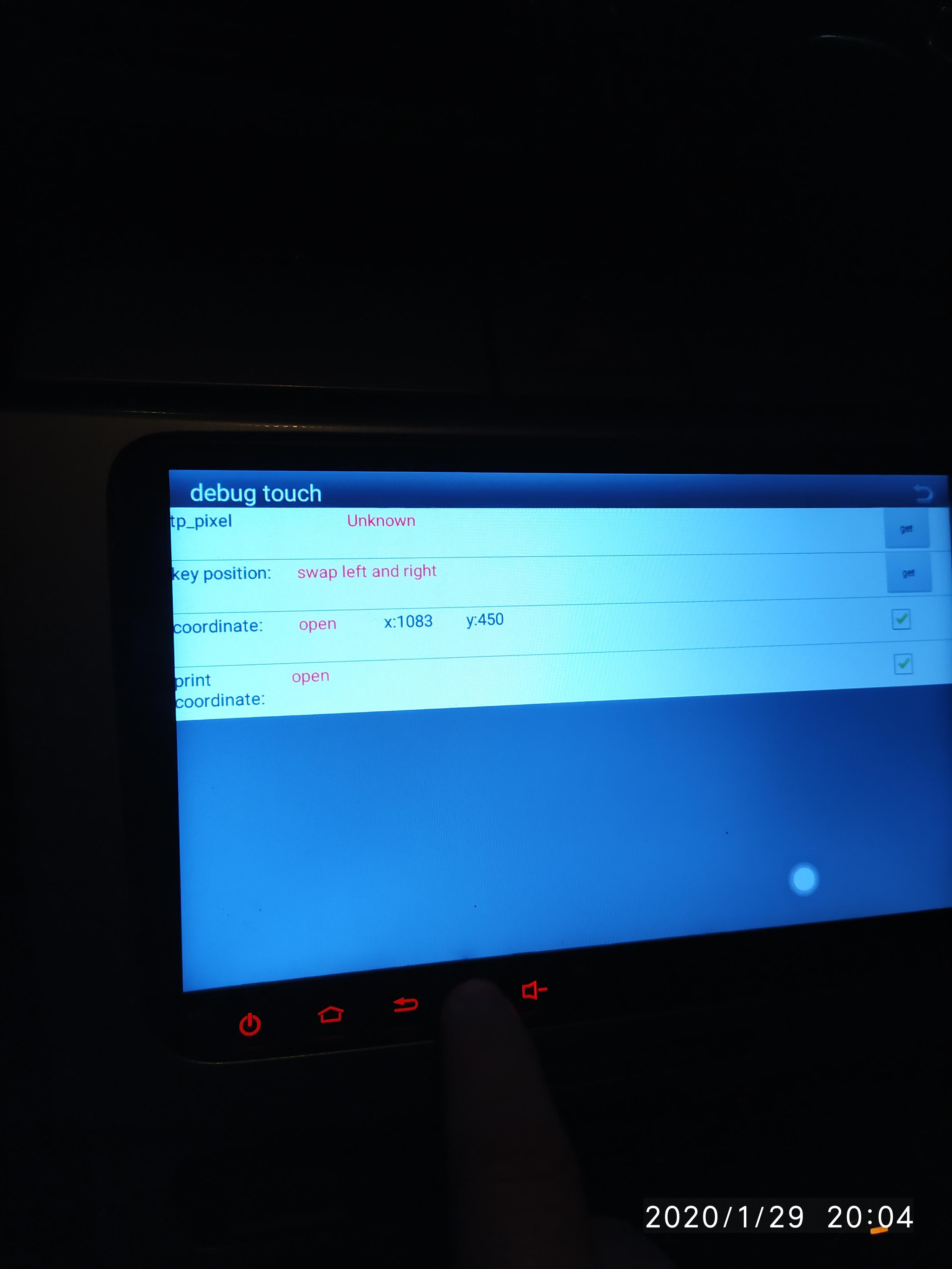

  • #15 18434918
    marcel_76
    Posts: 141
    Rate: 123
    This problem also caught me up.
    I installed the radio and started playing with the settings
    And zonk
    What s probably changed to the touch because when I touch in the right corner it is marked in the middle. Touch works all over the world.
    I am unable to enter any options. It stays hard reset but I can't do it.
    To the radio go two power cables permanently connected + one more plus to ACC after the ignition.
    How to trigger a hard reset ???

  • #17 18435568
    josephx
    Rate: 22
    And zonk
    Go into settings and there you have Key learning and teach android + screen calibration.

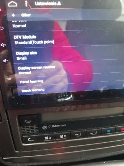

  • #18 18435943
    marcel_76
    Posts: 141
    Rate: 123
    I succeeded (With the help of a computer mouse and Son ;)
    Set the touch and it's almost perfect.
    Almost because navigation (touch) keys do not work, i.e. power, home, back, vol +, vol-
    Thanks to the floating point they have been replaced but I still have to figure out how to run them.
    There is a menu where you can check the exact position on the x and y axes of these keys but I don't see the menu where you can turn them on or off.
    Now when you touch them, nothing happens as if they were off screen.
    Someone something?

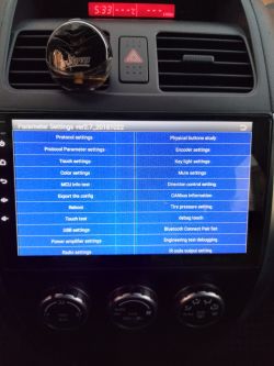

  • #20 18466762
    josephx
    Rate: 22
    Hard Reset Process for Navivox 7 Android 7.1.1 Radio from China: Seeking Guidance Hard Reset Process for Navivox 7 Android 7.1.1 Radio from China: Seeking Guidance Go into settings and click alternately, karnel version and os version until Factory Settings pops up and there you have Other, go there, scroll down, and you'll have. Panel learning and Touch learning. Assign side buttons and confirm. Hard Reset Process for Navivox 7 Android 7.1.1 Radio from China: Seeking Guidance
  • #21 18467613
    marcel_76
    Posts: 141
    Rate: 123
    I have another radio
    And I don't have the options you show

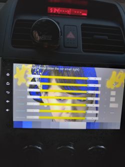

  • #22 18493612
    ziolo2008
    Posts: 16
    Rate: 11
    Welcome gentlemen
    I have a similar problem to yours, radio on Android with Allegro probably also made in china I do not know the model or name of the paper somewhere in the fall. The radio worked and suddenly only shows the Volkswagen logo and that was all I tried to reset push hold in different ways and does not enter the factory reset
    Below the link to the radio photo maybe one of you had such a problem and knows how to solve it thank you in advance
    I will add that when it gives a reverse gear it turns on the reversing camera and shows the image
    Regards

    marcel_76
    Posts: 141
    Rate: 123
    And after disconnecting the power does not start android again?
  • #24 18495484
    ziolo2008
    Posts: 16
    Rate: 11
    Do you mean unplugging the plug from the back of the radio? if I haven't done so, I will do it on Saturday and gather information
  • #25 18500084

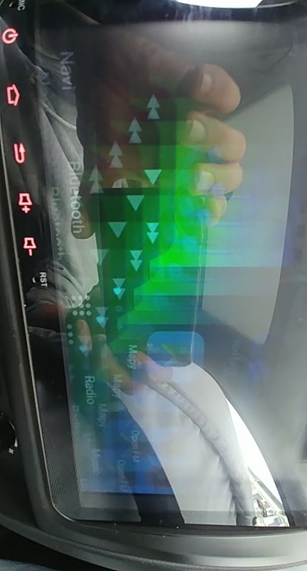

    KwiatekV9.
    Rate: 10
    Hi. I also played with resolution and overdid it. I couldn't do anything, the screen didn't respond to touch. I tried by uploading a new software, but there was an error in the 2nd picture. Evidently a bad file on a pendrive. Finally, I connected the keyboard and only because something could barely be seen changed to the previous resolution. Half a day of fight but successful. Best regards and good luck.
    Hard Reset Process for Navivox 7 Android 7.1.1 Radio from China: Seeking Guidance Hard Reset Process for Navivox 7 Android 7.1.1 Radio from China: Seeking Guidance Hard Reset Process for Navivox 7 Android 7.1.1 Radio from China: Seeking Guidance

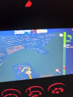

  • #28 18590207
    Adamglo1
    Gentlemen And I have a problem with the picture. The main screen is blue snowy. For example, an application like Janosik is ok. Every once in a while everything returns to normal and then it's still bad. Do you have any ideas? Hard Reset Process for Navivox 7 Android 7.1.1 Radio from China: Seeking Guidance Hard Reset Process for Navivox 7 Android 7.1.1 Radio from China: Seeking Guidance Hard Reset Process for Navivox 7 Android 7.1.1 Radio from China: Seeking Guidance Hard Reset Process for Navivox 7 Android 7.1.1 Radio from China: Seeking Guidance
  • #29 18590438
    gradek83
    Posts: 9118
    Help: 930
    Rate: 2105
    Unscrew the radio and detach the white ribbons connecting the TFT panel and check the pad contacts, plug back in and check. Alternatively, restore the factory settings in the info system by selecting "default settings"
  • #30 18590718
    Adamglo1
    I gave the service to check the contacts and said that rather everything is ok. I will try to restart the system. Is the "reboot" option a system cleaner?
    Oh I will add. That on the day it happened, the first signals were that the picture was hidden. I hit the screen lightly and it got fixed. And so it was several times. Then it was permanently left with blue snow.
