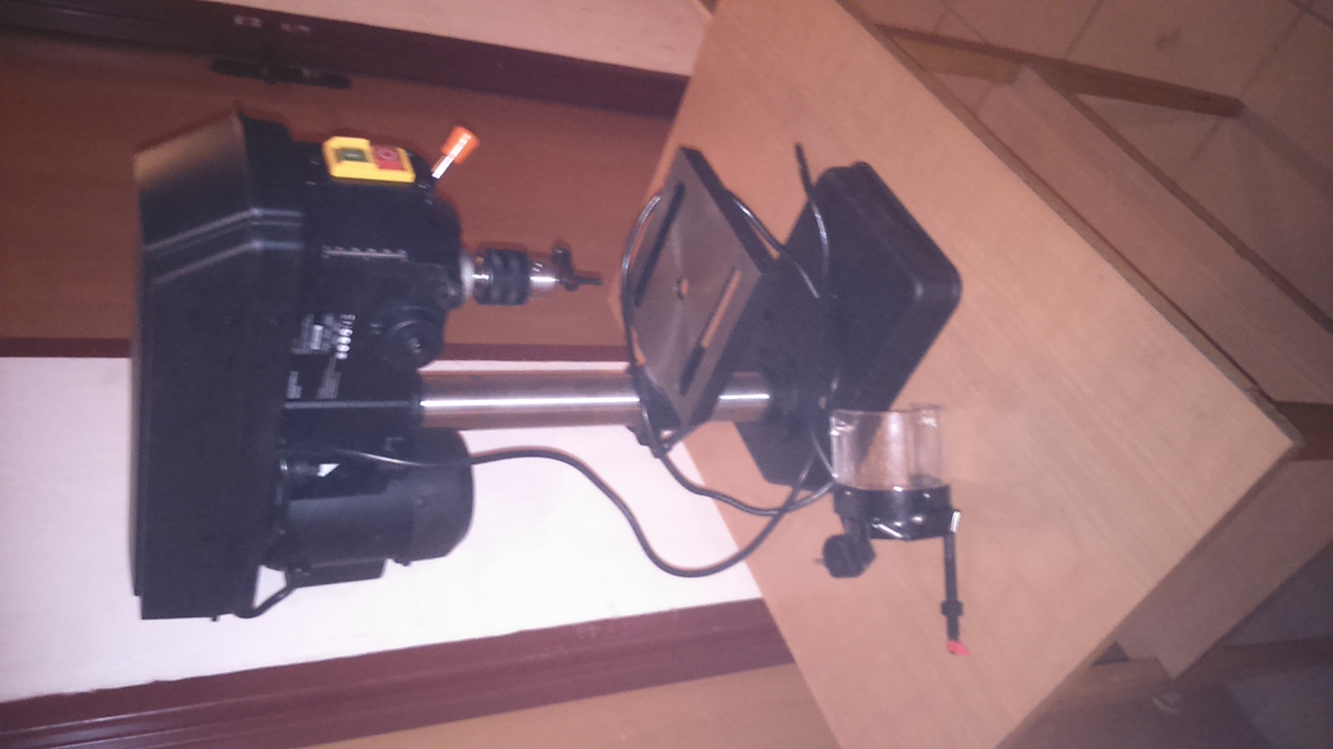

  • #7 16255759
    Parowy
    Level 22  
    Posts: 955
    Help: 55
    Rate: 227
    Available in castorama, for 200 PLN I will give back, I bought probably in September 2016, I would dig up an invoice.
    Bench Drill Recommendations for Amateur Use: Lidl Promotion & PLN 300-400 Budget Options
    Power 350 W, max. 13 mm drill bits.
    I tried to drill a piece of flat steel (I do not know the grade) with a 10mm HSS drill - hmm, this is not industrial equipment, engine power may be enough but the construction is not stiff enough, so I switched to ZX7016 (popular Zośka). On the other hand, no one has to drill a 10mm hole in one go.
    For amateur drilling in wood, soft metals, steel (for several passes), it certainly will suit. Accuracy up to about 0.5 mm can be achieved.
