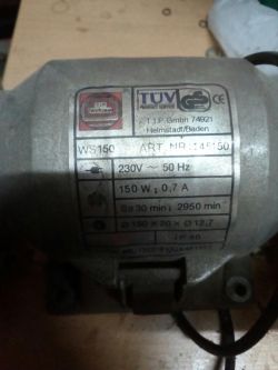

    Sly75
    Posts: 8
    And does anyone know and can write something about:
    TIP WS 150 GRINDER
    German 150W, I think

    Rate: 573
    I myself was looking for a fairly decent grinder and on many forums I found the opinion that below 350W it is not a grinder. In general, they praised old Polish grinders, large, solid with a solid axis (there is no bending like in Chinese). That's why these old grinders are still included.
  • #29 18324215
    Sly75
    Posts: 8
    This TIP grinder is kind of old and German but I'm just worried about its 150W power. Is that enough
  • #30 18324298
    bizon_126
    Posts: 2206
    Help: 108
    Rate: 566
    You buy an old you change 2 bearings and ew switch and peace of mind for years I did it
