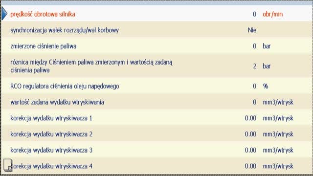

    I have a problem. Well, I have a car as in the subject, EGR and DPF have been turned off in the controller (EGR not blocked, DPF physically removed).
    The problem is that at idle heels gray / blue - the smell of exhaust fumes is pungent, after standing at idle, when I chase it away, it smokes for a while more intensively and then while smoking is invisible ... (video 1 - shows the intensity of smoking) .
    In the morning when it is cold, he has to turn for a while before he starts (Video 3 - but he was not after an overnight stop)
    Video 1 -
    Video 2 (engine idling and load parameters) -
    Video 3 -
    [Film: 18c528606f] https://filmy.elektroda.pl/50_1486371988.mp4 [/ film: 18c528606f]
    Additional information:
    - I started to add 2T oil to the fuel because, when I changed the filter, I noticed swarf,
    - Head gasket ok because I checked with a tester,
    - Permanent error: Charging solenoid valve: short circuit plus to ground (charging done for a short time), I suspect the valve because it is as if exploded ... but how can you physically check the + 12V valve? for example, disconnect from EGR and translate, and uplifts from negative pressure to clog ...?
    - Permanent error: Instrument cluster - Oil temperature info, the received value is incorrect (here I don't know what to do)
    - Can you see that the recirculation solenoid valve ratio is changing despite the EGR switch off in video 2 - is this correct?
    - oil in the intake piping (turbocharger or pneumothorax)?
    Is it possible to judge from the above data that it is the fault of the injectors?
    I will be very grateful for all the information, comments and guidance,
    greetings.

    If it burns heavily, check the glow plugs and see how quickly the pump builds up pressure in the tank. If there are filings in the system, unfortunately, give the injections to clean because the leaky overflow in the injection pump cannot build pressure. Two overflow test when firing it will be all known.

    I checked points from 3-5 as KotBury2 advised and there is no improvement. Heaps of smoke next. The external diagnoscope shows that the injector no. 1 all the time there is a large minus correction (E.g. today with a given injection rate of 6mm3 / injection, correction on injection No. 1 was -1.92 mm3 / injection. And the next injections had corrections on +, i.e. Injection No. 2: 0 , 04, No. 3: 1.22, No. 4: 0.59). My guess is that since injection no. 1 has a problem (clogged or the cylinder is not compressed) the other ones are watered to even out the work, and so can kicking occur?
