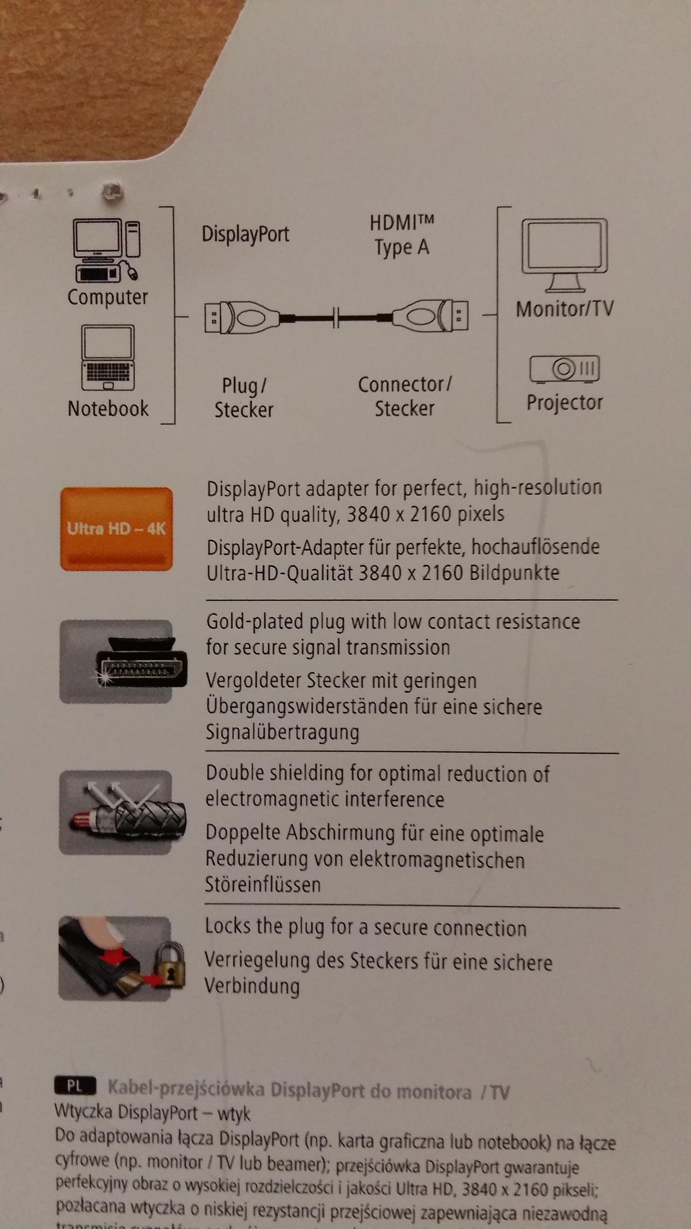

    Hi everyone involved in the topic,
    Well, today I took the DP cable from work -> DP, connected my business computer to the monitor and breathed a breath. DisplayPort in the monitor is functional and working properly.
    I also bought a second DP -> HDMI cable in MM, the description on the back of the package (below) shows that it is a cable that works with DP -> HDMI. However, there were no others in MM, I took it for tests. Unfortunately, it turned out that the cable did not fulfill its purpose. Well, from HDMI to DP it does not work the other way around.
    SAMSUNG S27E591C Monitor - HDMI to DisplayPort Signal Transmission Issues
    @irondick just so happens that I have a Dell computer and it is this one that is trying to connect to the HDMI minitor to DP. Will you tell me what worked for you?

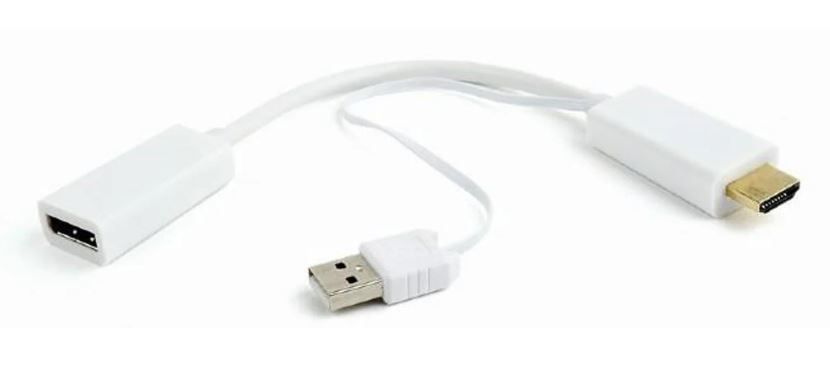

    310artur wrote:
    Don't get me wrong - in my opinion such an adapter should work bidirectionally. DP is backwards compatible with HDMI DVI and even VGA, if the latter is so sure that I would not be implemented (adding an analog), the rest should work.
    Not true. Only one of the DP variants can actually work as HDMI with a passive via. This port will be labeled ++ (Dual Mode) for the computer side.
    Active vias, in particular the one from the photo in the first post (I have the same one), only work one way - the computer over DP to the display with HDMI.

    Are you able to give a specific cable model (manufacturer) or a store where you will surely get something that works from HDMI (PS4 or Laptop) to DP (Monitor) ?!

    Hi,
    Wow, I did not know about the existence of such an option, I will read, look and decide :)
    Another possibility arose. I was already afraid that I would have to switch cables endlessly or until the HDMI port in the monitor would fall :)
    Thank you very much!
