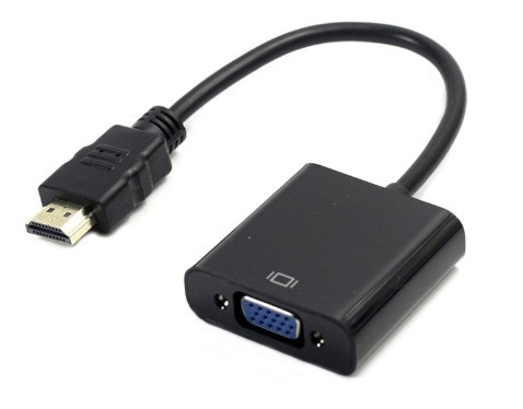

    and I bought: HDMI to VGA ADAPTER DSUB FULL HD cable
    I plug it in and it does not work. restarting the computer does nothing. the computer cannot detect the second screen.

    Therefore, it does not work if the monitor is analog and the graphics card has digital outputs, it can work when the monitor is digital but also has analog inputs.
    The inputs on the motherboard allow you to use the graphics chip built into the processor when you do not have a dedicated graphics card. You can use such a system if the computer is used mainly for multimedia such as movies or YouTube and other applications that do not require high computing power. It is also possible to play from poverty, but it is rather art for the sake of art.

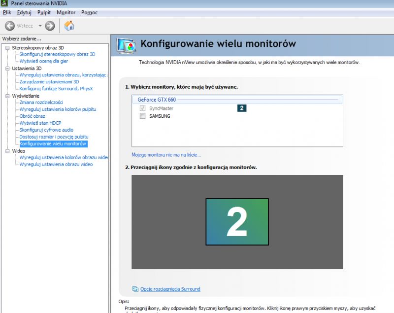

    after connecting both monitors what do you see in this tab?
    Example:
    Spoiler:
    Computer Not Detecting Samsung SA300: HDMI, D-Sub->DVI Adapter, Optimus e-Sport PC, Iiyama G-Master
    BTW I am comp. stationary, it does not matter if I plug into the DVI slot of the graphics card or the VGA card on the motherboard. I always have an image on the monitor or TV (the question of whether it is the basic or extended desktop is then set in the graphics card options).

    for me it does not detect the second monitor. when connected to the card adapter it is black and the power indicator is on. when I connect it to VGA, the first monitor goes out.
    The Samsung monitor (VGA) works because there is no problem to connect it to the laptop. does the computer's VGA input work? the computer is 2-3 months old. is new. Computer Not Detecting Samsung SA300: HDMI, D-Sub->DVI Adapter, Optimus e-Sport PC, Iiyama G-Master
