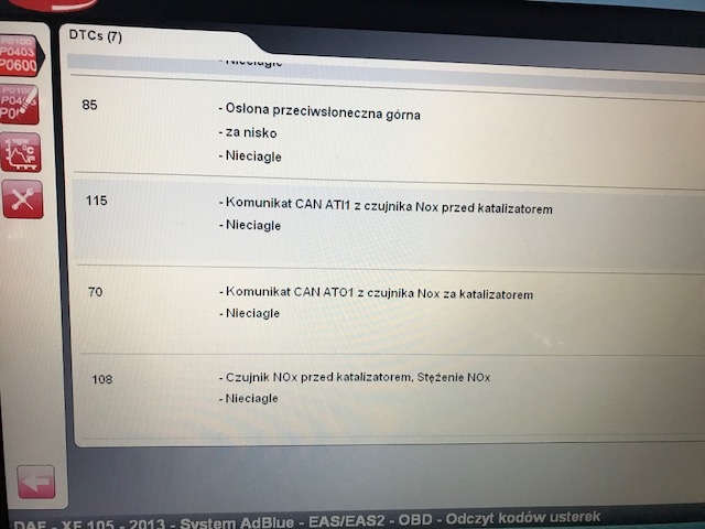

  • Intermittent exhaust warnings and idle-only errors 115, 70, 108, 17
    #9 16821893
    szy18
    Posts: 152
    Help: 8
    Rate: 127
    there are occasional warning messages on the board regarding the exhaust system. the message appears for a few seconds and disappears 2-3 times a week. and the next thing that came to my mind after changing the filters was to clear the system.
    Errors 115, 70, 108 and 17 appear
    errors occur only at idle. Euro car 5, 2014 mileage of 360,000 km.

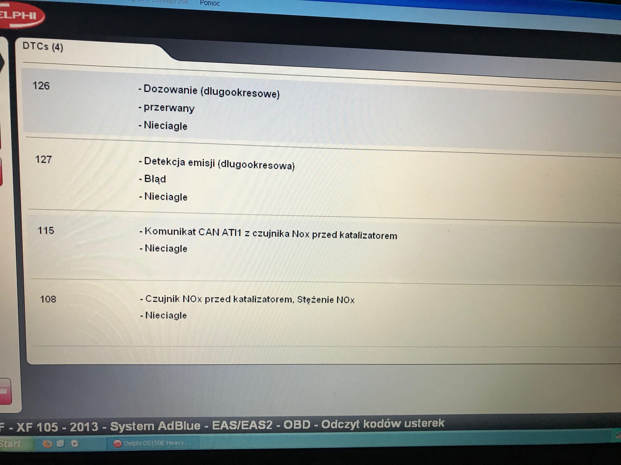

  • #10 16824402
    szy18
    Posts: 152
    Help: 8
    Rate: 127
    any krisbrumm tips?
    Added after 7 [hours] 3 [minutes]:
    today I read errors after returning from the tour
    I think it's time to get ready for NOX replacement
    what do you think ?
