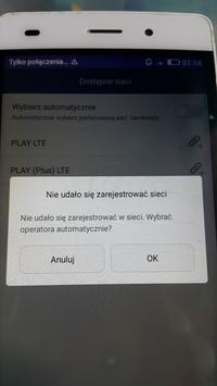

    I have a problem with this phone.
    Namely, there is a complete lack of coverage.
    Reads the SIM card without any problem.
    It happened after the phone fell.
    Replaced antennas, sim socket soldered, pre-loaded software.
    I suspect damage to the motherboard but I don't know where to start what to check.
    If I try to search for a network manually, I will find it often but when I connect to it, it ends in an error.
    Imei number is displayed correctly.

    Try to unscrew the speaker module for a moment and that metal cover above.
    If it starts detecting the network (my range is back), it means that something went wrong during assembly. (you twisted them too much or in the wrong order).
