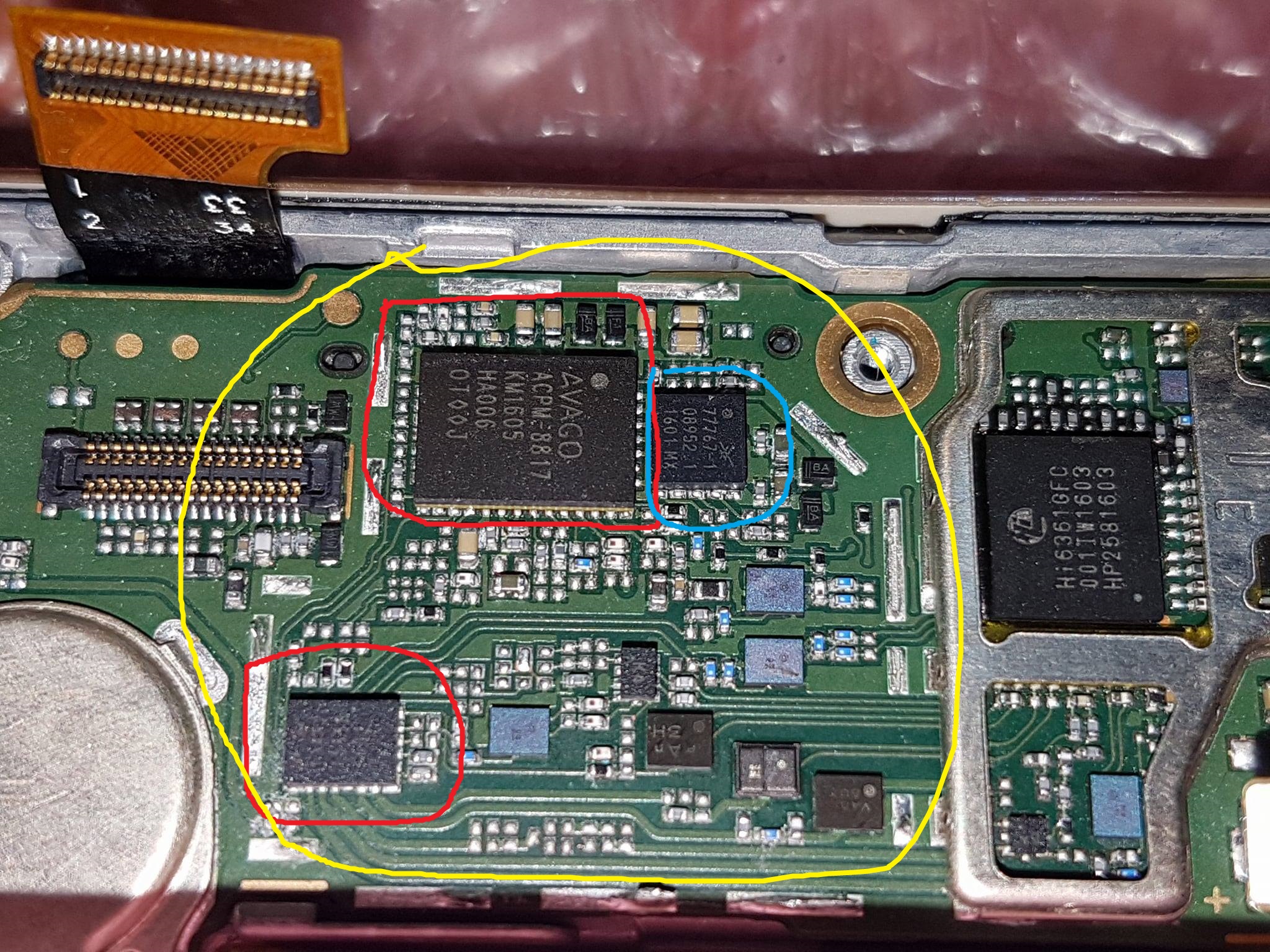

    The phone was slightly flooded, everything works in it, but the range is tragic.
    1 dash is max on LTE, the same on 3G, on 2G the range is max, sometimes half, in other places the range is lost.
    I watered the systems with flux and burned them out, downloaded the screen marked in the photo and mampytan are these elements responsible for the range?
    I have P8 lite for parts and maybe something can be soldered.

    What you marked is responsible for GPS and partly WiFi (quartz), RF amplifiers and filters are under the screen closest to the vibration, the RF Chip is under the screen next to the battery connector.

    So the systems marked in yellow are responsible for the range.
    The elements marked in red have been replaced and no effect.
    Then I desoldered them and checked the transitions to the nearest element - and everything looks fine, no path has corroded ..
    Honestly, I have no ideas what to look at. Maybe someone else will suggest?
