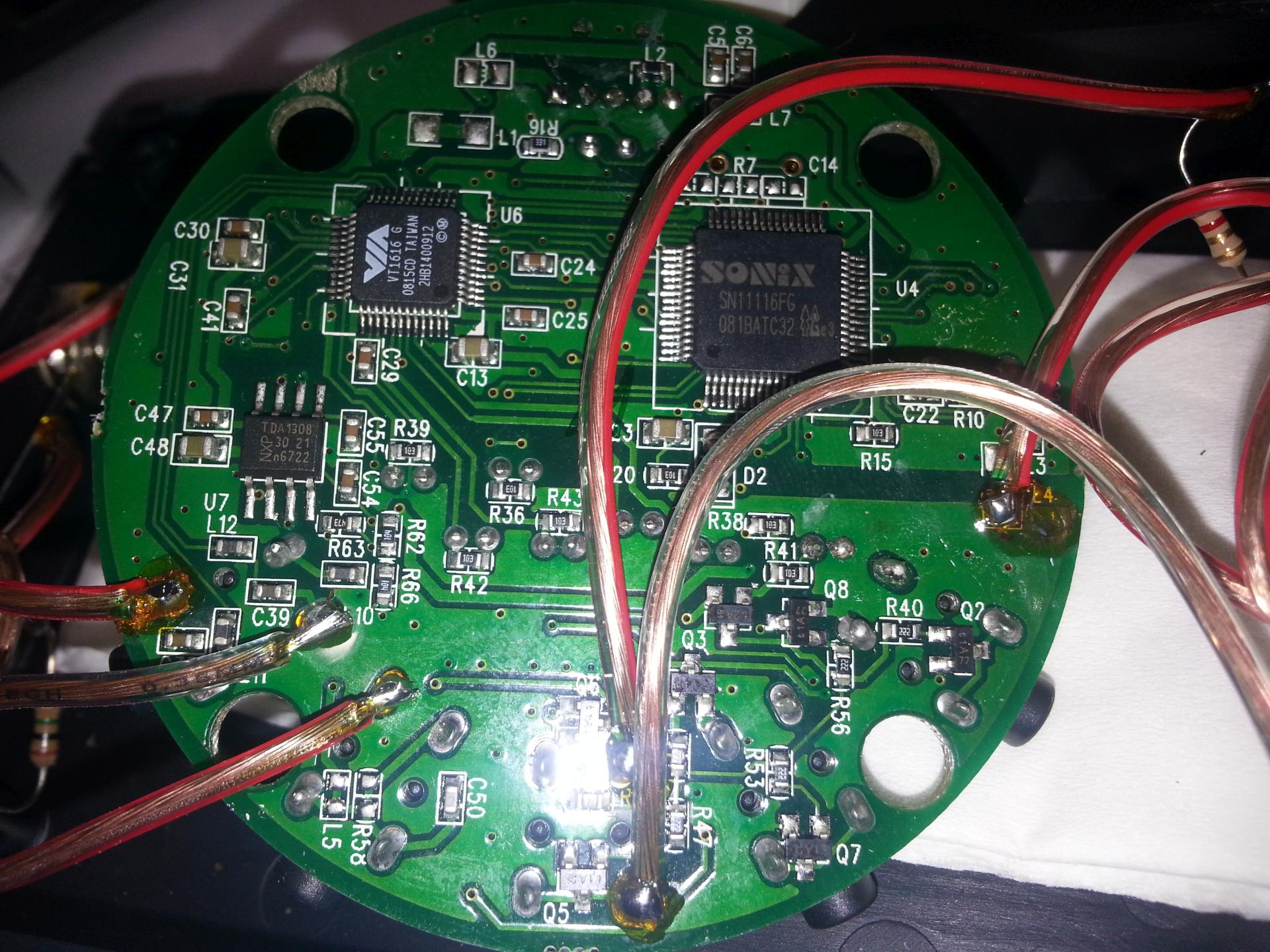

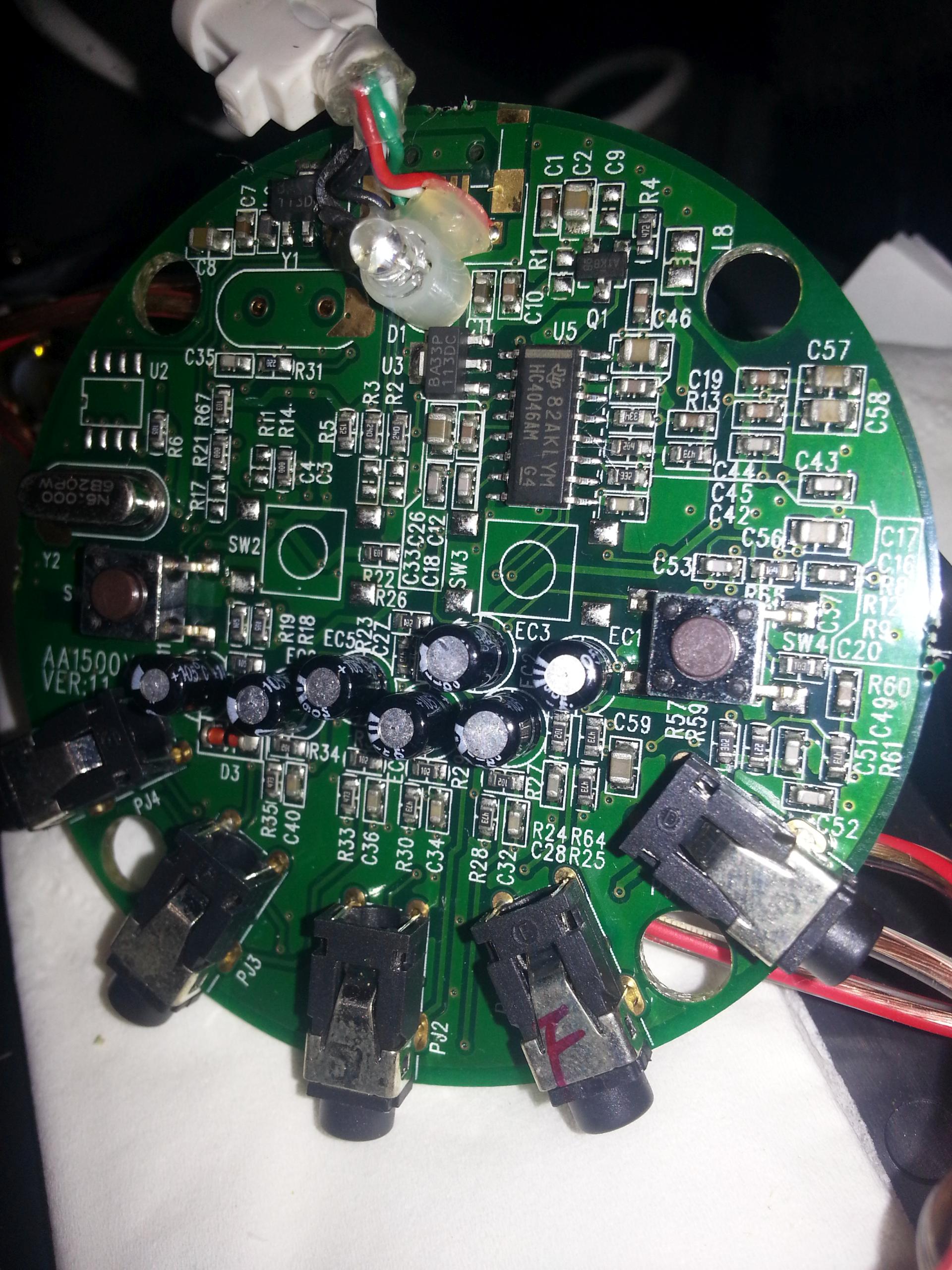

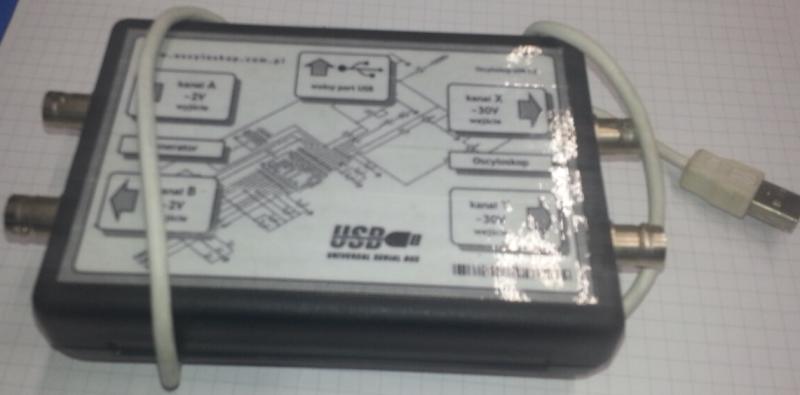

    Once upon a time, I was stuffed into a bottle for a lot of money compared to what I bought. I bought a USB oscilloscope and got this:
    The oscilloscope as a sound card - what program under Windows 102017-02-10...6-200a.jpg (26.26 kB)You must be logged in to download this attachment.
    The oscilloscope as a sound card - what program under Windows 1020170210_0..04a.jpg (428.19 kB)You must be logged in to download this attachment.
    The oscilloscope as a sound card - what program under Windows 1020170210_0..38a.jpg (611.61 kB)You must be logged in to download this attachment.
    So an ordinary USB sound card, with BNC ends soldered, + cables. I unearthed it a few days ago and wanted to use it. To use I have to:

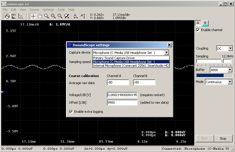

    For the first of the programs on the list:
    After copying to the devices directory and selecting the dsoundscope.dll plugin (rather from http://tomeko.net/dsoundscope/C_Media2/, i.e. dsoundscope_dll_1_3_bin.zip ): Settings / Device settings.
    GUI (miniscope.exe) from this archive should be replaced with a newer one, because there are two useful functional changes.
    The card looks interesting - I once read about a case when someone recognized a card inside that in normal sale was more expensive than an oscilloscope. Here after marking it GHE AA1500 - $ 32 on amazon.
