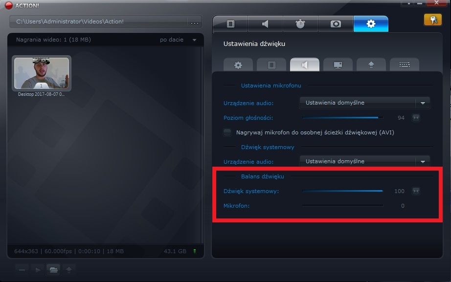

    vsh77 wrote:
    although the option to record the system sound is available, e.g. in Fraps and Apowersoft, it cannot be selected. Why? What am I doing wrong?
    What operating system? What music card?
    In general, if you want to record the sound of the system, you should set the appropriate sound source in the options.
    Most often, the sound is captured from the microphone input, you should switch to capturing sound from the mixer, you can do it in the program options or in the sound card software.
    Recently, I recorded with the Action! - this is how the sound settings looked:

    vsh77 wrote:
    And what is the Action! Version?
    1.11.0.0.
