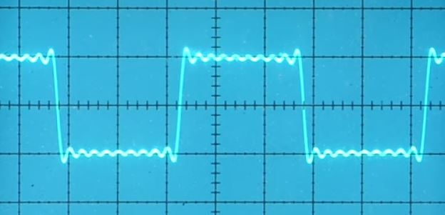

  • DC filtering in the sound card distorts rectangular, sine, and triangle waves, and the practical frequency range is lower than the nominal spec.
