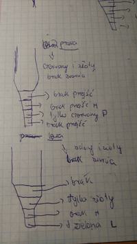

    I took a multimeter and there is a transition between the cables in both the right and left earphones. Would it mean that the converter is operational?
    I also wrote how the transitions between the headphones to the 3.5mm 4 pin jack connector go - there is also a microphone there.
    JBL In-Ear Headphones Right Earbud Not Working: Diagnosis, Cable & Converter Check, Microphone
    I would like to add that there is also a microphone on the left earphone cable on the way and it works. The law doesn't work
    In general, the transitions are very strange.
    I am asking for help and thanks in advance! :)

    Usually, the cord is broken in the headphones, but not always. First, you should measure the resistance of the transmitters and make sure they are good. It may be even easier to connect the headphones to the music source and move the cable with the earphone not working, if there is a sound, shorten the cable a few centimeters and solder it to the converter. If not, then move the m.Jack plug in the same way, if there is a sound, we know that the damage is at the plug and then it should be selected or replaced.

    The left earphone has no mass, the cable is probably broken.
    Here you have pin layouts, you have this 4:
    But it is good to unsolder the cable from the left, which has no transition to the plug and check it at 100%.

    I desoldered and checked the transitions.
    Now things are clearer.
    Just like the colleague above :)
    I don't think there is any weight on the right earpiece.
    Hmmm.
    Jack? Where to look for an interrupt?
    P p
    In the post, I think I confused the right with the left, I am already correcting it
    Greetings :)
    Ps # 2
    Resistance:
    Left: 15.2 OHm
    Right: 15.1 OHm
  • #6 16268874

    A break will be difficult to find, usually at the most bent point in the cable or in a branch, or at the jack itself or the handset itself. If the cable is long, you can try to shorten it, I would advise you to start with the jack plug because here is the easiest way. Possibly changing the cord from other headphones.

    Before taking the headphones apart, I was moving nothing.
    Now I soldered the opposite. The converter is 100% efficient. Heheh, I put such a stripped handset in my ear: pi I started to move very hard as much as possible, I heard crackles and then music.
    Now just replace the jack or try to repair this one: p
    I wish I had moved harder earlier.
    How to glue the headphones back? Hahahaha

    It is better not to stick the headphones until you fix the jack, because later there may be a problem which cable to which pin. The jack can be repaired at a low cost by cutting the housing by soldering the cables and using a heat shrink tubing or gluing the old housing together, if possible.
