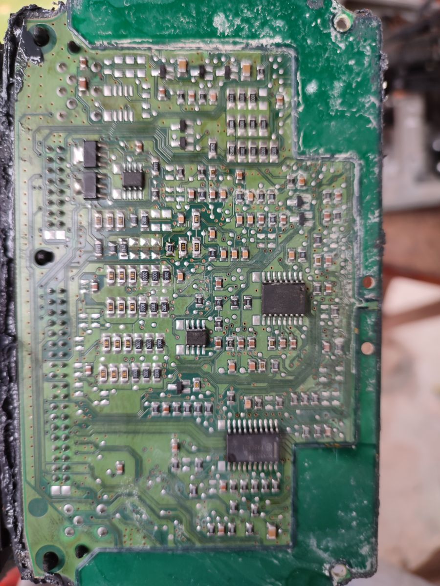

    Yes I did. I also checked the fuses and changed them to new ones ...
    So you unplugged the NOx and still the adblue level "jumped"?
    you checked the installation and it's ok, the fuses are ok, if you checked the above carefully and you are sure of it, there are two more options: the adblue level sensor itself or the controller in the pump.

    Can I somehow verify it myself?

  • #37 19640117
    hehe_2288
    Posts: 183
    Rate: 71
    Problem has been solved. I do not know where the adblue in the control unit came from, but it was still there. I am only wondering where it came from if there is not a drop of urea in the entire pump and it was in the driver. I cleaned, sealed, assembled and it works! Man TGX 440 Adblue Issue: No Communication, Error Codes DIAG 2061-08, EDC 3822-04, INST 8135-04

    Interesting ... maybe the previous owner, if he didn't clean something, although the photo does not show perfectly well, but it does not necessarily have to be adblue, and congratulations :)

    The entire pump has been regenerated, has been in use for two years, bought in a car ?
    Thank you very much ?
