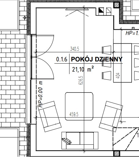

    I am buying a flat in a semi-detached house in the developer standard. I would like to make a proper audio system for "home cinema" in the salon. I am not a connoisseur.
    How to design it? What is important and what to remember? What should I ask the developer to do at the construction stage (e.g. plastering, flooring, etc.)? What cables and equipment to use?
    A request for help and advice.

    The living room will be with a kitchenette.
    The living room itself has approx. 21 m2 area.
    On one wall there will be a TV, on the left wall there will be a large (about 3m long) window to the floor.
    There will be no opposite wall because there is a kitchenette and a corridor with stairs (built-in wardrobe under the stairs).
    Opposite TV will be "rest"
    Condition will be developer, i.e. poured floor with underfloor heating (I don't know if it matters).
    Speakers probably 5.1. so with cables alone I can handle it.
    You will need to route the cables to the opposite wall to "relax".
    I thought that in the floor (in the floor) the developer would put a cable conduit for me in which I could pull the appropriate cables myself. At the wall, as part of the finish, I would let go of the cables in the floor strip to the right place.
    The question is whether this is a good idea or not?
    A request for alternative suggestions (if any), a suggestion of the type, type, cable specification (I do not know it) and suggestions as to the position and type / model / specification of the speakers.
    Below the floor plan.
