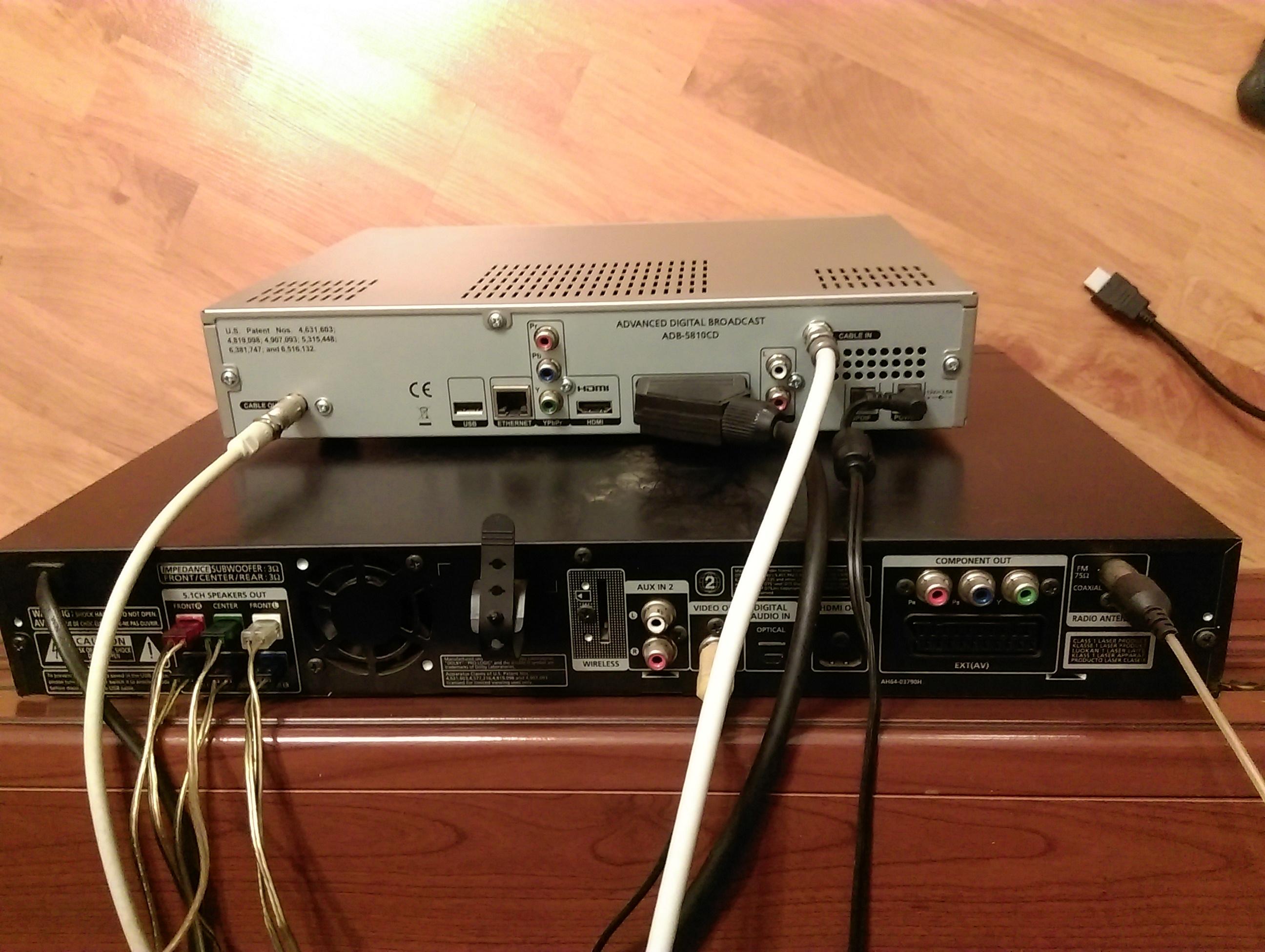

    Good morning to all users,
    I am looking for and I am looking for it, and despite a lot of similar topics, I do not get it in any way, hence my topic and a hot request to all professionals and people who are luring these topics for help, because I am a total layman.
    Namely, the question I have is how to combine 5.1 home cinema (Samsung) with the receiver (Samsung HT-X30), a TV decoder (ADB 5810 CD) and a TV (Samsung LE32R88BD), so that:
    - including the TV set and the set-top box, the receiver started up from the machine and the sound went through the cinema (not through the TV speakers) - if at all it can be so.
    At present, this is like in the pictures - the professional from the television hooked in when connecting the decoder and yes, everything works, but the sound flies through the serial TV speakers, and the receiver and the cinema in total dust most of the time.
    The picture of TV connectors is not clear - I will add clearer after coming home from work. I will also supplement the topic with tv and receiver models if there are such requirements.
    Greetings.

    The cinema will not turn on itself. You have to do it manually. The easiest way to connect is the chinch-chinch cable from the decoder under the aux 2 in the cinema.

    In the cinema and in the decoder you have a digital output and optical input :P SPDIF

    Well, there is an optical output in the decoder (cable covered). And connect it all with tv with hdmi cables.

    So how should I understand this? I am going to close the decoder with the receiver with the hdmi cable (I have such a 2x hdmi cable) according to @ andpol33 (green diagram), or SPDIF optical cable as it wrote @ wciełek1 (schematic red)?
    Connecting Samsung 5.1 Home Cinema, HT-X30 Receiver, ADB 5810 CD Decoder & LE32R88BD TV
    I repeat my request for understanding, because for me all this is black magic ;) the cable is a cable - for ch drill :P

    Hdmi in this home cinema is not just an exit. So it will not work.
    Connect according to the red line. And the HDMI from the decoder is at the top connected to the TV and that's it.

    According to my colleague, this is the best solution? I dares doubt ...
    It is correct, but only correct, does not generally solve the problem.
    For example - how will the sound be transferred to the cinema if the TV is connected via HDMI, eg a BR player?
    I will not mention that the combination of picture and sound synchronization often occurs with this combination.
    grigori1988 wrote:
    including the TV set and the set-top box, the receiver started up from the machine and the sound went through the cinema (not through the TV speakers) - if at all you can do it.
    It is possible, the situation is facilitated by the fact that TV and KD are the same company.
    grigori1988 wrote:
    a professional from the television hooked up
    Hyh, "professional" ...
    Why did he use the Euro connection if you can use HDMI?
    But there ...
    I would buy 2 HDMI cables and one TosLink optical cable on my colleague's site.
    The colleague will connect;
    - KD from TV - HDMI1 socket
    - decoder with TV - HDMI2 socket -> (*)
    - KD from TV - optical cable
    Any HDMI connections with devices turned off!
    (*) - in the decoder, the video output settings should be changed to HDMI
    In the decoder, also set the audio output setting to HDMI.
    Once your friend has the image / sound from the decoder on the TV with the HDMI connection, please disconnect the EURO cable.
    Then read the instructions from TV and KD - I am thinking here of activating AnyNet + (HDMI-CEC) in both devices.
    And the appropriate changes in the cinema settings - manual -> Using AnyNet +
    Similarly on a television.
    Good luck :)
