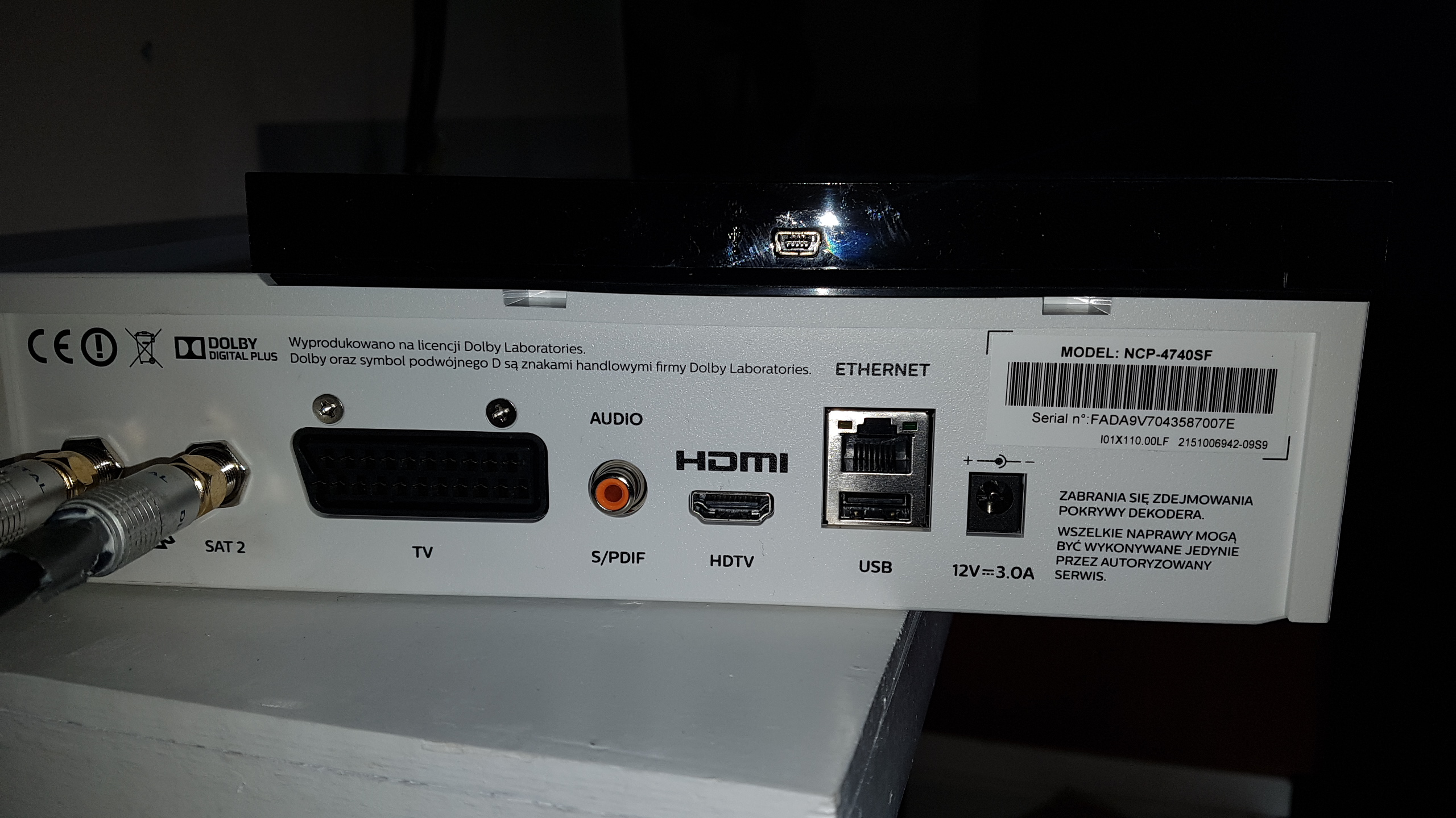

    How to connect a home cinema and decoder, so that there is sound in the home cinema watching something on the nc + decoder. My connection now is the cinema is connected to the tv with hdmi cable and the decoder with the tv also with hdmi cable. I do not know how to connect sound from a home cinema decoder. Please help.
    • How to Connect Home Cinema, Decoder, and TV Set for NC+ Decoder Sound with HDMI Cables 15032406732311682404529.jpg (1.28 MB) You must be logged in to download this attachment.
    • How to Connect Home Cinema, Decoder, and TV Set for NC+ Decoder Sound with HDMI Cables 15032404138281460910514.jpg (1.06 MB) You must be logged in to download this attachment.
    • How to Connect Home Cinema, Decoder, and TV Set for NC+ Decoder Sound with HDMI Cables 15032401345171113935321.jpg (1.02 MB) You must be logged in to download this attachment.

    Try Euro-RCA (chinch), Euro to decoder, chinch for home cinema on AUX IN.

    Is not everything connected via the HDMI cable? If not, I would give RCA from the set-top box to the cinema and DMI to TV. Do not you have an optical entrance?

    You need the s / pdif - RCA converter.
    https://www.google.pl/search?rlz=1C1GGRV_enPL...b.3..0i22i30k1l3.3814.7837.0.7997.4.4.0.0.0.0 .224.445.2-2.2.0 .... 0 ... ... 1.1.64.psy-ab..2.2.444 0.k5deLUoJPL0
    Connect the s / pdif output of the decoder with the s / pdif cable to the converter, and connect the converter with a 2x chinch cable to the KD. Of course, the sound will only be stereo.
