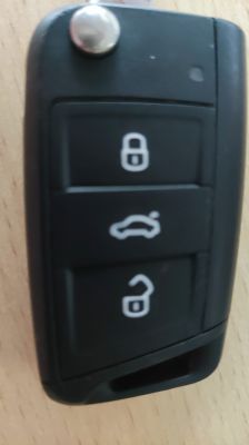

    Hi.
    I would like to ask for help with an unusual problem. I have recently replaced the CR2025 battery in my key (Seat Leon III 2016) with a new Energizer battery:
    Seat Leon III - After replacing the battery in the key, the car reports a low battery in the .

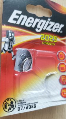

    Battery marked "fit for purpose" until 2026 so looks like a fresh supply. The problem is that 3 weeks after replacement, when starting the car on the computer a message pops up to replace the battery....
    I measured the voltages and yes, there is a Panasonic battery in the other remote (spare). The voltage measured with a meter on the battery is 3.01 volts.
    The battery in the key fob (Energizer) is 3.05 volts, I checked after pressing the button for example - 3.02 - 3.03 - a marginal drop.
    I checked the 2nd battery from the blister (when I bought it there were two for replacement). A new unused battery has a voltage of 3.23 V.
    Now to the question:
    What could be the cause of the battery being identified as used despite the correct voltage? Could the fact that the new battery was 3.24 volts have messed up the electronics in the key, or switched something and now anything below 3.2 volts is reported as too low a voltage? As I mentioned the spare key has a weaker voltage and it is not identified as a battery to be replaced. Please help to unravel this conundrum.

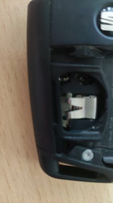

    Check the contacts in the key (cleanliness) through which the battery connects to the rest of the electronics, as a voltage drop can be deposited on them, which can cause the battery to be treated as worn out.
  • #3 19615122
    patryko_88
    Posts: 12
    Hi, I have tried this unfortunately nothing has worked. The contacts look perfectly clean. I also did the trick of taking the battery out of the key for 5h. After putting it back in, the key reported no battery problem for 2-3 days then the problem returned.

    To me, this 'number' would indicate that current is escaping from the battery as it is in the key minimum and this is causing the voltage on it to sit and not have time to rest - when it was removed it had time to regenerate. If you can see nothing on the board itself, then the problem could be in any of the buttons that it is not giving 100% break.

    I checked the current consumption of the remote control with an ammeter and it is 0 mA. The consumption when pressing the button jumps to 1 mA.
    Now a curiosity:
    I swapped batteries: from the auxiliary key I put a Panasonic with 3.01 V into the key I use every day, and into the auxiliary remote control an Energiser which has 3.03 V according to the meter.
    The car for both cases now reports no need to change the battery. I have also done the manoeuvre of taking the battery out of the primary remote - putting it back into the remote and yet the car still reports the need to change the battery.

    Part, a brief update after a few days of testing. It turns out that there is something wrong with the batteries I purchased after all. I mentioned earlier that I changed the batteries in the keys:
    I put the battery from the spare key into the primary key, and put the one I bought new into the spare key.
    I use the keys alternately and the result is as follows:
    The primary key (with the repositioned Panasonic battery from the primary key) reports no errors.
    The secondary key (with the new Energizer battery) reports a low battery error.
    In my opinion, this clearly proves that the problem is with the battery and not the key electronics. I guess I was out of luck buying these batteries. Maybe it was some kind of stock lying around? Hard to say. On the other hand, it's better that it's a problem with the battery than with the key :) .

    In many cases even brand new batteries coming directly out of the package which measure 3v and more with multimeter can not work in practice.Try to replace it using a different battery brand.

    Batteries from different manufacturers, despite identical appearance and size, have different capacities and thus different maximum discharge currents. It would be a good idea to look in catalogues and choose a battery with better parameters than the one from Energizer.
