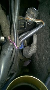

    In the morning, at the first firing after a night at minus 5 to minus 10 ° C and lower outside, the climatronic blows on the windshield for a very long time, it behaves as if it was hanging. I will drive 8 km to work and blows all the time on the windshield where under work I turn off the engine, restart and the climatronic starts working properly, i.e. blows gently on the windshield and the cockpit. The set temperature felt from the grilles is adequate. I checked zero errors with vag, but I am worried about the engine temperature parameter after connecting and checking the blocks shows 50 degrees, while when connected with a vag engine it indicates the correct temperature according to the counter clock. I did the coding / adaptation according to the instructions from the "internet" everything like ok but the problem remains. I wonder in the grille at the windscreen "exposure / sun sensor" can he be the cause? Or some other sensor? What to check

    Ear cracked, I attached the g17 to the bumper with armbands. I do not have an external temp display, I watched the values with vag. At the outlet from the engine block I have two sensors, black 4pin and blue 2pin. One of them is g110 but which one I have no idea. I am worried about the vage display which shows after connecting the climatronic in the measuring blocks bite 50 deg. When connected with the motor it indicates 90 deg correct. Where does the climatronic take these 50st? from which sensor?

    The overload of duties caused a delay. I was checking errors in the climatronics and I have "1274 V-damper motor control V71 damage". Location request (illustrative picture welcome). In addition, I checked the sensors and I have two, one four-pin and the other two-pin blue you mentioned G110.
    However, which is responsible for "stupidity" in the form of engine temperature at 50 degrees. C in climatronic data blocks? I think that's a problem.

    I ordered this sensor, let me know how to replace if there is improvement. Thanks for your time.

    After replacing the "blue" sensor, he took the strange action of the climatronic by hand. As the engine temperature rises, it starts to blow from all grilles - it finally regulates and does not hang on the windscreen thanks to Jarzabek666 for guidance.
