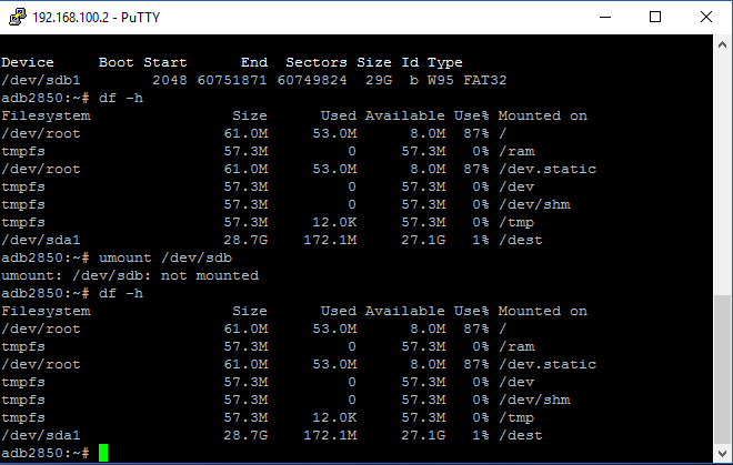

    Welcome
    I am trying to install Graterlia OS on a PenDrive USB 32 GB USB 3.0.
    I follow these instructions strictly - http://graterlia.xunil.pl/index.php/FAQ_-_Strona_1#mozTocId184425
    I'm having trouble with the second command "Now enter fdisk / dev / sdb in the terminal"
    The message it receives in the terminal in response to the fdisk / dev / sdb command is as follows:
    fdisk: cannot open / dev / sdb: No such device or address
    Probably before this command you need to check the status if PenDrive is mounted or mounted - but I can't see anywhere
    commands for this operation. However, the instruction from the link above does not have this command.
    I am asking you very kindly for help.

    Again, a colleague does not read the instructions.
    Your flash drive is on sda so the command should be:
    fdisk /dev/sda

  • #11 16286343
    whitewolf1608
    Posts: 64
    Thanks for the answer. If IPTV works under every soft, including Neutrino, please send link how to upload to Neutrino IPTV Player with
    terminal.
    Dad grasps Graterlia well, he had Open Pli 8.6 in the decoder's memory before, but when we learned that Neutrino is the lightest
    the service technician uploaded Neutrino to the Nbox 2850st. And the service had to be sent because after disconnecting the power supply it did not register, i.e. the diode on did not light
    him. It turned out that there was a problem with the processor and the processor was replaced. After replacement, it works correctly.
    Can I find out what 'GOS created by a layman for the layman' means?
    Added after 14 [hours] 50 [minutes]:
    I am asking you kindly for support.
    Enter the umount / dev / sdb command
    The terminal responds with umount: dev / sdb: not mounted.
    After making sure that PenDrive is actually mounted by typing df -h
    I get a response from the terminal that the dev / sdb device has 1% use.
    I kindly ask for support because I have a little unclear situation in the terminal, because of my knowledge after entering the command umount / dev / sdb - then after entering the command
    df -h I should get information from the terminal that it is 0% use.

    Start thinking logically ... since you have dev / sda1 mounted to / dest why are you stubbornly trying to unmount / dev / sdb?
    The unmounted device should not be in the system so where did the idea from 0% come from?
