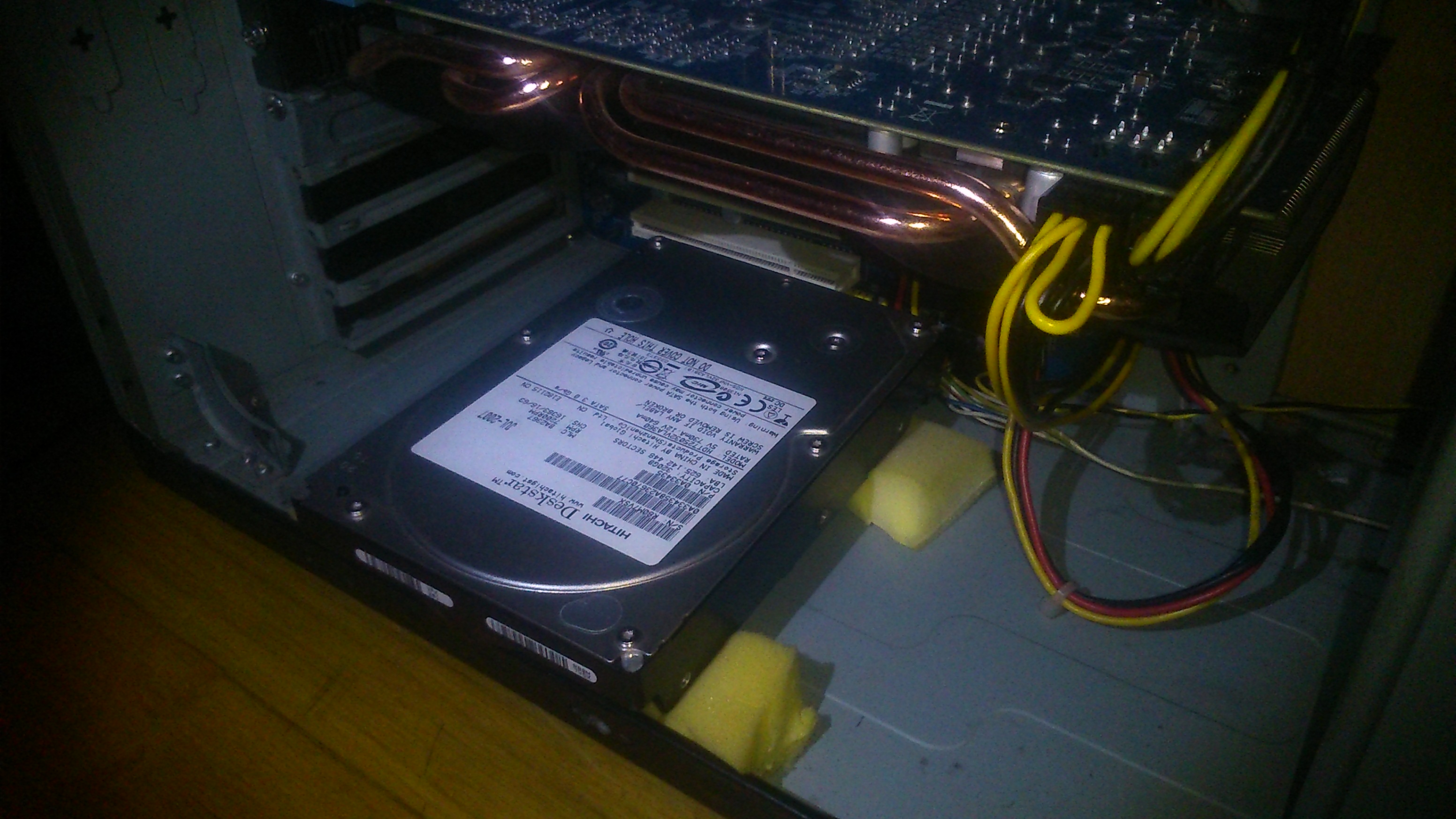

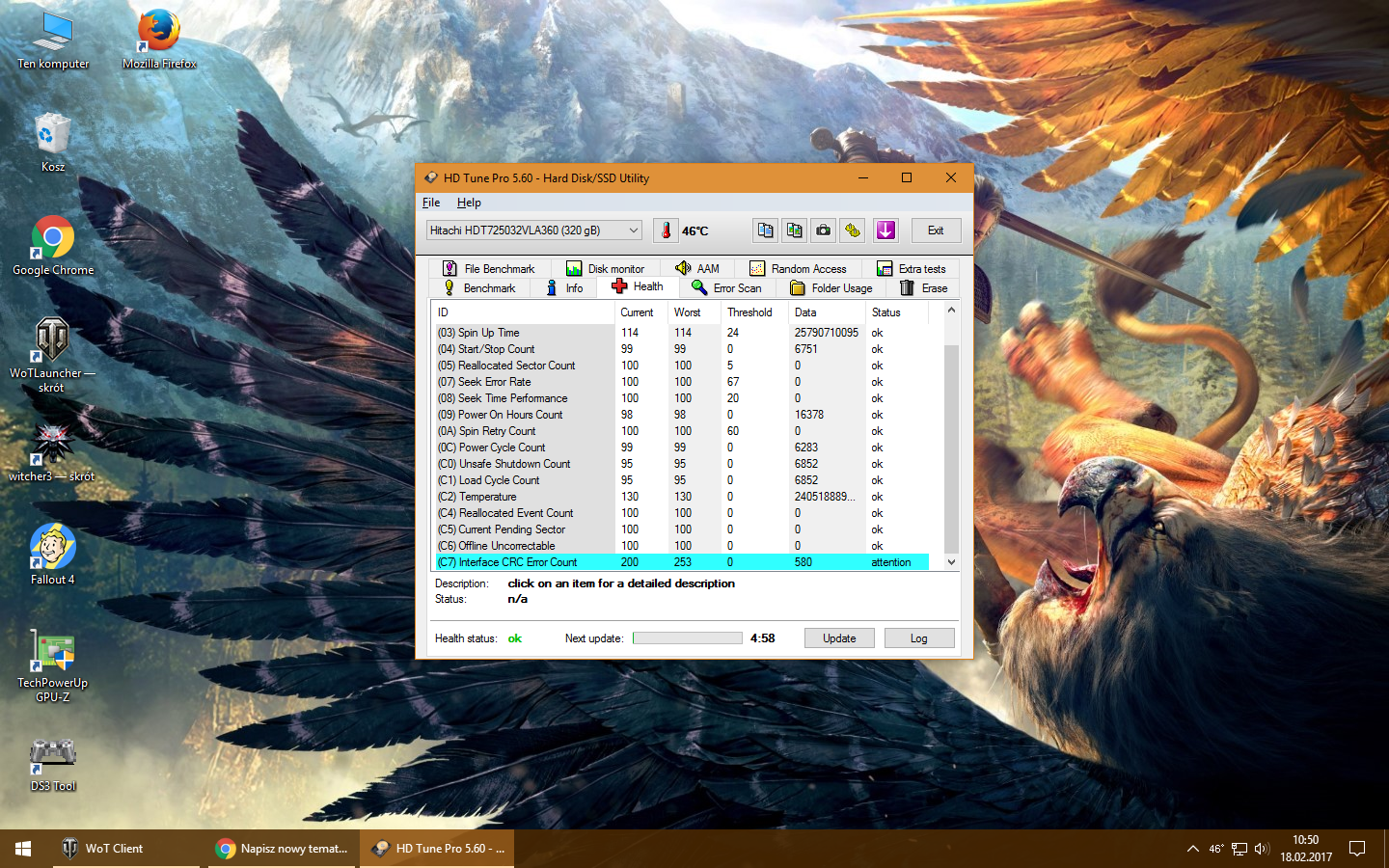

    Hello, I have a problem with the disk. I mean, it works normally, but I'm worried about the increasing C7 parameter. What could be causing it to grow?

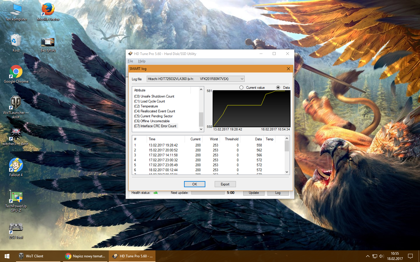

    I would add that when I got this computer, it was at the beginning 558 quite long, then it grew to 572, and continues to go up, it's already 581, and so every now and then.
    What to do?

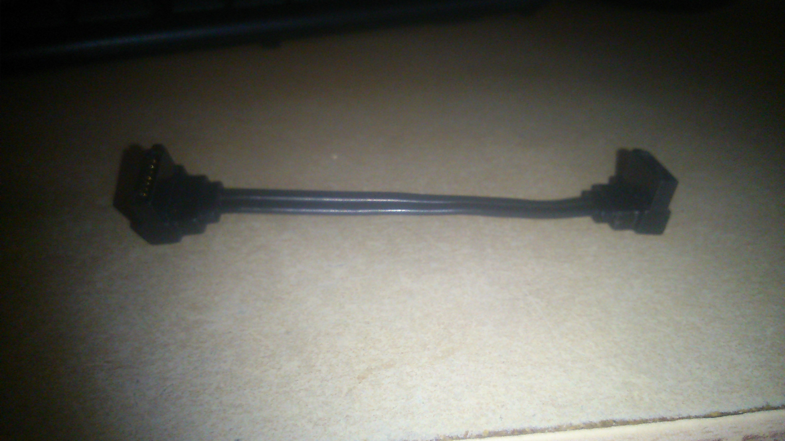

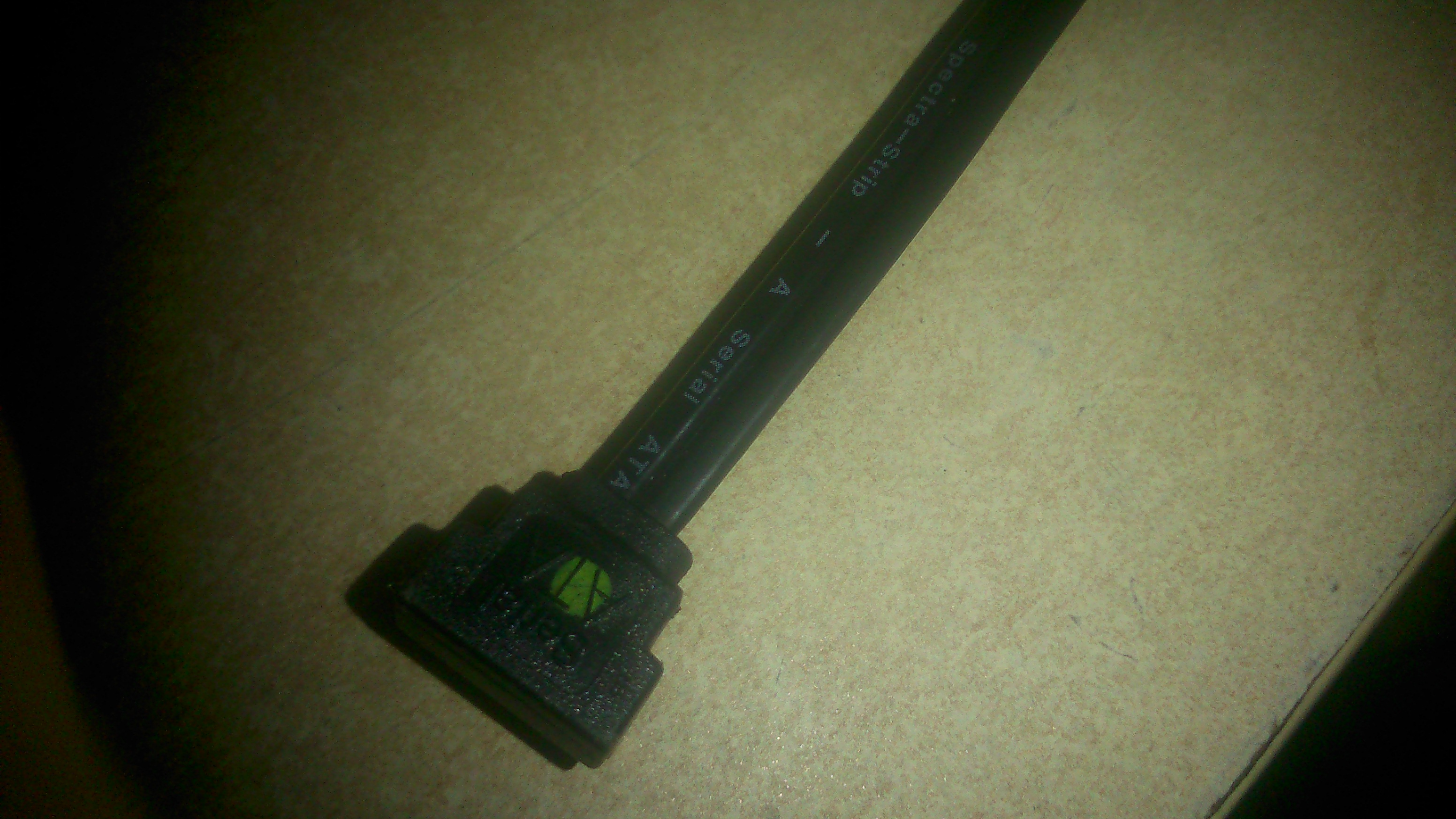

    I can change. I have one more computer sat, but I'm not sure for it, because the whole tip moves and is loose (made in china).
    I still had a short sata cable from the xbox 360 that connected the drive with the console board. Will it be good for your computer?

    Attribute 199 (C7)
    UltraDMA CRC Error Count
    Total number of CRC errors in UltraDMA mode. The RAW value of the attribute indicates the number of errors detected by the CRC when transmitting data in UltraDMA mode. The most common cause of errors is ribbon-to-cable data communication problems. This parameter does not decrease after the cable fault is corrected.
    Critical: No (The lower the value the better)
    I also see a problem with the disk temperature, it may indicate that all hardware has too high temperatures.

    The temperature of the disk is around 47 ° C. This may affect the C7 parameter?

    Temperature has no direct influence on parameter C7.

    Ok, I replaced this cable with the one from this xbox. It looks a bit cheesy and I can't close the casing because it is very short.
    And one more question. If this C7 parameter does not increase, does it mean that communication errors are no longer present?
    :arrow: kokapetyl - you wrote that these are errors in UltraDMA mode, and this applies to the ATA interface (I think) and I have a sata disk and I do not know what to do because I do not write UltraDMA only interface crc error.
    Anything else I can do?

    Watch this parameter for increasing. If it does not grow, it means that it is all right.
    And also these temperatures, something needs to be done.

    Ok, I have just bought a normal Sata cable so red and the disk is already in place. Now the cable sticks better to the disk and CD (it "sits" better).
    As for the temperature, I know why they are the way they are. Because the disc is on two pieces of cut sponge, as shown in the photo, but the disc is so located that the electronics has access to air.
    But the temperatures aren't the worst, are they? Am I wrong ?

    Well, and the disk has such a temperature because of these sponges because when it was screwed in (it was loud), the temperature did not exceed 42 * C.

    Ok, I did two votive battles on maximum graphic details with vertical sync at 75 fps and the result is like this: Hitachi Disk C7 Interface CRC Error Count: Causes and Solutions for Increasing Values

    Everything is OK - as far as temperatures are concerned.

    Actually, why after eliminating the problem, why parameter C7 shows the value of 581? Why didn't it go down to 0?
    #14 16288297
    Kasek21
    Posts: 45660
    Help: 4981
    Rate: 3547
    Because this parameter is not reset!
    #15 16288301
    Dra98
    Posts: 9194
    Help: 1321
    Rate: 1076
    The value will not reset itself, it is enough that it does not change - it does not increase.
