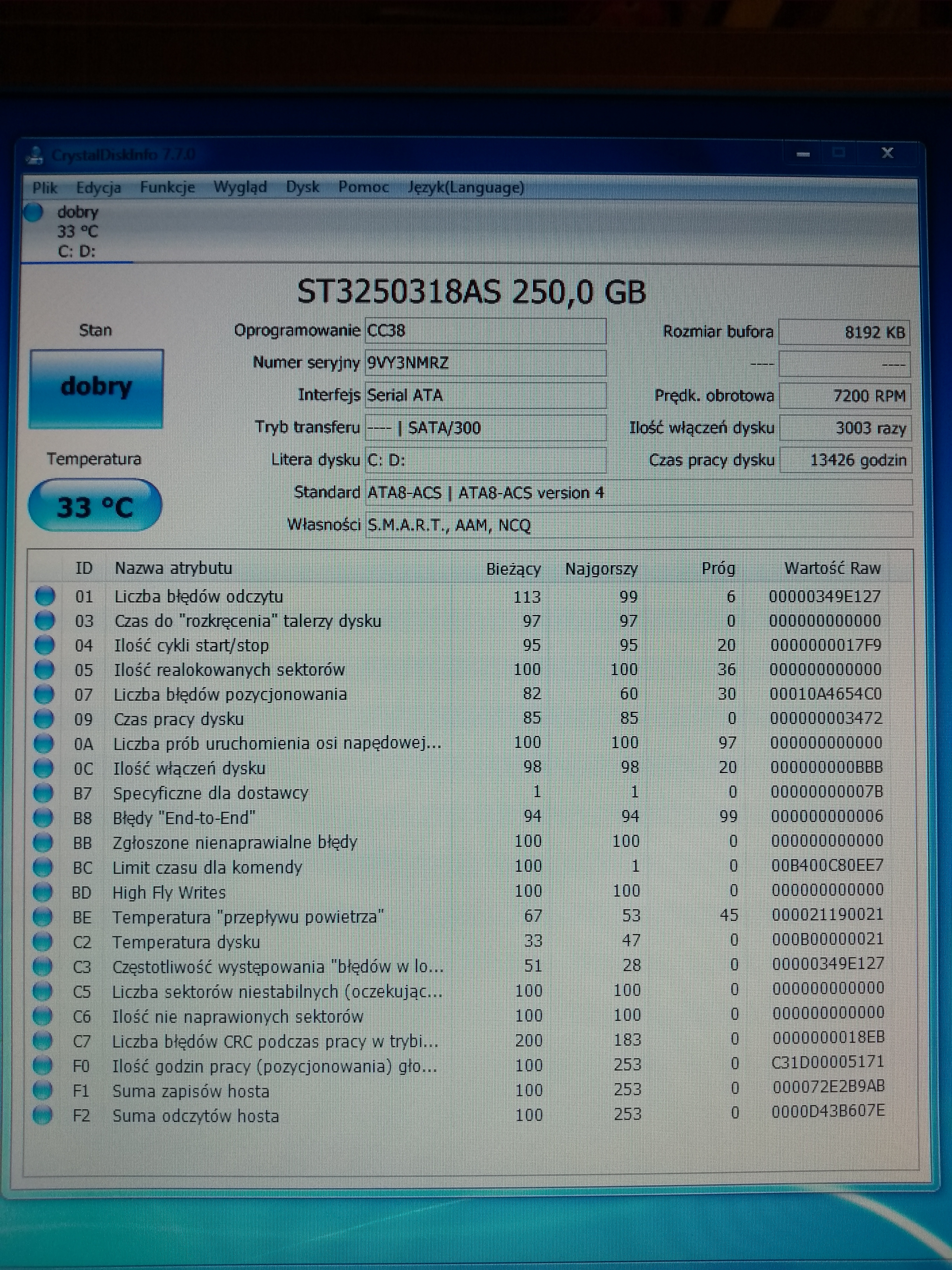

    Hello, the HD Tune Health test showed the error below, is this something serious or do I need to worry?
    HD Tune Health Test: B8 Unknown Attribute Failed - Should I Worry? Error Analysis

    This is an End to End error. His speech is nothing good. This error occurs when there is a problem with the disk cache. Unfortunately, I don't know how to check the efficiency of the disk cache.
    In general, a disk with a defective cache memory can be very dangerous - such a defect can lead to corruption of data written on the disk (ie it may be written with corruption and impossible to read correctly).
    But maybe the problem is elsewhere. Parameter B7 is SATA Downshifts. The disk passed a lot of them (this means that it switched to the lower SATA generation in the course of work to be able to work properly). This means that there may be something wrong with the SATA cable, it is worth replacing it as a preventive measure.
    Unfortunately, you found the rest of the table invalid, so it's hard to judge the rest of the parameters.
    Based only on this data, it is worth replacing the SATA tape with a decent one and observe whether the B7 and B8 parameters (RAW values, i.e. the Data column in HDTune) will not increase.

    Hello, changing the tape did not give anything, the error still appears, I did a test with CrystalDiskInfo, the readings are the same:
  • #11 17396956
    dt1
    Admin of Computers group
    Posts: 48250
    Help: 7315
    Rate: 8292
    Changing the tape probably did a lot. Errors that have been accrued will not suddenly be cleared after changing the tape. However, no new errors appeared, the B7 / B8 / C7 values are the same as a week ago, so the situation does not worsen.

    Probably right :) Now I have two questions: is it dangerous, however, and should a drive that has been behind it over 13,000 hours be replaced even more?
    Recommend SMART monitoring and regular backups
    #13 17397044
    dt1
    Posts: 48250
    Help: 7315
    Rate: 8292
    No drive, even a new one, is a device that should be trusted in particular. Back up your important stuff, whether to a 13,000-hour drive or a new drive.
    In addition, the new drives are faster, but their failure rate also seems to be higher than that of the old models.
    Honestly, if the drive is okay with no problems, it doesn't panic too much. You can install SMART status monitoring software periodically and inform you if something starts happening. I would most likely do that.
