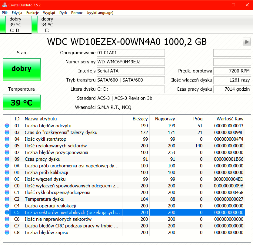

    Welcome. I am writing about one of the parameters in Crystal Disk Info. Every once in a while I check disks with CDI and HdTune programs and recently one of the parameters worried me (given in the attachment). Is the disk damaged or is it something important and can it be repaired? Best regards and thank you in advance for your help.
    • Crystal Disk Info - Number of unstable sectors (waiting for remapping) Crystal Disk Info.png (75.77 KB) You must be logged in to download this attachment.

    So the only way is to remap and remove everything from the disk? A bit of Kiev. Somehow you can check how many of these sectors there are and if I can have any problems because of it, or maybe it's just a small logical error and will go without further action. And if I still have a warranty for this disk, is such a thing subject to it? And if after the disk defragmentation, the status changed to good as in the attachment, it means that it was a logical error and you can ignore the earlier problem?
    • Crystal Disk Info - Number of unstable sectors (waiting for remapping) gjhgjhghg.png (90.15 KB) You must be logged in to download this attachment.

    The remap does not delete anything from the disk, but just in case you need to secure the data.
    As for checking the number of bad sectors, you can check with MHDD program.

    This is not a tragedy but I suggest scanning the Disk and resetting :) of course, download important data before you reset it

    I'm just curious that after the defragmentation, surprisingly, the warning disappeared. And after that, I don't know if I want to play remaps since I still have a drive guarantee for a few months. How to scan this disk to find out how many sectors are there?

    MHDD - F4 button twice.

    I also suggest you make a scan in MHDD.
    For WDC the attribute (01) should be 0 and here you can see the changes on the screens that may indicate a problem with the surface.
    About SMART - https://www.elektroda.pl/rtvforum/topic1467175.html

    Need to boot a computer with ISO MHDD? Tomorrow I'll do a scan and send the results.
