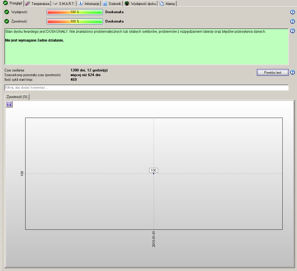

    I have a similar error + one extra.
    drive to the trash?
    Seagate ST1000DM003 - Interface CRC Error Count - what is it? Give back?
  • #8 14278015
    sPeRaCz.PL
    Level 42  
    Posts: 8573
    Help: 908
    Rate: 614
    Not in the bin. But it has too 'hot', In addition, a SATA signal cable to be replaced.

  • #11 14278060
    Gats
    Posts: 7
    sPeRaCz.PL wrote:
    Show screen of "Overview" and "SMART" tabs from Hard Disk Sentinel
    prego.
    Seagate ST1000DM003 - Interface CRC Error Count - what is it? Give back? Seagate ST1000DM003 - Interface CRC Error Count - what is it? Give back?
  • #12 14278080
    sPeRaCz.PL
    Level 42  
    Posts: 8573
    Help: 908
    Rate: 614
    The drive is operational. SATA signal cable to be replaced.
  • #13 14278092
    Gats
    Posts: 7
    ok the cable is new
    is it possible that the SATA socket on the board is collapsed or something is happening to the SATA controller itself.

    With this attribute, once it has been registered, it will not disappear. It should be observed if it does not increase.

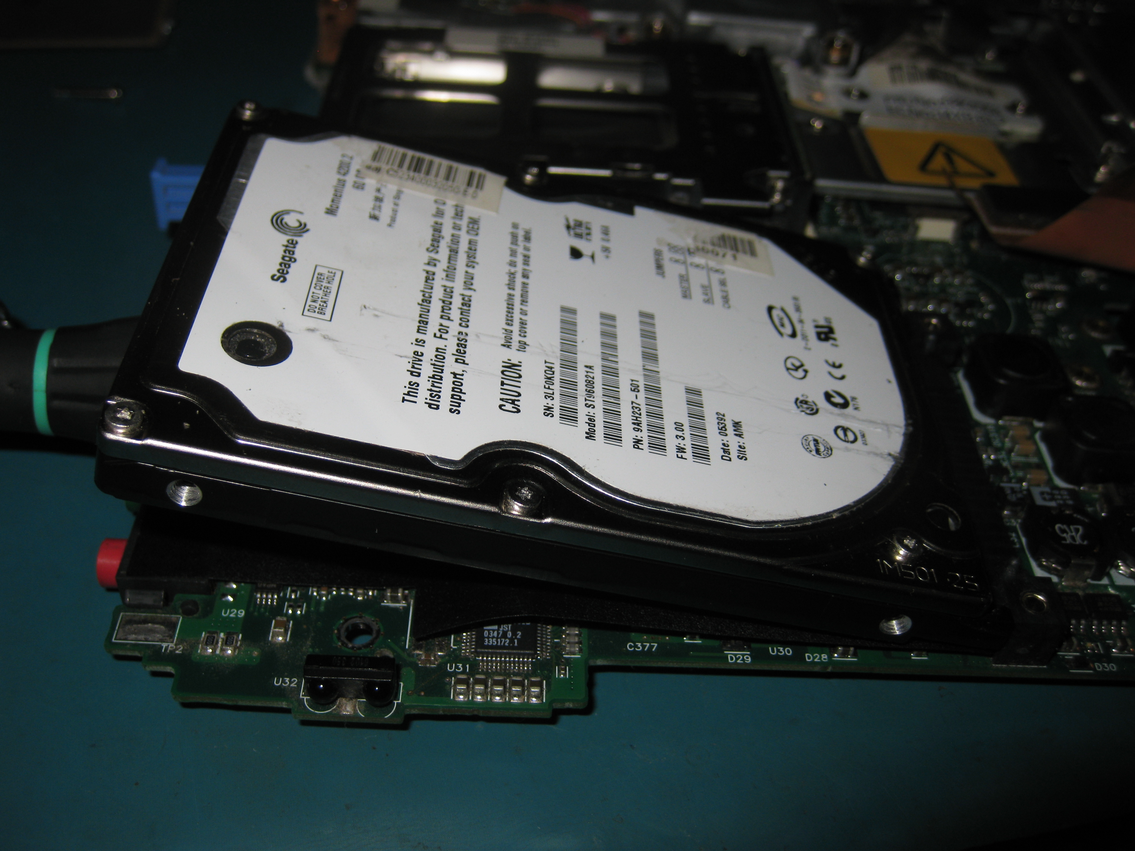

    I encountered this problem in the IBM R40 where I could not install the system, there were various errors that usually ended with a blue screen during installation, or it happened that the laptop did not see the disk when properly mounted in the pocket;
    After some time it turned out that the ATA socket with deformed pins is faulty and communication was incorrect; only the disassembly of the equipment and the proper lifting of the disc, see photo
    allowed to carry out a full installation and after checking the tough guy with the HDTune program, revealed the defect ...
    the replacement of the socket resulted in the correct operation of the laptop and the number of entries in the Interface CRC Error Count did not change ... but did not eliminate / reset it, as pointed out by a colleague:
    sPeRaCz.PL wrote:
    With this attribute it is so that once it has been registered it will not disappear. It should be observed if it does not increase.
    so if someone has similar problems in the future, the first thing to do is to check the socket (s) or cables, ending with the replacement of the carrier or replacement of the motherboard ... usually replacing the cable in the Sata standard helps ...
    Moreover, I think that the topic is exhausted and to be closed ... and the author's disc is operational! probably the seller had problems with the disk, but not because of him, but unknown to him, so he resold the disk ... hence the media recorded 15 entries about incorrect communication during 27 hours of work ...
