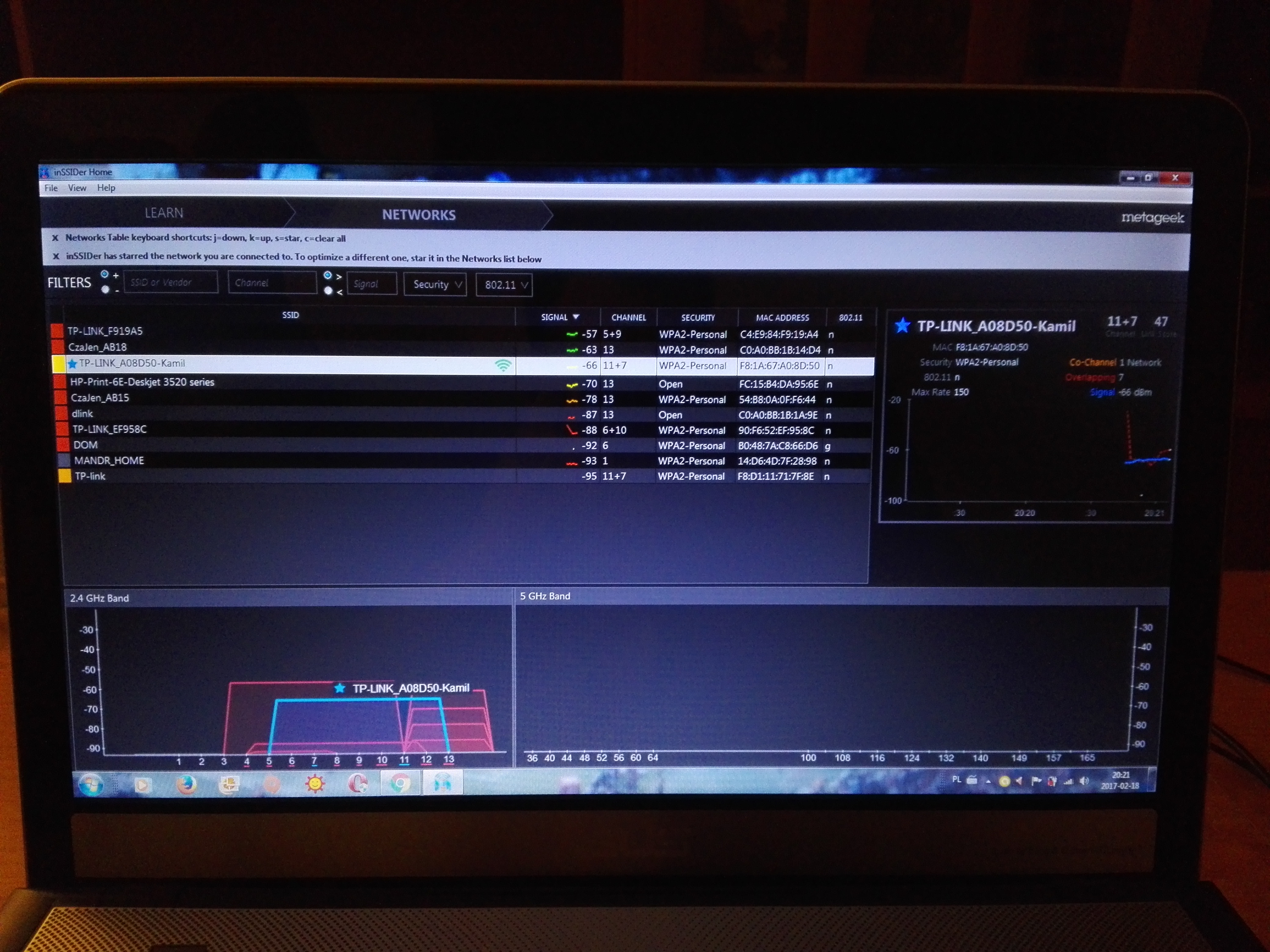

    Can you pull the cable there and put up an additional WIFI point?
    WR1043 are OK.
    Place a laptop in the place of poor reception, install / run inssider 2.x, perform a scan, show the results.

    Affordable Routers with Superior WiFi: Recommendations for TP-link WR740N Upgrade? Something like that?

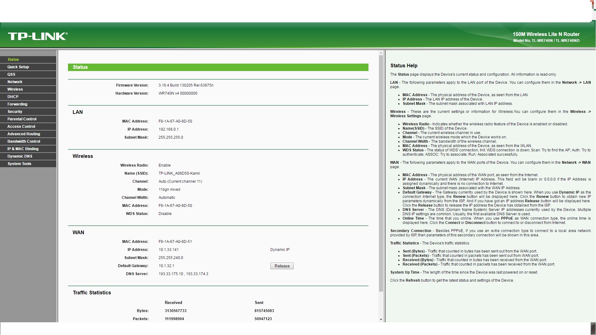

    So exactly what channel do you mean? Should I enter the router settings?
    Yes

    Just so I know where to change it. Affordable Routers with Superior WiFi: Recommendations for TP-link WR740N Upgrade?

    Mouse over, attach both halves of the poppy seed to think,
    e.g. google - how to change the WIFI channel in the router.

    Via Vistumbler I wanted to change but I don't have any channels available and I can't even choose the first channel

    Left navigation "Wireless" and then mouse.

    Changed to the first channel.

    You could try a 5ghz router (dual 2/5 ghz), it can definitely improve the speed, as long as there is no crowding on the 5ghz band. Mobile devices should support 5ghz. But it's not going to be cheap.
    Your card probably does not support 5ghz (and it supports WIFI card model), because the inssider shows NOTHING on 5ghz channels.
