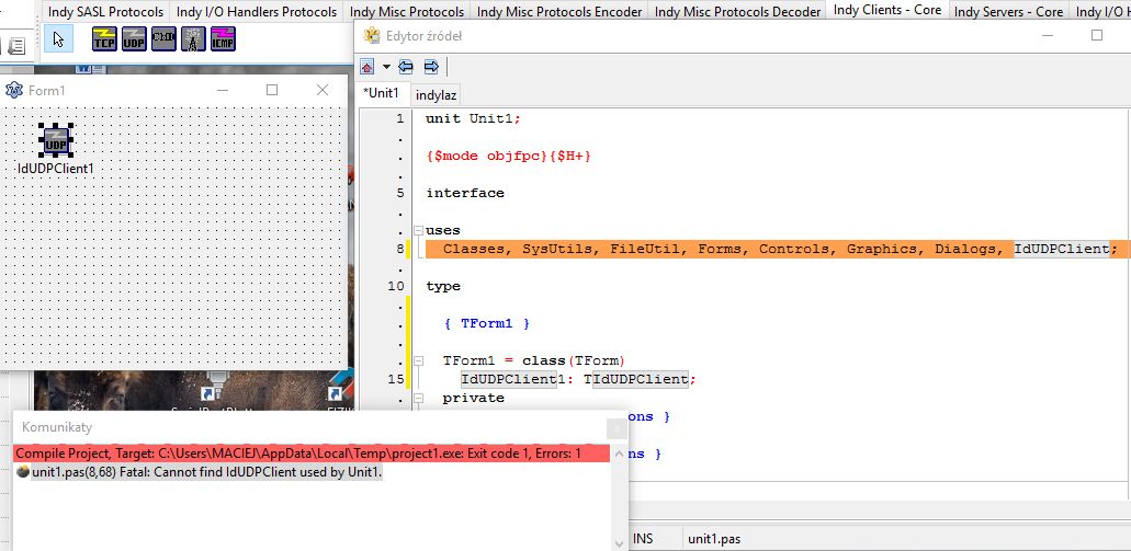

    Well I guess that's what I mean, but for now I have a problem with Lazarus:
    How do I configure the ESP-01 to transfer data via WiFi to a computer? .
    I insert the Client component into the formatter and when trying to compile it throws a fatal error as shown in the image. I have tried inserting paths in the compiler options but to no avail, what else to try?
    It works for me :wink: .
    I have the path to the "lazarus" folder in Indy under "Other unit files(-Fu):".
    I'll look around some more where else there are references to Indy.
    Interestingly, in Package>Install/Uninstall.... I have "indylaz 10.2.0.3" in the left list, and when I click on it, it says "Current state: installed, DesignTime" at the bottom and not "RunAndDesignTime" as with other packages. But it works.
    Although in your case it looks like DesignTime is there and RunTime is not.
    Maybe compile lazarus/indylaz.lpk again, but before pressing Compile, go to Options>Package Options>IDE Integration and set "DesignTime and runtime". And note the hint as you mouse over the "Designtime" option, as that's sort of your situation.

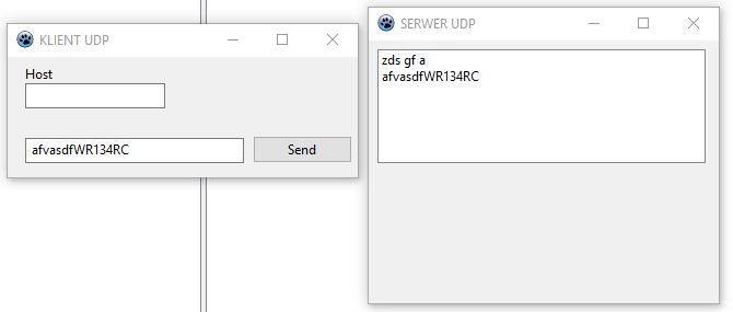

    I wrote two applications: CLIENT and SERVER (UDP), the client sends a message and the server receives it and it works. Both have BroadcastEnabled on True, ports on 12000, but on the server Binding I set it to 0.0.0.0:12000. what is this parameter? When I removed this it also works
    So it doesn't matter what the address is, but it matters what the port is, is that right? And I don't understand now how this relates to my local network? How am I supposed to receive data from the ESP if its address is 192.168.1.109 and port 80? Is it enough if I set the port to 80 instead of 12000 in my application?
    kind regards - Maciej
    I have included the ability to change ports in both applications and it works, as the ports are the same, data is received

    Binding I set to 0.0.0.0:12000. what is this parameter? As I removed it also works
    I don't think you need to set this, unless the computer is on two networks at the same time (two network cards) then you have to somehow determine which one you are referring to by entering the IP that the computer has on the specifically selected network.
    mgrems wrote:
    So it doesn't matter what the address is, but it matters what the port is, right? And I don't understand now how this relates to my local network? How am I supposed to receive data from the ESP if its address is 192.168.1.109 and port 80? Is it enough if I set the port to 80 instead of 12000 in my application?
    In the application you enter an arbitrary port number of your choice for this communication.
    And that port 80 in ESP is the web server port, which is of absolutely no interest to you here (you can of course use it in parallel for some purpose but it has nothing to do with UDP transmission). What is important (somewhat) is the IP address of the ESP.
    To send a UDP packet you only need to know the IP of the recipient and the port number on which it is listening. The UDP port number on the ESP from which the packet will be sent is not important. It will be assigned automatically.
    In your case, you could use the specific IP of the recipient's computer, but that's out of the question for obvious reasons, so you'll use the broadcast address, which for this network where your ESP is now is 192.168.1.255.
    You could also try something even more universal and give it a 255.255.255.255 address, but I'm not 100% sure that will work, although there's something on my network that sends UDP packets to that address and Lazarus picks it up.

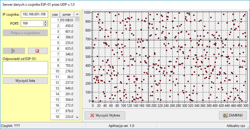

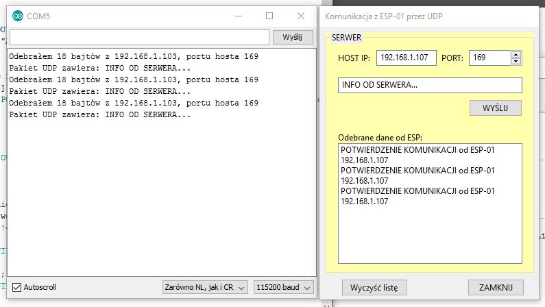

    It took me a while, but I managed. Below is the result of my struggles so far:
    In the end, the ESP-01 is a client with the address 192.168.1.107 (assigned) and port 169 (from me). The Lazarus application runs as a server with IP 192.168.1.103 (assigned).

  • #15 16302915
    rb401
    Posts: 3000
    Help: 750
    Rate: 980
    Board Language: polish
    mgrems wrote:
    When the application started another time it received a different port .... and I don't know anymore ...
    This is quite normal behaviour. The client gets an unused port number from the system for the time it sends a UDP packet. As soon as it sends it, the port is closed and released. And for some reason, when sending again, the client gets a port that was not used last time (usually with a number one higher).
    If you are stubborn, you can "reserve" a port for sending. The UDP server component of Indy, also has a method that sends packets (procedure Send(AHost: string; const APort: Integer; const AData: string); ) and then indeed, all packets sent by this method go out with the port number as set to receive. But I don't think this adds anything practical.
    In your case, with this new concept you only need to listen on arbitrarily determined ports from both sides, and the port number from which the client is currently connecting becomes quite irrelevant.

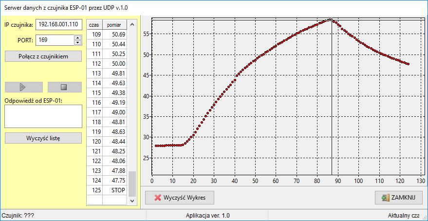

    Welcome after a long break.
    Thanks to your help I have reached a satisfactory stage. Now the cosmetics remain.
    The ESP-01 connects to the wifi, and waits for contact from the application from a computer in the same network. After confirming the communication, the application sends a "start" signal and the ESP starts sending a randomly generated number from the range 0-999 every 1s.
    The application receives the packets and transfers the values to a time chart.
    Now I need to hook up a sensor to the ESP and start sending real measurements. Once I get to the end I will upload the end result.
    Thanks and best regards - Maciej

    mgrems wrote:
    The application sends a "start" signal after communication is confirmed and the ESP starts sending a randomly generated number from the range 0-999 every 1s.
    This looks nice.
    Personally, I would rather test with consecutive numbers to see if any packet didn't arrive. This is, after all, UDP, by definition not guaranteed to arrive or to be error-free in content. Admittedly, some misrepresentation of packet content should be rejected at the wifi layer but a radio, like a radio, can have temporary problems. At least theoretically, as it is difficult for me to estimate what the reliability of the network looks like for example in one room and with ESP having a fairly strong transmitter.
    Alternatively, I would add some numbering to the packets in the target form for control, to at least have an indicator somewhere on the side that everything is ok, that nothing is lost.

  • #28 16379084
    mgrems
    Posts: 61
    welcome after the break
    As far as losing data is concerned, this is not the case. It is true that data is collected every 1 second, but on the other hand it is not strategic data. It is about measuring a certain physical quantity (with a higher resolution than 1 second). If something is lost along the way, the measurement can always be repeated.
    For today, I plugged in a thermometer and while logging the data for about half an hour nothing got lost. Below is the result of recent struggles:
    Now fine-tuning and operation.
    Thanks to everyone for their constructive comments. I consider the topic to be completed. Greetings
