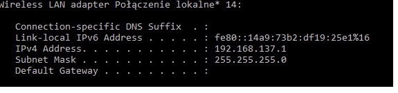

    krzbor wrote:
    the chips will not be found if they have changed IP
    I understand that they will not be found, but I am surprised that even though I have a well written program, the server after correct programming does not want to start
    and here a screen shot of ipconfig
    ESP8266 - How to send temperature data from one module to another via UDP?
  • #18 16499833
    krzbor
    Posts: 1755
    Help: 41
    Rate: 1063
    If your subnet is 192.168.137.x then why are you configuring:
    IPAddress ip(192, 168, 0, 50);
    IPAddress gateway(192, 168, 0, 1);
    IPAddress subnet(255, 255, 255, 0)
    so in the 192.168.0.x subnet?
    actually i didn't pay attention to it i thought it doesn't matter i'll change it right away and try to program it again
