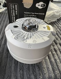

    This device is the kind with a switch to run it in “wifi” mode or as a dumb device - various buttons work in this mode yet not via WiFi (and wouldn’t work in the Tuya software either) so whilst it’s similar in principle to the more common Immver projector in operation it’s quite different - the motor only moves the led nebular effect and cannot be turned off independently nor can the laser in at least in wifi mode.
    This is what the device looks like. I could buy another type as they are pocket change but I’d like to fix this if I can get to the bottom of the issues. I’d even thought about swapping in a more traditional esp but the layout of the board connections won’t allow this easily.

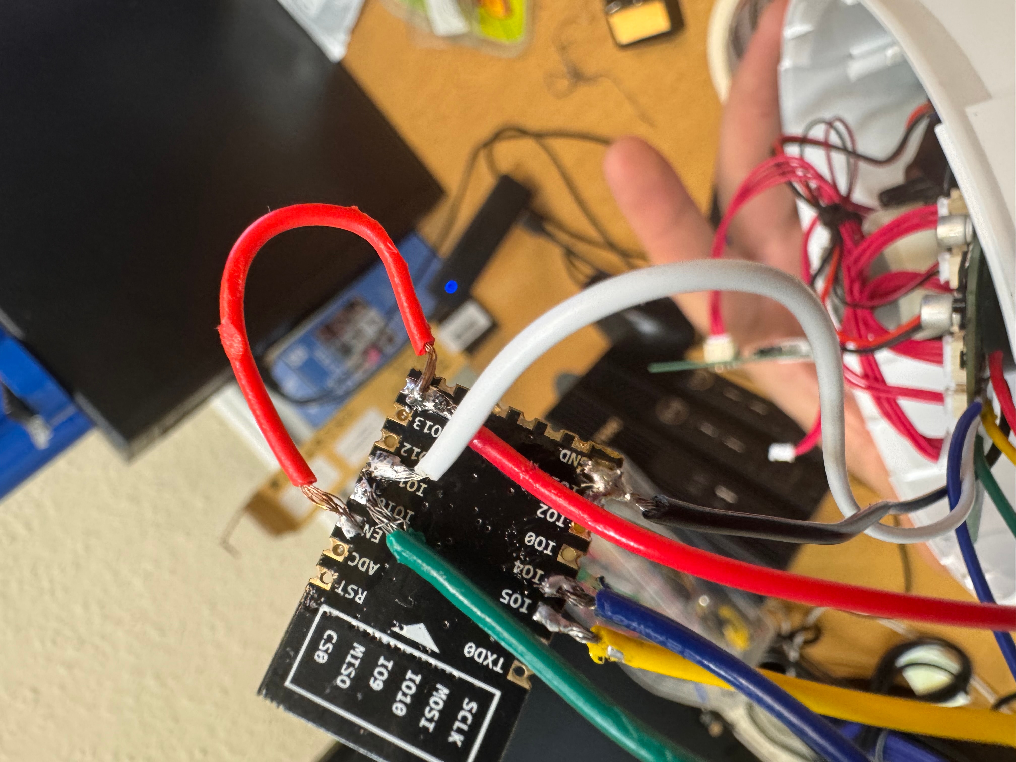

  • #7 21770419
    gandi69
    Posts: 99
    I’ve changed the chip now to a Tasmota’d esp12f from the usual wb2l with a bit of hacky wiring. Let’s see if this cures it.

  • #8 21771685
    gandi69
    Posts: 99
    It looks like this is something hard wired into the board that the esp connects to. 4 hours and it turns off.
