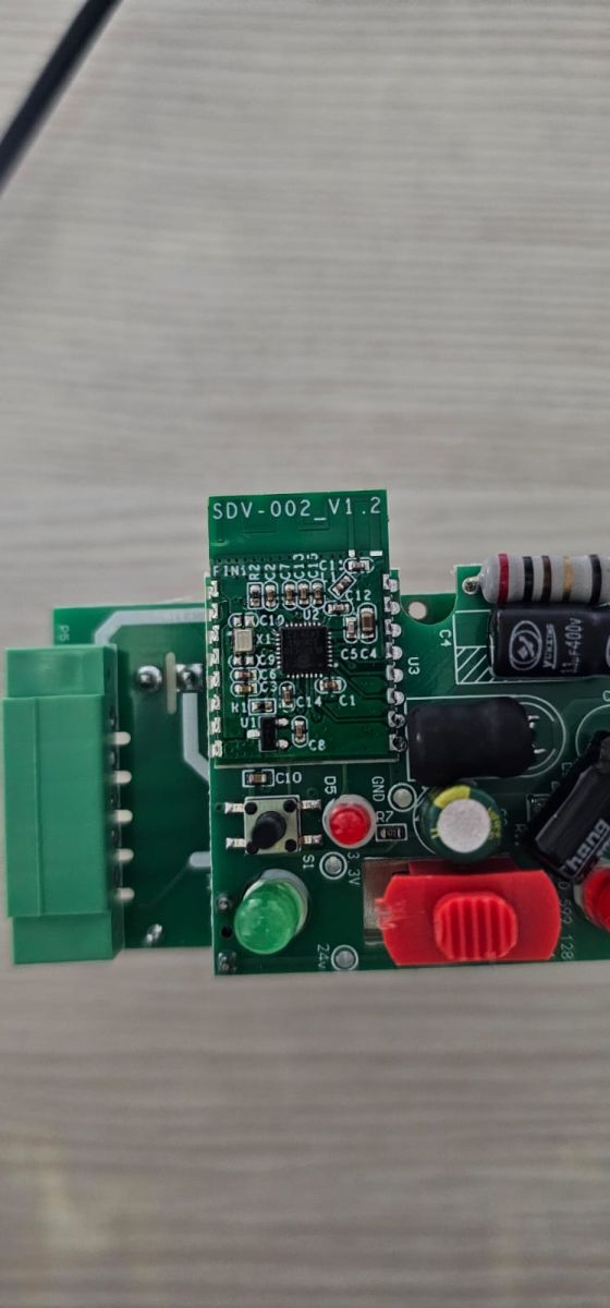

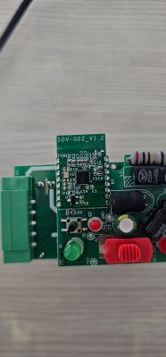

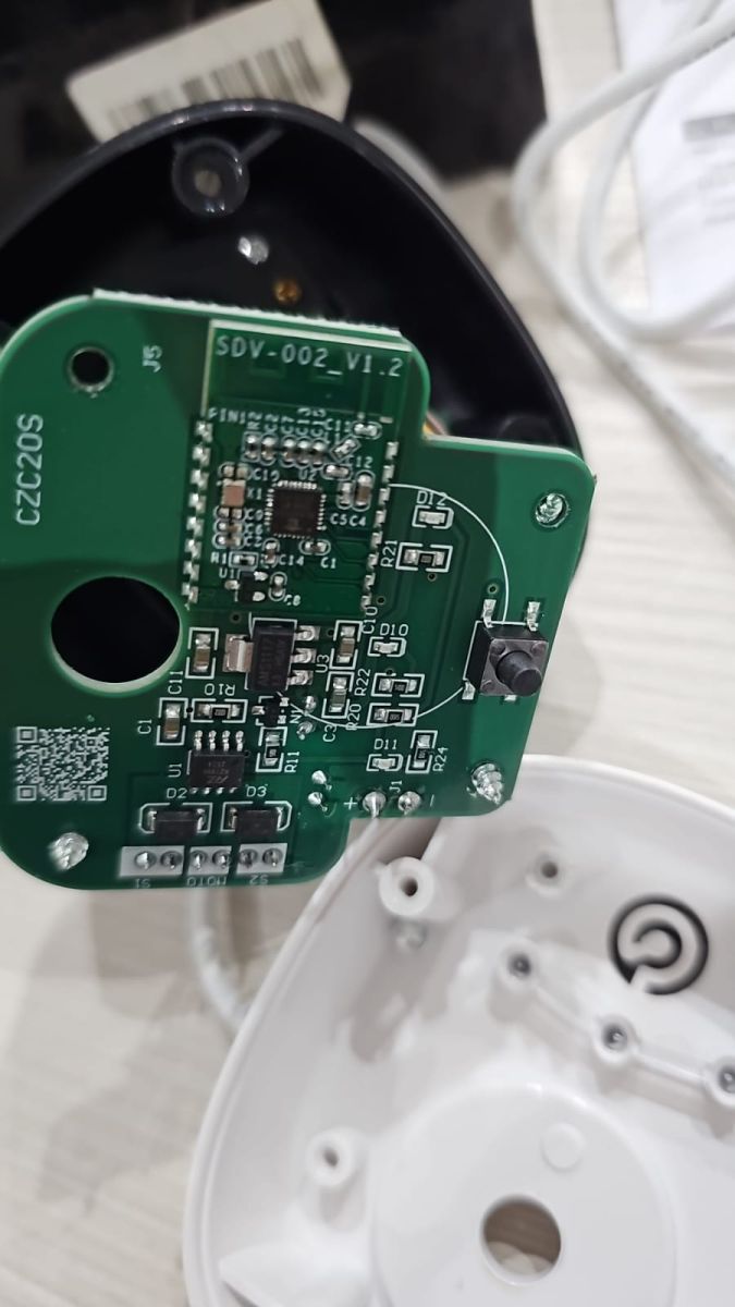

    Name: Water Gas Shutoff Automated Ball Valve
    Url: https://www.aliexpress.com/item/1005007161169914.html
    Module: BL602 Module SDV-002_V1.2
    Photos:
    Flashing BL602 SDV-002_V1.2 Water Gas Shutoff Valve via BouffaloLabDevCube

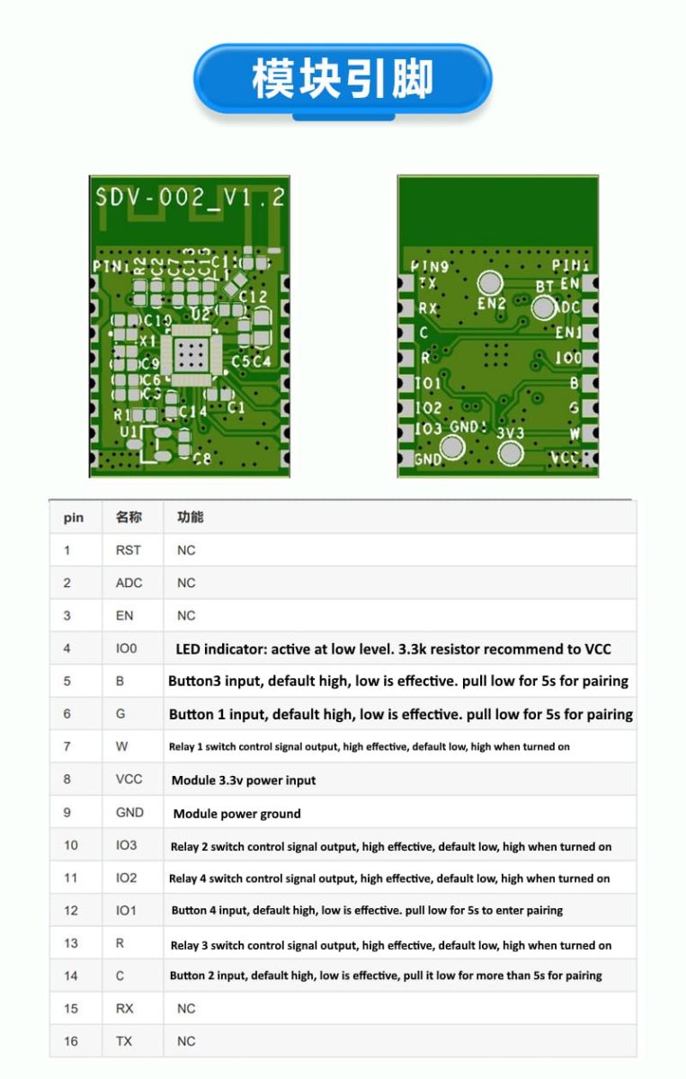

    Connection: Connecting a wire to R2 and connecting it to VCC during power on is enough to put the module in BOOT mode as described here. TX, RX, VCC and GND pins are as described
    SDV-002_V1.2 PCBs with pinout diagram and function descriptions in table.

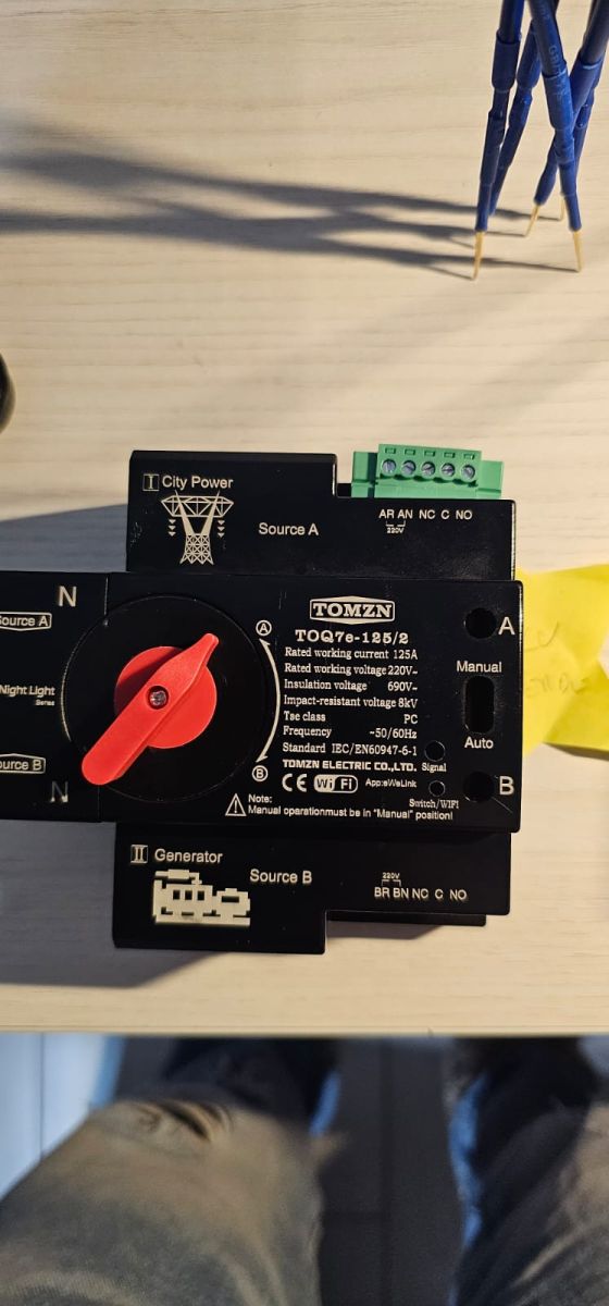

    Template:
    "vendor": "TOMZN",
    "bDetailed": "1",
    "name": "WIFI Smart ATS",
    "model": "TOQ7E-125/4 220V",
    "chip": "BL602",
    "board": "SDV-002_V1.2",
    "keywords": [
    "switch",
    "relay",
    "button",
    "bl602"
    "pins": {
    "2": "Rel;1",
    "14": "Btn;1",
    "12": "LED;1"

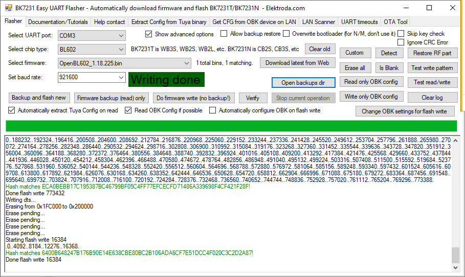

  • #5 21772611
    Posts: 5220
    Help: 449
    Rate: 918
    ideal conditions testing with an ai-wb2-32s but I can flash OK at 921600 and it boots.
    Screenshot of BK7231 Easy UART Flasher with message “Writing done”

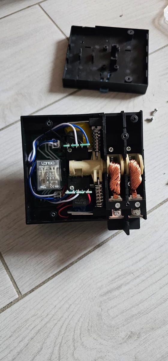

  • #6 21775504
    lamero345
    Posts: 33
    Other TOMZN WiFi Smart ATS BL602 SDV-002_V1.2 flashed with BK7231Flasher. This is the dump :)
    • readResult_BL602_2025-09-12-07-17-25.bin (2 MB) You must be logged in to download this attachment.

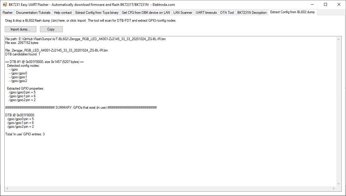

  • DTB scanner extracts GPIO pins from firmware dumps

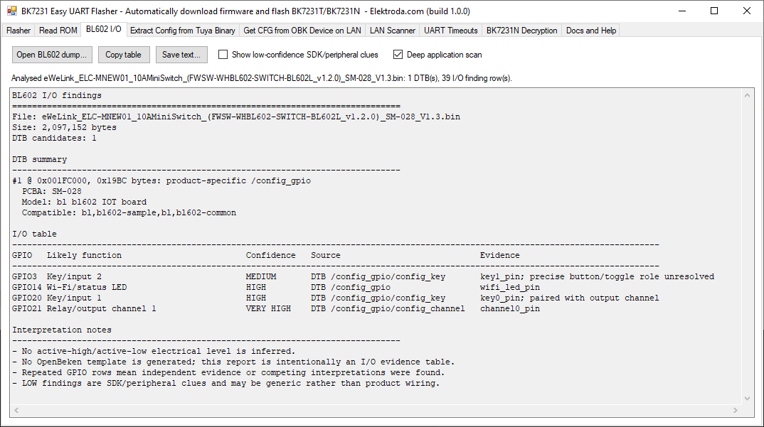

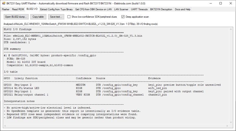

    #9 21787528
    Posts: 5220
    Help: 449
    Rate: 918

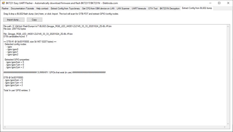

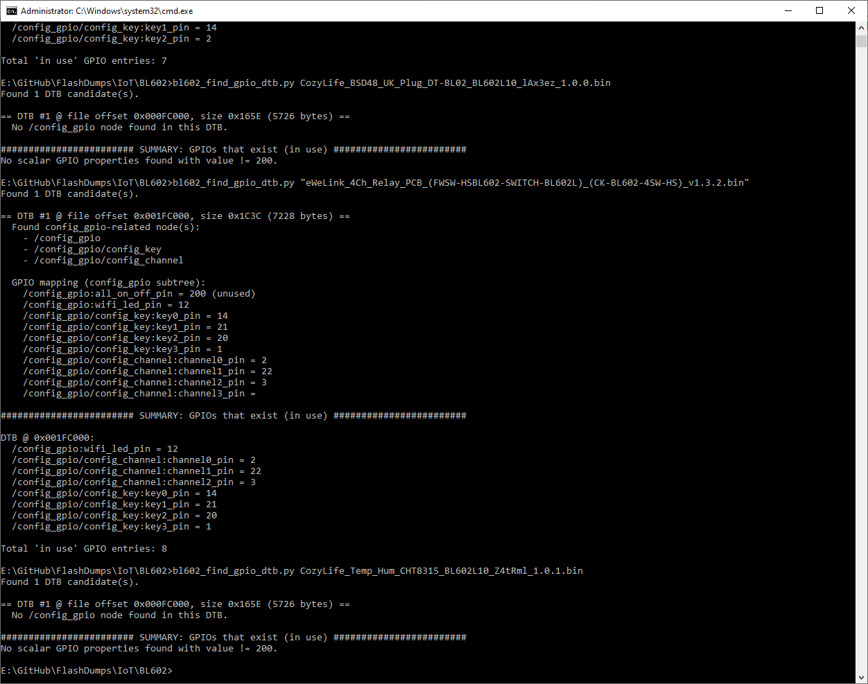

    GPT is going on about it being stored as a flattened device tree (DTB).
    Screenshot of CMD terminal showing GPIO analysis from a Python script.
    This script seems OK at getting GPIOs for some dumps, though CozyLife seems different
    Code: Python
    This could totally be a new BL602 config extractor tab in EF or something. A text window with json IO config translation for pasting into the web app import
    Added after 7 [minutes]:
    oh lol
    Added after 4 [hours] 37 [minutes]:
    fiddling
    Application window showing extracted GPIO results from BL602 .bin file
  • #10 21788392
    Posts: 14770
    Rate: 12913
    I am confused - is it reliable? Or is it giving false, non-existent pins?
    How did LLM know to use Flattened Devicetree (DTB) Format?
  • Basic Python FDT parser for BL602 firmware blobs
    #11 21788797
    Posts: 5220
    Help: 449
    Rate: 918
    OK, so it's just early trying things.
    I've taken a step back to work on a more basic script.
    Code: Python
    That dump is from this device with this template
    so we see the 3 pins are clearly retrievable from the dump.
    Another one:
    which kinda matches this https://www.elektroda.com/rtvforum/topic4009765.html#20795350
    Added after 25 [minutes]:
    hmm. this next script should print more (attached as zip)
    OBK config for this bulb is
    "3": "PWM;5",
    "14": "PWM;1",
    "20": "PWM;2",
    "21": "PWM;3",
    "22": "PWM;4"
    not sure how to translate what's printed out into a working template in this case
    • bl602_find_gpio_dtb.zip (2.25 KB) You must be logged in to download this attachment.
  • #12 21944012
    Posts: 5220
    Help: 449
    Rate: 918
    still fiddling
  • #13 21944146
    Posts: 14770
    Rate: 12913
    Seems useful and acceptable to merge - just how reliable is that? One could suggest merging with Tuya extract - and rename to Extract Config - but I realize how different it is, so maybe merging would not be the best idea.
  • BL602 config helper cross-references dumps and devices.json
    #14 21944447
    Posts: 5220
    Help: 449
    Rate: 918
    ah. it's a WIP. I'm tuning it further. it's managing to either get the whole template or at least some of the IOs for devices we know about already. Or sometimes nothing. It seems eWeLink, CozyLife, Zengge etc all have different way of doing things.
    I'm testing with all BL602 dumps and cross-referencing with devices.json.
    It's not as consistent as the Tuya KV way. I think it's definitely worth something, but more as a helper.
    I thought about integration with the Tuya config tab, but I dunno, it didn't seem like the right fit. Also, I'd love to see the IO mappings stuff refactored, so there was the thought of that changing in the back of my mind anyway
