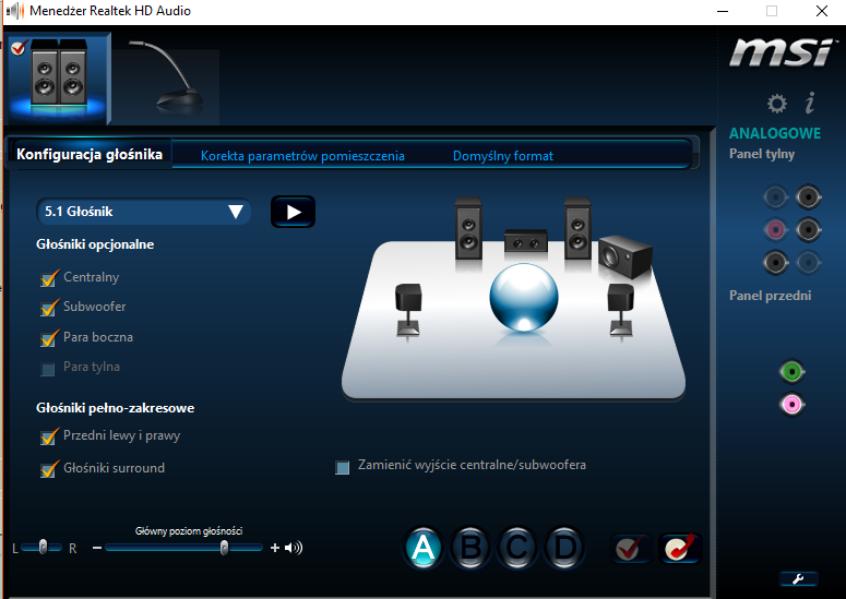

    Hello, I have Logitech 5.1 speakers and I want to connect them to a computer with an MSI Gaming 5 motherboard, but I have 7.1 inputs there, can someone tell me how to do it? I have signed these outputs somehow RS-Out, etc.

    Launch the Realtek control panel, assign the appropriate sockets to the appropriate pairs of speakers.
    and as if you could brighter: p

    Connect to the rear sockets:
    Lout - front speakers
    RS - rear speakers
    CS - center speaker and subwoofer
    Then, in the Realtek panel, by clicking the icons of the appropriate outputs, assign them the desired functions.

    I have 3 cable colors, green, red and black, which one is which?

    Green - probably obvious that the front speakers, the others by trial and error, you can replace the plugs at most (if necessary, connect one of them to the phone, turn on the music and listen to what is playing).

    gites, everything flies thanks !!!
