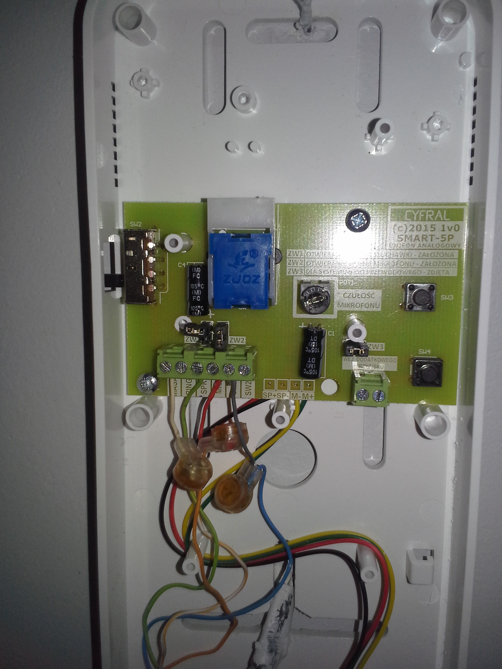

    can anyone help me connect this uniphone?
    I present the old connection below - I do not know what model it is, at least it had the inscription "GM-WO" Connecting Digital Smart 5P Uniphone: Microphone and Loudspeaker Work, Calls Don't
    I connected the new digital smart 5p uniphone as follows: the microphone, loudspeaker, opening, but calling does not work
    I am asking for tips
    The old model worked without any problems, so connecting the cables was done on the basis of trial and error, looking for the weight of the loudspeaker, etc ...

    How is the call supposed to work if the RING terminal is free for you?
    Put what is on SW1 into the RING.
    Jumpers set as for 4-wire installation with opening on the microphone line (i.e. as you have now).

    of course I tried such a connection as well as opening the loudspeaker line
    I read somewhere that 4 cables do not mean a 4-wire installation and you need to make some bridges, etc.

    After all, you are ok except for this free "RING" terminal. Plug in as I wrote, it must work. The opening is on the microphone line, because if it was on the handset line, there would be an electrolytic capacitor added to the old one and it is not in the photo.
    Ps. Why did you leave behind those old "chips". There was an opportunity to get rid of them. Is the cable too short?

    I succeeded, I shortened the cables and got rid of the extensions - maybe the cables were damaged somewhere
