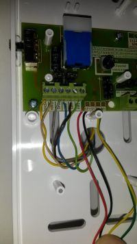

    Hello. I am asking for help regarding the installation of an intercom / digital uniphone. After changing from the old model, the intercom does not make a sound when ringing - there is only a soft pop in the receiver (at maximum volume)
    Connection of the old and new intercom No Call Sound on Smart 5P Digits Intercom: Installation & Receiver Volume Issues No Call Sound on Smart 5P Digits Intercom: Installation & Receiver Volume Issues

    I don't know if he has. This is a picture of the entire uniphone
    • No Call Sound on Smart 5P Digits Intercom: Installation & Receiver Volume Issues 20170713_230322.jpg (1.16 MB) You must be logged in to download this attachment.

    R-MIK wrote:
    Does the uniphone have a built-in generator?
    It seems to me that the question was whether the old uniphone had a built-in / additional generator.
    Author, type "call generator" in the forum search engine and it will get bright.
    best regards
    Added 5V piezo generator to uniphone PCB

    R-MIK wrote:
    Uniphones available in brands are cheap and do not have a generator, which is most often needed in 5 + 1 installations
    My colleague seems to remember the "good old days". The truth is that uniphones sold in supermarkets and those in specialized stores are the same, and in these and those there is usually no need to look for a generator. The difference is that in a specialized store such a generator can be purchased and the seller will usually be able to tell us how to install "this". Generators disappeared from uniphones, if only because they appeared in switchboards. Probably, in the case of multi-family installations, this and its economic justification ...
    The same story goes for opening. In the past, the power supply to the bolt was looped through uniphones. Now, the new power supplies have a system triggered by ground (most often a relay) feeding on the tap and the sixth core in the uniphone is not used.

    karokarolajna123
    Thanks for the answers. The old intercom did not have a generator, only a built-in buzzer.

    IGS
    Level 22  
    Posts: 456
    Help: 44
    Rate: 61
    so add a separate so-called "buzzer" to the new "buzzer", piezo with a generator and give it
    + to call a uniphone
    - to the mass of the uniphone
    this has the downsides, but as a workaround it is a solution
