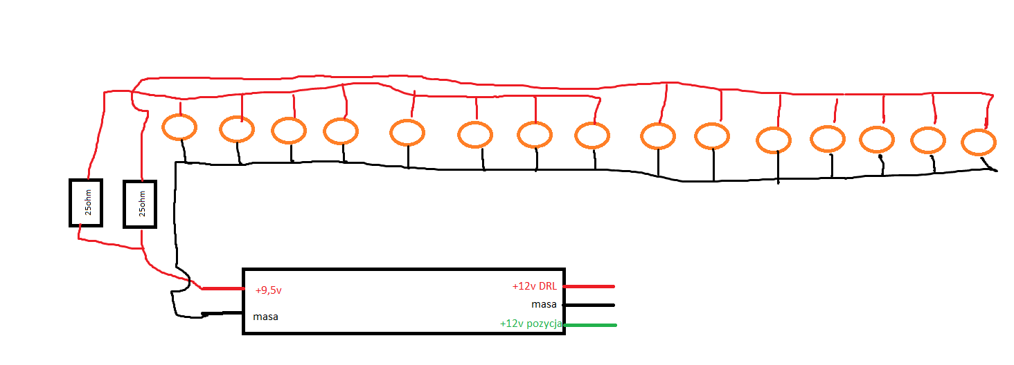

    If I did not fuck anything, the diagram should be good.
    As I wrote earlier, 2 wires come out of the inverter.
    LEDs are 15 and are divided into 2 sections. The first has 8, the second is 7.
    At the beginning of the bar there are 2 resistors with the value of 25ohm
    I learned that the output voltage should be 9-9.5V.
    I do not have, and even if I had a working lamp, I would not want to break it down to test the efficient converter.
    I have experimentally connected a small 12V battery to these LEDs. The consumption was 4.5A, which is over 50W. Of course, I gave it for 2-3 seconds. They shone very brightly and quickly became warm - obvious.
    So the current and voltage regulator is a known duty.
    • KIA Cee'd LED DRL & Position Lamp Failure: Diagnose Burnt Inverter, Voltage Measurement Issues schemat.png (26.83 KB) You must be logged in to download this attachment.

    Okay, I was able to buy a compact lamp from a well-known portal for the buck.
    The converter was, for good, whole. It has other elements but it should not affect the final values.
    At "idling", i.e. without load, the final output voltage is practically coincident with the input voltage. This is both after + 12V for green or red power cord (DRL and position).
    This probably means that there is no voltage regulator there, only the current regulator will be used.
    Now measurements (my multimeter is not accurate when measuring current):
    - green power supply (DRL), output voltage 6.58V, current 0.92A
    - red supply (position), output voltage 2.755V, current 0.06A
    Does anyone design such tiles with 2/3 potentiometers?
    PS: The graph above is out of date with an output voltage of 9.5V, which was estimated
