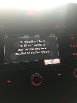

  • #68 17362732
    rodis82
    Hello everyone ?
    And I have such a problem: after inserting the card into the VW car, it will make 315 "cd card error"
    I put in the maps, changed the CID, blocked it with a password, and yet such circuses. What could be wrong? Why card error?
  • #69 17362845
    Bimer535
    Level 21  
    Posts: 454
    Help: 33
    Rate: 111
    cid after the change you checked and you are sure it is ok? If so, download maps from elsewhere.
  • #70 17362861
    kamiltnt

    rodis82
    I checked CID after the change, everything was ok, the reader is rather ok because the music is flashing. Yes, I suspected that maybe it's the maps' fault? Do you have a proven source somewhere?
    In the manual, the CID is given to change with the ending 400 give, but then each is given a different one? So it has to be?
    One more thing, after downloading new maps, do I have to carry out the entire procedure from the beginning or just replace the file on the card and how does it look when the card has been blocked?
