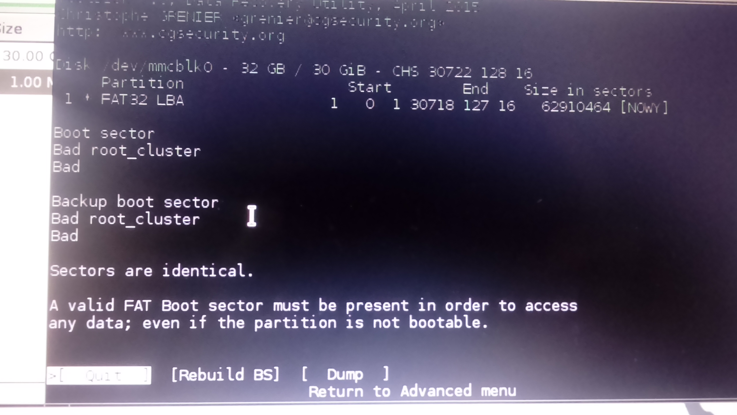

    USB drive info will not unpublish the card when it is in the built-in adapter.
    Photo from gparted during scan:
    Micro SD card 32GB, can not be formatted. Repair of the bootsector.
    Why not screen? Because the scan will end in 2-3h.
  • #12 16587502
    pidar
    Posts: 11363
    Help: 1569
    Rate: 3591
    Nonsense.
    It will not recognize if the card will be broken (eg not detected by Windows).

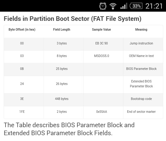

    Added after 3 [minutes]:
    Will I be able to manually add these parameters? If so, what program to do it and how? Micro SD card 32GB, can not be formatted. Repair of the bootsector.

    Can I save anything on this card now? Why do you want to repair the boot sector, or rather write it manually, if the card was ok, then the whole partition would automatically boot the system, including the correct boot sector? As you will find the card correctly and will read it, you can enter any partition there, you can enter the size of the partition you want.

    For what ? And this card is not going to be formatted so that I can not use it properly. DMDE did not manage to insert the partition. Although GPARTED inserted the fat32 partition, it is not fully functional.
