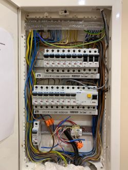

    I have a short question for more electricians than I am. Some time ago I became the owner of a photovoltaic installation. On Saturday, an electrician was at my place (for a completely different reason than PV) and he told me that the PV installation according to him was connected to the wrong fuse. It sowed a seed of doubt in me so I decided to ask in the forum. In the photo, the PV cable goes "from the top."

    The picture cannot be enlarged.
    The protection is three-phase and so is the inverter?
  • #3 18192774
    literatos
    Posts: 13
    I added the picture again. Maybe now it will grow without a problem. The protection is three-phase and the inverter is three-phase

    An inverter with a power of 4.4, and regarding the protection on the AC side, I am throwing the next picture :-) It will be much easier (based on my news)

    The value of the fuse to which this cable from the PV installation is connected is not visible in the first photo.

    Does your RCD breakout?
    are the inverter and PV system grounded?
    I see that the cable from the inverter is 4x4mm2
    the yellow-green wire with the blue PEN ending is connected correctly as long as it is a PEN
    while L1 L2 L3 is connected to the residual current device
    we will ask for photos of the other cameras at inverters with open boxes

    You can see that the inverter circuit has been connected to the triple B16 together with another circuit, probably some gn. 3-phase or an electric kitchen due to lack of space (there are only two free), while the inverter protection in this new switchgear is C16, and at 4,4kW 10 would be enough and it doesn't make sense because earlier B and finally C
    Added after 3 [minutes]:
    Two green-green PV cable a bit interesting? and I don't see blue

    probably the second yellow-green is PE and the yellow-green with a blue shirt is N
    if it is, it is a wrong connection because it is connected to PEN and not to N

    The fuse is 3-phase 16A. An induction and an oven are connected to it
    while L1 L2 L3 is connected to a residual current circuit breaker, we will ask for photos of other cameras at inverters with open boxes
    The differential does not strike, but the installer said that if it strikes, then the inverter will flow to another place. Yellow-green with a blue "patch" is probably N (if there are 4 wires, one must go N), while the other yellow-green is a separate wire next to the main one, so it is rather an earth electrode.
    There is only one box under the inverter on the AC side, the photo of which is above, and on the DC side there is another box, the photo of which is below

    I am not an electrician, but for my peasant reason, as a PV inverter is connected to a differential to the meter, during the operation of the PV, when the current leakage occurs, the differential may not work.

    There is no protection for the DC panels
    in case of a short circuit on the DC PV line, a fire will probably result

    In my opinion, there are no fuses between the PV and the PV protection, which you showed in the 3rd picture, in the event of the protection being triggered, the panels will be short-circuited.

    And in fact, you will not find that the DC protection must be (although it may be useful), it is impossible to select and protect one chain when the short-circuit current is comparable to the rated current of the panel, only when the chains work in parallel, such fuses make any sense, although what short-circuit , where? since these protections are not mounted on the panels but on the inverter.
    As for the AC, it should not be connected together with another circuit, as there is no space for three additional devices, it is either replace or add an additional switchboard or lay a wire that meets the requirements of earlier protection, in this case probably pre-meter, which is probably 25A, so a wire with a cross-section 6mm2 and connect after off. Main
