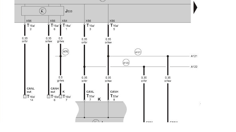

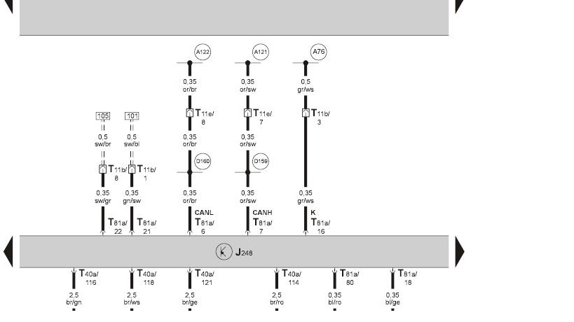

    Tomorrow I will send a k-line scheme to ECU
    you can connect directly to the ECU

    Skoda Fabia 1 BNM - Location of the crankshaft position sensor. Skoda Fabia 1 BNM - Location of the crankshaft position sensor.
    Connect the K-line from the ECU-81a16pin directly to the 7 pin diagnostics and read the error codes

    Ok. Now, do I understand correctly? I am taking my cube off by ecu and I am pulling out 81a. I hook up a new cable. I do the same with obd, lead to the 7 pin cable from 81a. The rest stays the same. At the end I connect my computer.
    Added after 54 [minutes]:
    Could you specify which wire 81a from the plug-in side for the 1.4 TDI?
    Because from what I know is not described there like on obd.
