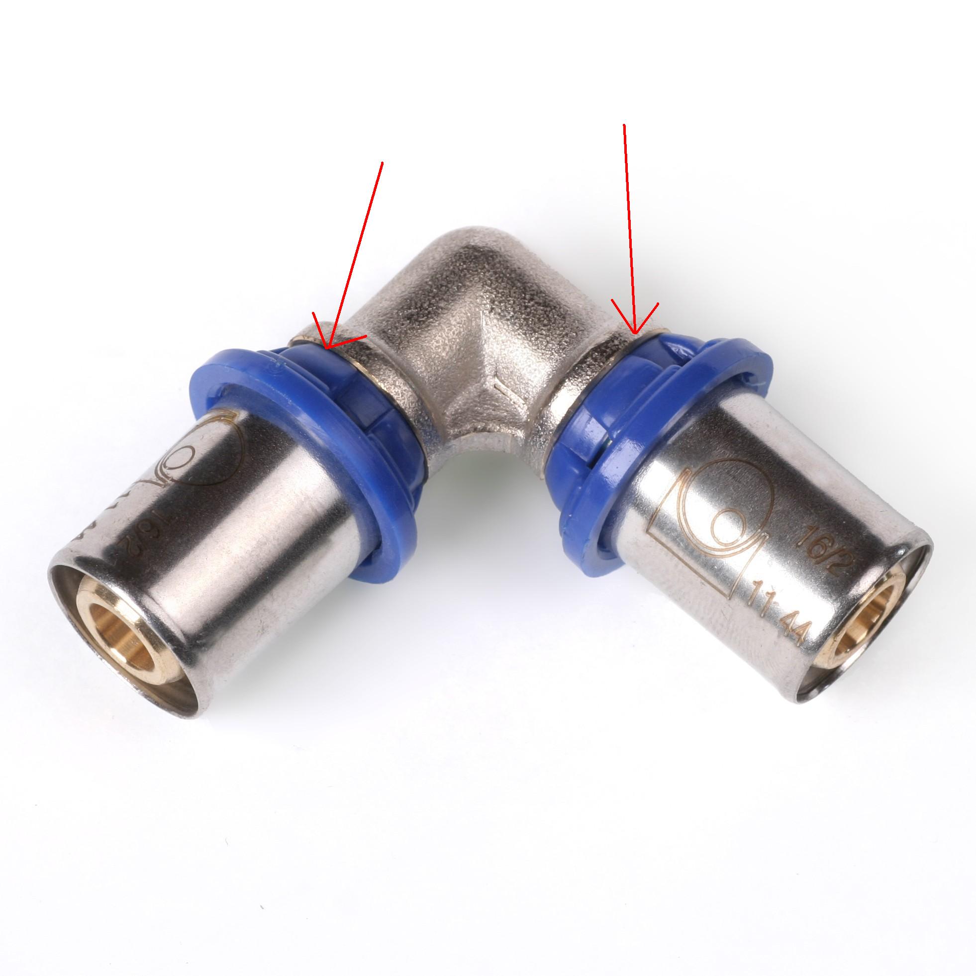

Crimp Connection PEX-ALU-PEX: Connector Rotation After Clamping - Is It Normal?

    Yes, the pipe is clamped on the O-rings, which allow you to twirl the pipe. The fact that the fitting rotates does not mean that it can be turned into infinity.
