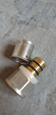

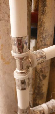

    Hello, I think I have a problem. The case looks like this, I do plumbing in the bathroom and CO. I bought plastic pipes and connectors in castorama. I have a crimper, but no jaws. A friend of the plumber gave me F type jaws. The installations were finished, everything was tight, but I started reading and I felt sick. Apparently, TH jaws should be for the PEX system from Castorama .... What should I do now? The installation has been tight for 3 days, no leaks. I am enclosing photos of fittings, jaws and the clamped fitting.
    PEX Pipe Plumbing: F-Type Jaws Vs TH Jaws for Castorama Connections - Tight, No Leaks? PEX Pipe Plumbing: F-Type Jaws Vs TH Jaws for Castorama Connections - Tight, No Leaks? PEX Pipe Plumbing: F-Type Jaws Vs TH Jaws for Castorama Connections - Tight, No Leaks?
    Added after 1 [hours] 12 [minutes]:
    Can someone comment? I care about time.
    greetings :)

    What are you gonna do?
    Either disassemble and reassemble with appropriate jaws, or cut off the clamped couplings and reattach them, but then you will have to add a large number of muffs. You can also leave and pray that it does not flood the apartment. It is not as bad as it is your own house, but if it is a flat in a block of flats, and there are tenants below, you need to keep a large bag with money to pay any claims, because the Insurance Company will not pay you if you have an insurance policy. In the event of flooding, they will send an expert, and if he finds out that the wrong tool has been used, he will come out HERE and you will not have the slightest chance of winning in court.
    You can also outsource the work to someone who has an idea about it and has the appropriate tools. There are many types of jaws. The most popular types are TH, U and B. But there are also FH, C and many others.
    The systems from Castorama, from what I know, were 2 - for the TH and U or B jaws.
    Now I will not write you exactly, because I do not buy things such as pipes and fittings at Castorama, because the materials must be reliable. Unfortunately, in Castorama, Pex is not of the best quality. Same with the rest of the couplings.
    The only plus is that Castorama borrowed crimping tools.

    Got it, thanks for the answer. But I don't understand one thing, why is everything tight now? And if I do a leakage test, the installation will withstand this test, does the whole installation still have to be dismantled?

    It is tight because they hold o-rings for now. Will it be tight later, no one can guarantee you. Each type of connector must be crimped with a dedicated tool. Such a tool kneads the ring in specific places of a defined shape with a specified force. How can you be sure that the F jaw pressed the pex with the appropriate force to ensure tightness, or that it did not press too hard and did not break the brass connector? The spigot may not have completely broken off yet, but the fracture may continue to develop and reveal itself in a year or two, flooding the entire house.
    Nobody will answer the question whether you can change individual types of jaws, because nobody will consciously risk clenching with a different type of jaw than they should.
    What you will do with it, I do not know, but I would simply do this installation from scratch, using good, branded materials and appropriate tools. Then I would be sure that I minimized the risk.
    On the occasion of your question "But I don't understand one thing, why is everything tight now?"

    Maybe crimp one or more couplings on the pex and cut open to see how tight it is. Or you can clamp with two dedicated jaws and compare. Unless there are a few pieces and there is an approach with a spare tube or the possibility of splitting it, tear it and do it on branded connectors as it should.
    But it is not said that what you did is wrong.

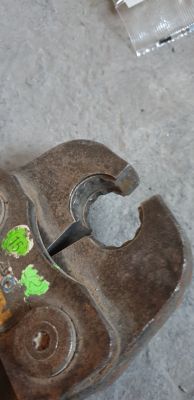

    Are you sure this is an F-profile jaw? The F profile leaves a different trace after tightening:
    http://www.valsir.pl/wp-content/uploads/2017/04/B_SYSTEM-WIELOWARSTWOWY_L02629000_PL.pdf page 16.
    I'm not sure, but it looks to me what you have for a copper pipe profile.
    @ Reksio351 I searched, but it was the F-profile clamps, I was confused by the shape of the clamps imprint on the pipe on the Valsir website. A colleague who lent you the clamps brought or bought them abroad, because none of the well-known manufacturers like; Comap, Geberit, Henco, Herz, Kan, Kisan, Oventrop, Perfexim, Tweetop, Viega, Viessmann, Wavin do not use F-profile clamps for their pipes. Only Sanha and Valsir.
    The guarantee of a tight connection is the use of a connector dedicated to a given pipe and clamping it with clamps with a profile recommended by the manufacturer of the pipe and fittings. The fact that it is not leaking now does not mean that it will not start in a moment. I know of cases of leaks revealed after a few months, which caused me, I do not know, but I know one thing, it is not profitable to leave it as it is. When it starts to fall down one by one, even without sudden spills flooding your neighbor, you will regret it anyway. A gentle leak will get wet, i.e. stains, then fungus and picking every few months and removing these defects, choosing a paint to paint over a piece or forging flagstone and constant muck at home.
    As PLUMPI wrote, Castorama is not a place to buy good, proven materials. It is supposed to be cheap there and they do not care about anything else and that they give a guarantee? You lost it when the pliers touched the coupler. One renovation will consume more money than what you lost on this installation. Cut it out and throw it out, Buy a pipe and fittings, e.g. Wavin, rent a U-profile press and clamps from a rental company, use a calibrator when inserting the fittings and then you will sleep peacefully. Good luck.

    As you have noticed, the connector has o-rings and the clamps knead the sleeve in non-random places. It is developed by the manufacturer and certainly takes into account temperature changes and thus the expansion of the material, aging and loss of elasticity of the rubber from which the o-rings are made, etc. a leak may occur through the outer sleeve at this point. And it would be great if this leak was now all over. When it seeps in the wall, as I wrote earlier.
    I would describe this job like this: it was done anyhow, and it could be at home for sale to the enemy, so that he would have something to do in the near or distant future.
    If the system of compression fittings were not very precise, the manufacturer of presses and clamps would not recommend that the press and clamps be calibrated once a year (let no one write that it is for the sake of earning money on the service) because leaks appear during operation and something had to be done. cause them.

• Castorama Idmar multilayer fittings: U-jaw for Ø16–26 mm, TH-jaw for legacy stock only [Elektroda, Plumpi, post #18236637] • Standard pressure test: 1.5 × working pressure for 30 min; typical 10 bar domestic [EN 806-4]. • Rental press tool + jaws: €20–30 per day, deposit €100–200 [ToolHireEU, 2023]. • Annual press calibration keeps tolerances within ±0.1 mm; missed calibration triples leak risk [Viega, 2022]. • Insurance refusals: 70 % of water-damage claims with non-compliant workmanship denied [Allianz, 2019].
1. Why is my installation tight now even though I used the wrong jaws?
The o-rings seal the water today, but the sleeve may lack the designed compression pattern. Thermal cycling and rubber ageing can open a pathway later, causing leaks months or years on [Elektroda, Plumpi, post #18236731]
2. Will a pressure test guarantee future leak-free service?
No. A 30-minute 10 bar test only shows current integrity. Around 22 % of wrongly crimped joints that pass initial tests still fail within two years [Viega, 2022].
3. Can I re-crimp the same sleeve with the correct jaw?
Manufacturers forbid double pressing; metal work-hardens and may crack. Cut out the joint, add new pipe or a cuff, and crimp a fresh fitting with the right profile [Rehau, 2021].
4. How do I know which jaw profile my Castorama fitting needs?
Check the sleeve colour and part code: Idmar blue sleeve = U, red = TH. Also compare the factory imprint diagram in the catalogue [Elektroda, ewoo, post #18237113]
5. What marks should the correct U-jaw leave?
A U-jaw makes two opposed half-moon dents 180° apart. TH leaves three flattenings, F leaves four shallow flats. Compare under good light [Valsir Manual, p16].

11. What is the cheapest fix if pipes are already tiled in?
Open the smallest possible area, cut out suspect joints, insert new pipe sections with accessible screw unions, then retile. Material cost usually <€50; labour dominates [Author calc, 2024].
13. How-to: verify a crimp in 3 steps
  1. Wipe sleeve clean and inspect dent pattern matches catalogue.
  2. Tug pipe firmly; no movement must occur.
  3. Measure sleeve diameter; it must match spec within ±0.1 mm. Replace if any test fails.
