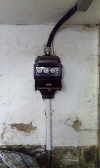

    Aged but common cable connector:
    German Electrical Installation: Single-Family Homes, Flat Cables, Connection Points, Meters

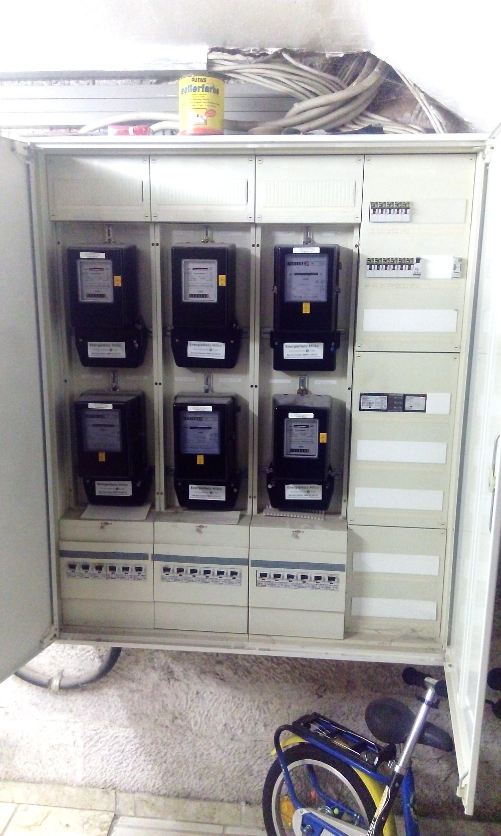

    Counters in a multi-family building:

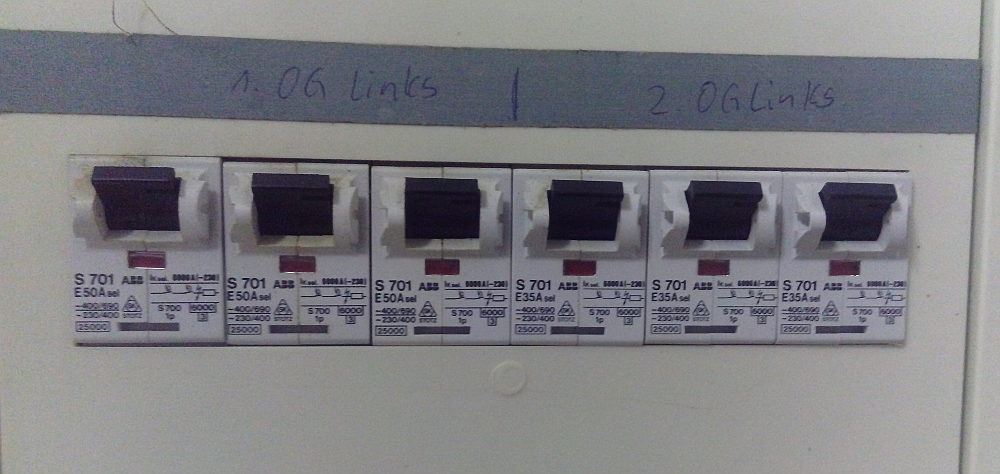

    Selective overcurrent protection (or fuses):
