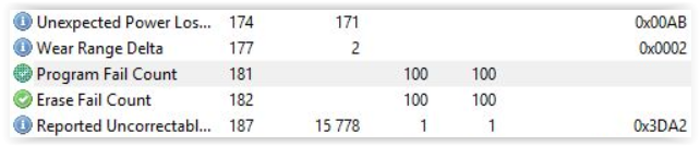

    Kingston 120GB SSD reallocated sector count in HDtune in yellow Kingston SSD problem visible in the picture reallocated sector count in yellow, or disk to replace? Thank you in advance for your answer.

    pruszyniak wrote:
    or replacement disc?
    In the near future, unfortunately, yes.
    Rip important data from it.

    leonov wrote:
    Just why CDI showed nothing? is HD Tune "better"? Or maybe he distorted the result?
    CDI shows exactly the same 8 reallocated sectors.
    Regards

    #6 16331276
    speedy9
    Helpful for users
    Posts: 12035
    Help: 1233
    Rate: 2424
    Not so fast, reallocated sectors in SSD are nothing out of the ordinary. Each SSD has a "spare" and when the controller detects a damaged cell, it simply stops using it. If the amount does not grow rapidly, do not worry. HD tune also misinterprets the SSD parameter. It's correct in Crystal Disk info. This is "Retired Block Count".
    Enter the values for parameters E8 and E9 from CDI.

    leonov wrote:
    I said it wrong, CDI showed good condition?
    Note that HDtune also shows this = = Health Status: OK
    Do you see the difference but the parameter name? After all, the RAW value is identical in both programs.

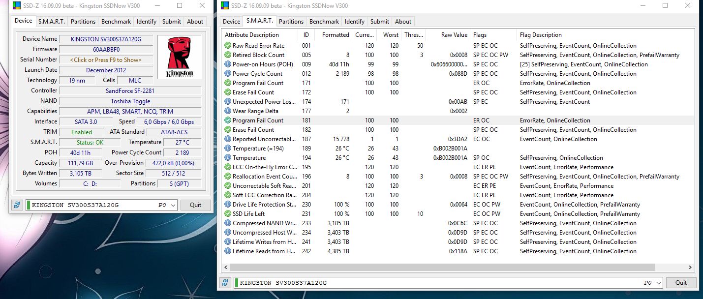

    #8 16331297
    pidar
    Posts: 11363
    Help: 1569
    Rate: 3590
    Let's see if SSD-Z (screenshots from the first three tabs) something more will "tell" us about this disk. :idea:
    http://aezay.dk/aezay/ssdz/
    Retired block count does not indicate imminent SSD failure
    #9 16331305
    speedy9
    Helpful for users
    Posts: 12035
    Help: 1233
    Rate: 2424
    RADU23 wrote:
    Of course, you are right. It's the same thing. This parameter, however, unlike in the case of HDD, does not inform about the approaching end of disk life. The number of spare blocks varies depending on the disk, but even if the value of this parameter would be several hundred, there is no reason to worry.

    #17 16331508
    pidar
    Posts: 11363
    Help: 1569
    Rate: 3590
    pruszyniak wrote:
    Kingston software informs that there is no newer software for this disk
    And I asked before for something completely different. :|
    pidar wrote:
    The firmware on the sticker on this SSD agrees with that read by CDI :?:
    pidar wrote:
    ... whether It was firmware update :?:
  • #18 16331549
    pruszyniak
    Posts: 80
    Rate: 11
    Firmware on disk sticker 521A88F0 aw Crystal 60AABBF0
    I didn't update I bought this disc about 2 years ago. Was used.
    Exactly on the disk sticker is the following data:
    SV300S37A / 120G / 6444689/9904447 - 368.DOOG
    500268723C07982C 1351 521A88F0
    Verify Secure Erase and inspect SSD-Z third tab

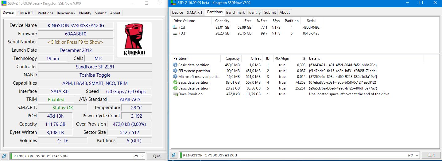

    #19 16331755
    pidar
    Posts: 11363
    Help: 1569
    Rate: 3590
    This too, I will not now be scared when the first bad sectors were actually removed.
    Question, or was made immediately after that purchase Secure Erase :?:
    And you didn't enter the third bookmark from SSD-Z for inspection. :|

    pruszyniak
    Posts: 80
    Rate: 11
    I didn't do secure erase just the format and partitioning
